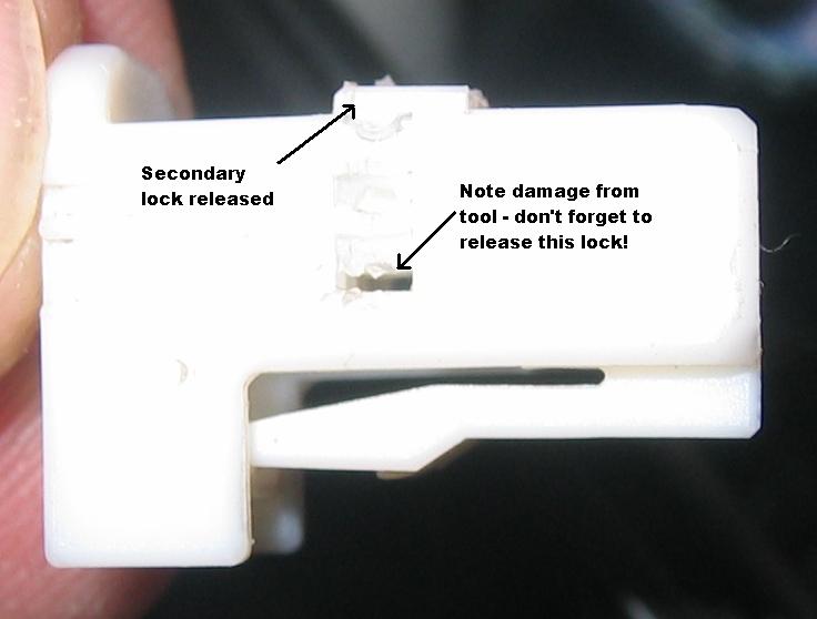

This connector has a secondary lock. I thought it was too small to have one, so I hacked up the connector a bit before I realised my stupidity, and there are some ugly marks on the connector now. Avoid my mistake and release the secondary catch by gently prying the small screwdriver slot in the middle of the secondary catch. It will only raise a little bit - about 2mm as you can see in the picture - but it makes all the difference in the world. AMHIK.
