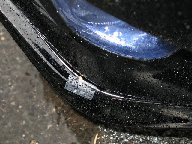

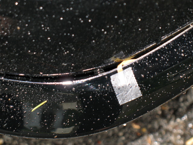

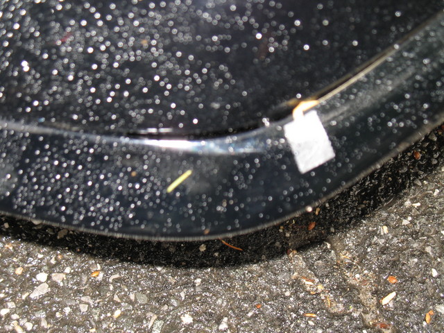

grrr..so my mom and i were installing the front lip to my 250awd..we cut the holes and did everything correctly but for some reason we cannot get the clips to lock in therefore creating a gap on the bend where the adhesive is on both sides..did anyone else have a problem like this when installing the front lip? or am i just "special"?

I got that problem too on my front lip. What I did was using a heat gun and heat it up a lil bit ( becareful you could damage the paint if it's too hot) , Then use a strong force to push it in. Remember to remove the double side tape before you push the front lip in place. You will need a thick glove to avoid burn.

i know tim where have you been?? i'm glad im not the only one that had this problem..which part of the lip did you heat exactly??

yea tim817 said he had the same problem....there is actually already double stick there but theres so much of a gap it doesnt meet the car..i think im gonna have to do what tim did and heat it up to make it work...thanks
