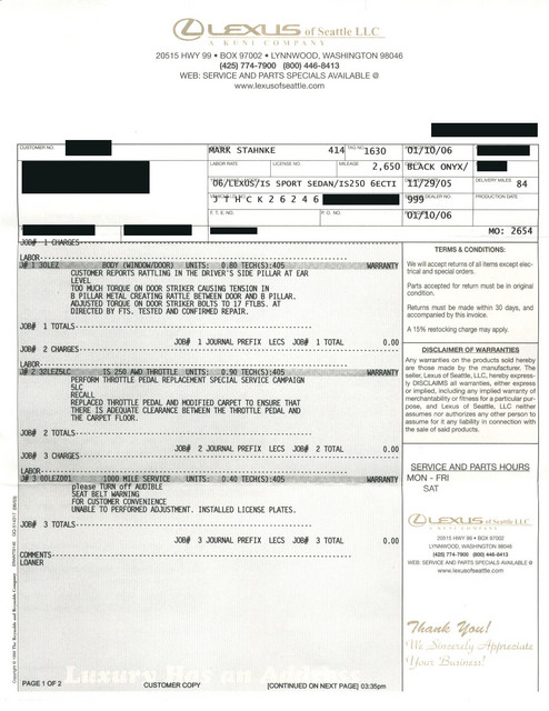

The rattling from inside the B-pillar is due to improper torque on a screw holding the seatbelt assembly. It's a known QA issue at the IS plant in Japan. I have my paperwork somewhere and can scan in exactly what they did if you need it.
Cheers,
Kermee
Could you please scan that paper if you have free time, that would be a great help.

Ahh, this thing is annoying me now, does anyone have the printout from the dealer?

Hartawan,
Sorry it took me so long. Here it is. Click on the image for the larger version of it. Hope it helps.
Cheers,
Kermee

Ah. Thank you so much Kermee! I'm going to drop by lexus when I can.
