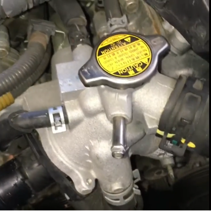

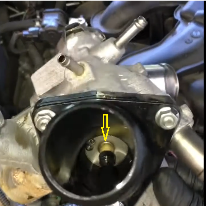

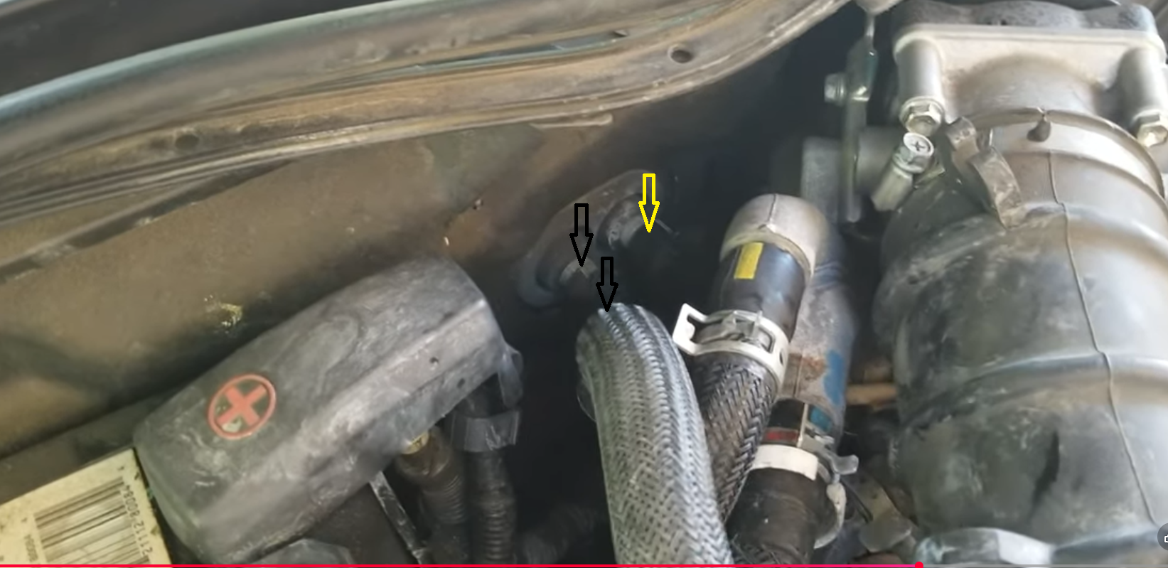

2007 Lexus IS 350 thermostat replacement;
Heater hose location on passenger side firewall near battery (Inlet heater hose referenced by Yellow arrow / Outlet heater hose referenced by Black arrow);
Thermostat housing
Thermostat shown inside housing (referenced by Yellow arrow)
