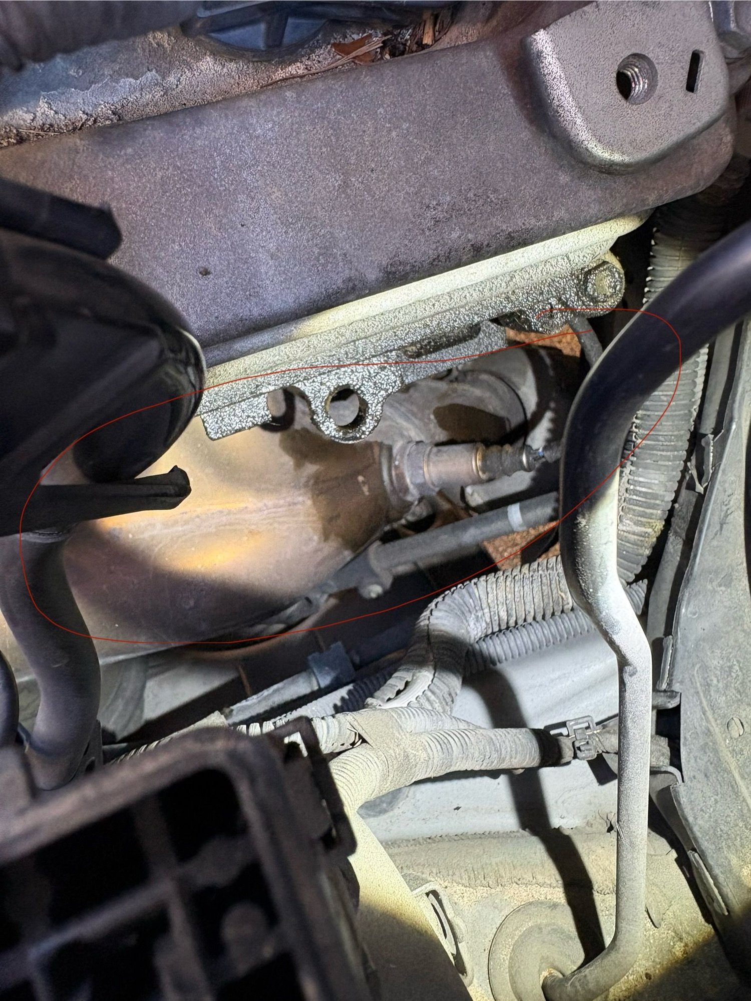

seems to be leaking oil very slowly and dripping on the exhaust manifold and burning there. I cant specify where the leak is coming from though. Any help?
See drip stains falling on manifold, but from where?

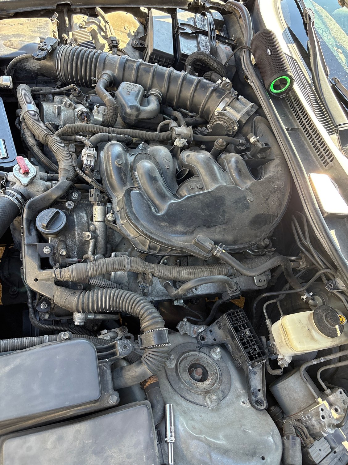

Engine for reference. Drip stains located near back of engine on drivers side.

Looks like your valve covers are leaking. You can see the oil and dirt buildup
