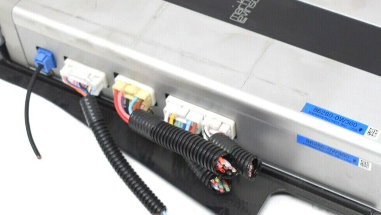

If helpful, located the Mark Levinson AMP (Part# 86280-0W360, 86280-0W490, 86280-0W550 -14 speaker) connector PIN out diagram here; ( I assume it's accurate);
https://pinoutguide.com/Car-Stereo-T...0_pinout.shtml
