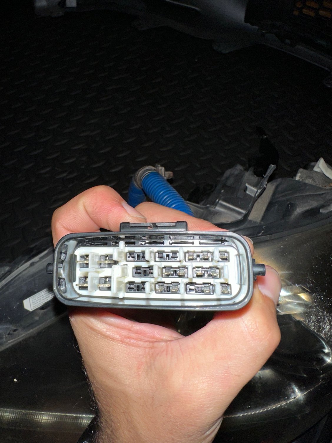

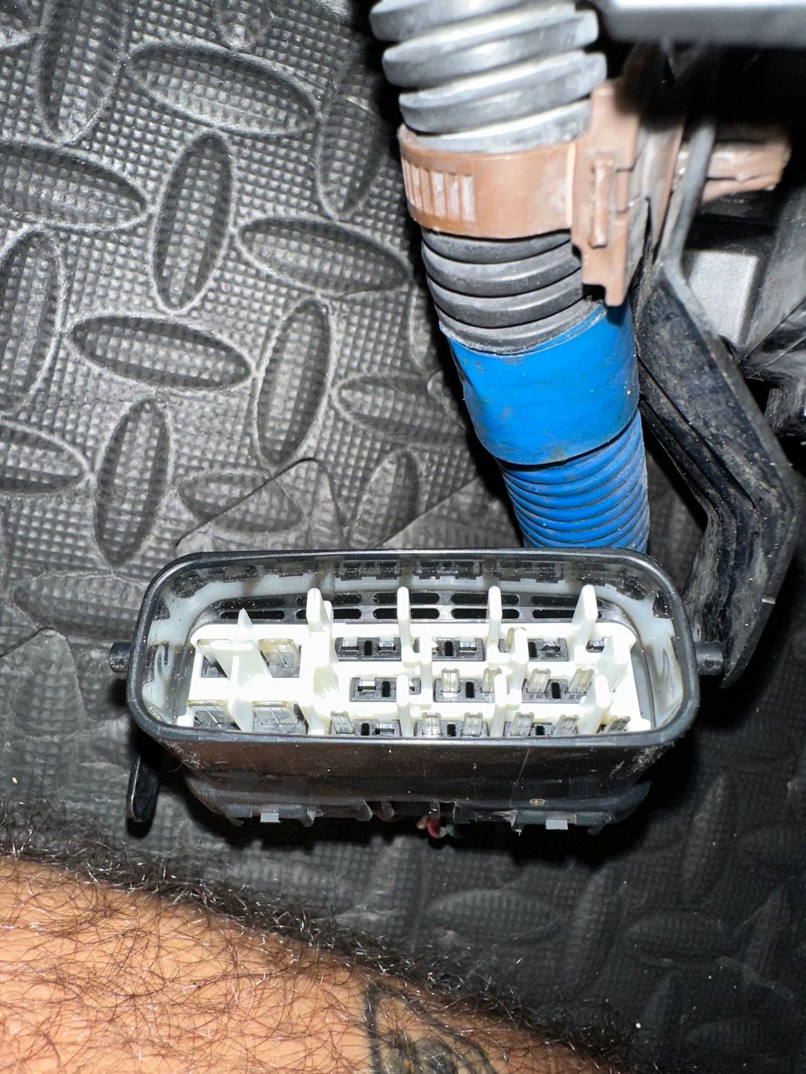

I have a 2012 is250 that I bought a new headlight for. This headlight seems to have a different pin output on the connector than my original headlight. The led strip does not turn on as normal, but turns on once I give the headlights a click or turn on the headlights all the way. Has anyone repinned the headlight connector ? Is there a special tool for this, would not want to mess up the pins to this.
This is the connector to my factory headlight
This is the connector to the headlight I just got
the difference is on two pins that are on the top row but seem to be on the bottom row for the new headlight. Anything helps!

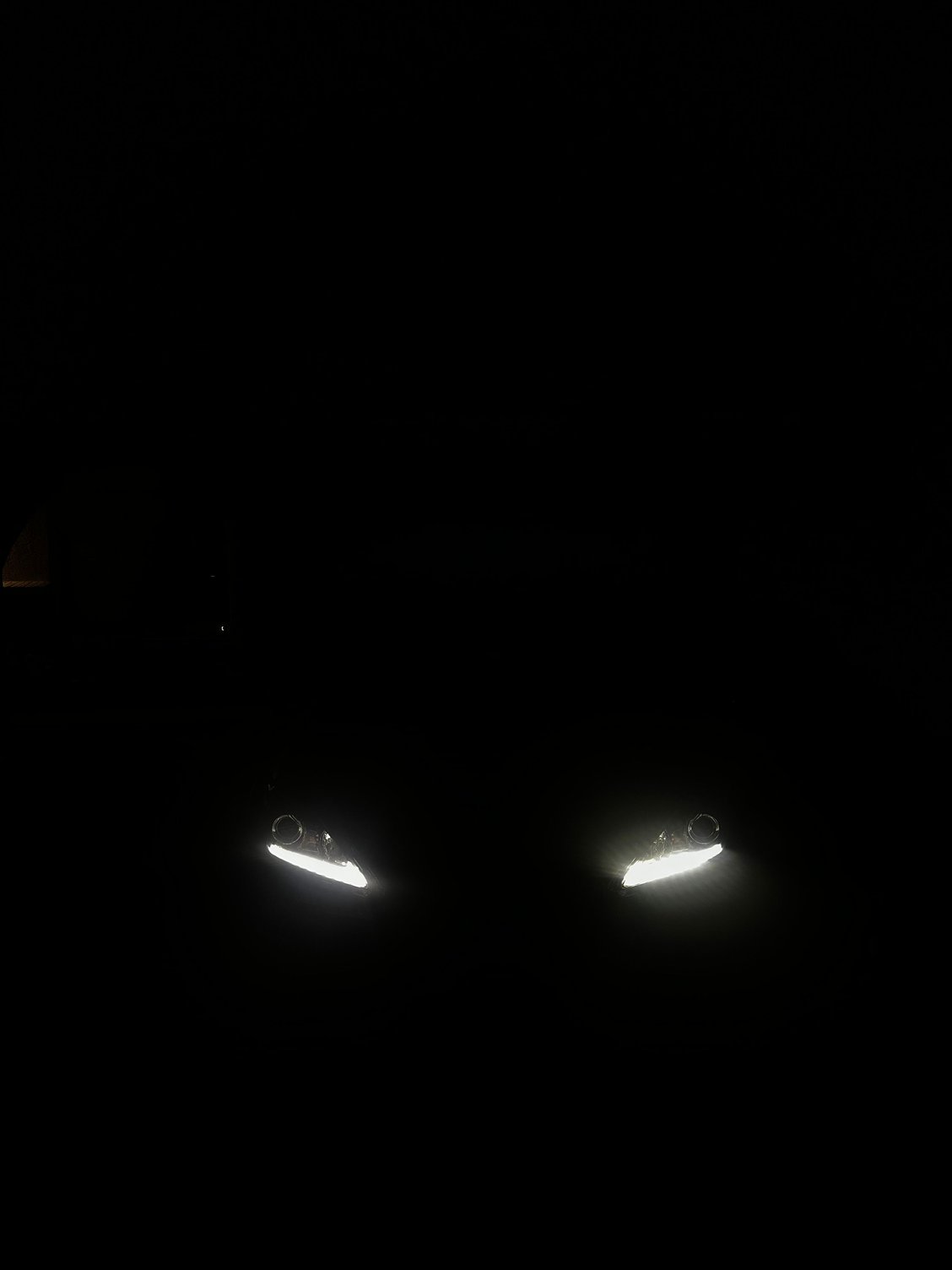

Repinned the connector, all good to go!
