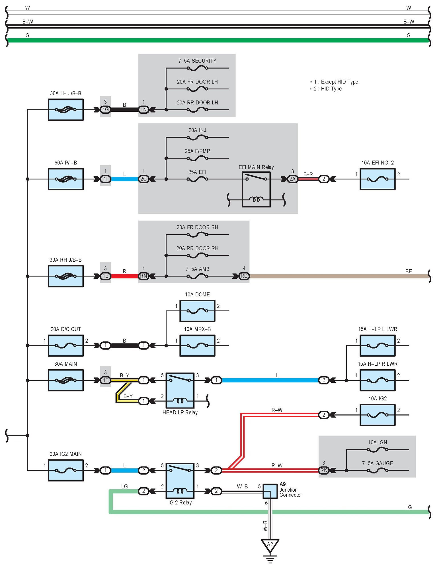

Here you go....
#2IS Electrical Power Distribution, flow diagram

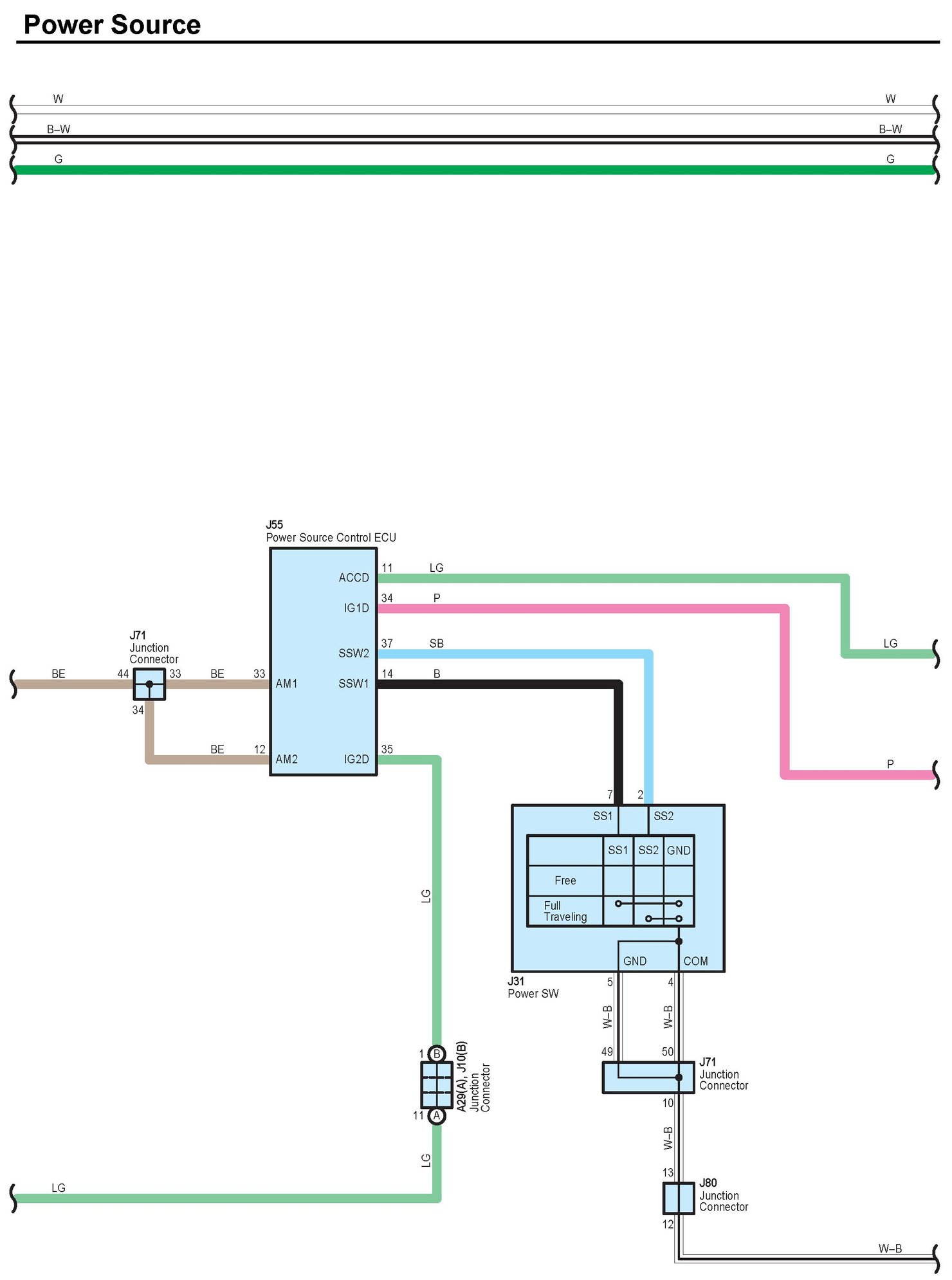

Originally Posted by 2013FSport
Here you go....
Power Source Power Distribution continued.
You're Welcome btw
The thing is a bad ground to make any of this not work too!
You're Welcome btw
Thank you, I will see when's a good time to look into this.
Considering all the moisture, this seems plausible.
