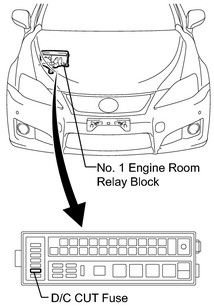

Start with this:
INITIALIZATION
In vehicles equipped with the push-button start function, the starting function may not be operational after recharging or while jump-starting a discharged battery. This condition is most likely to occur if battery voltage drops below 9 V. The following procedure has been developed to address this condition.
1. INITIALIZATION PROCEDURE
(a) Confirm that the D/C CUT fuse is installed. If the D/C CUT fuse is not installed, install it at this time.
(b) Move the shift lever to P.
(c) Turn the engine switch off.
(d) Open the driver's door to start an initialization process between the steering lock ECU and the engine room junction block.
(e) Depress the brake pedal.
(f) Press the engine start switch.
