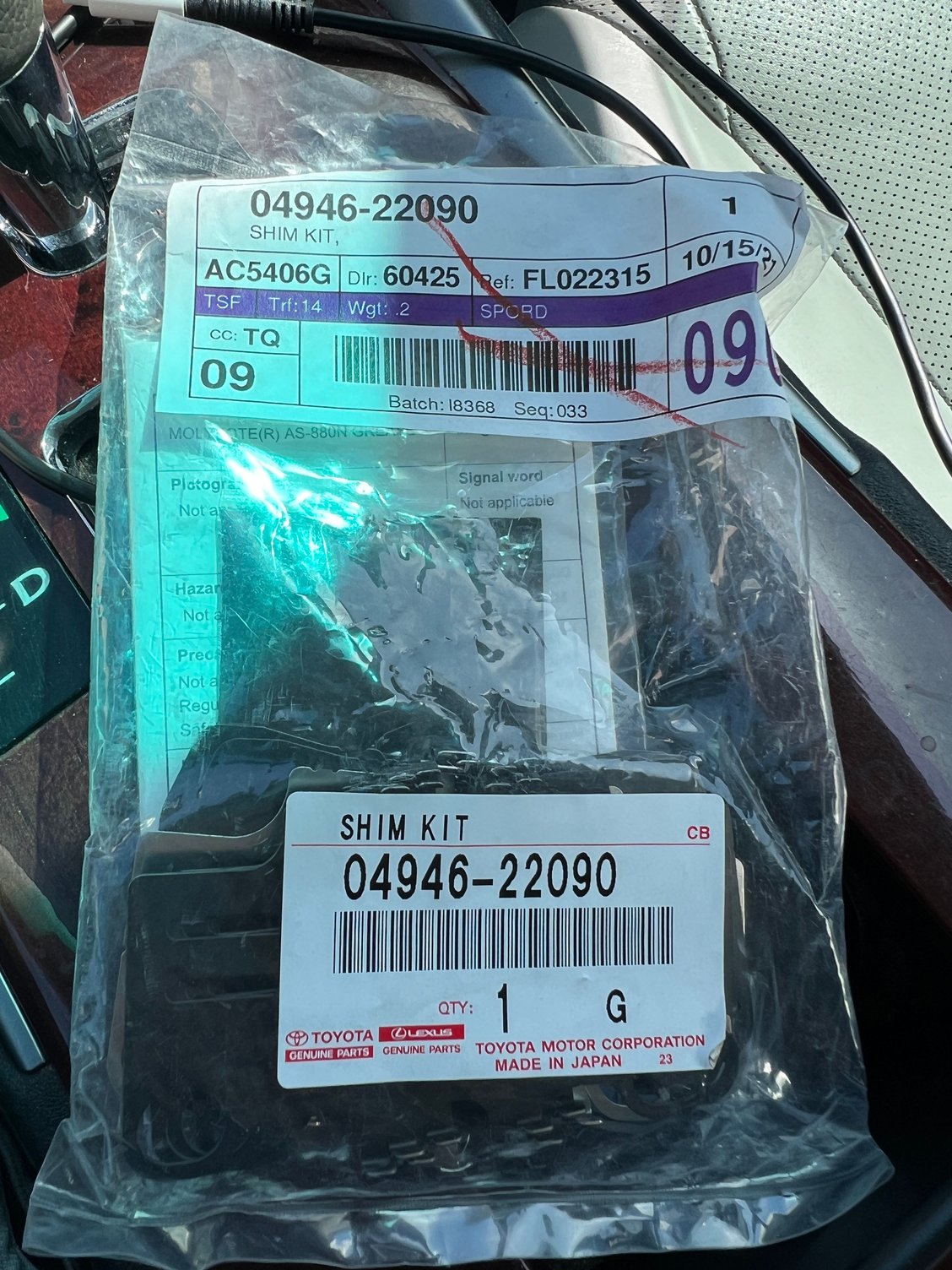

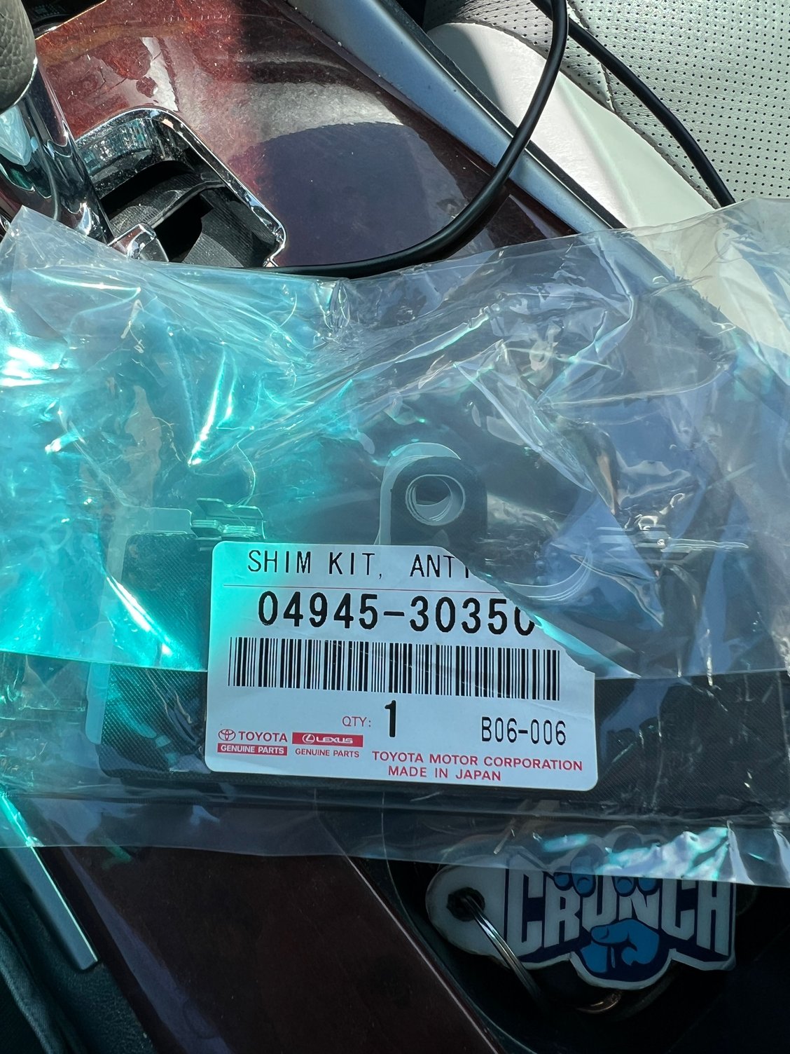

So getting pads/rotors done this round. Car has 180k now, went with centric blanks ctek and akebono act pads all from rock auto. Now regarding the hardware for it do I buy a standard brake hardware kit and does that include everything I need? I noticed on other threads theres shim kits or something extra besides the pins and such.
Lexus Roseville Ca part numbers for the fronts are 04947-500-90 then rear is 04948-30210.
Or would something from napa work too?

Ended up purchasing new shims from dealer, and then disc brake hardware kits from napa and their brands for the front/rear kits. Will update today once brakes are done.

Unknown history with old shims, so this was a new updated part number from lexus. The hardware is direct napa ultra premium so I feel fine, front and rear costed about $50 for hardware. Shims from dealer was $124.

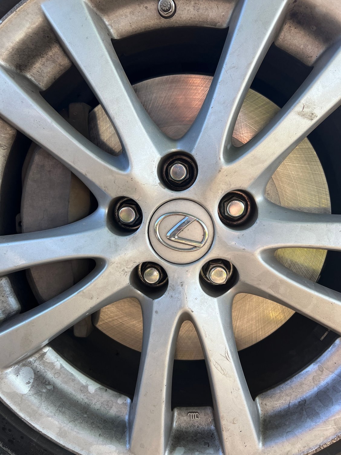

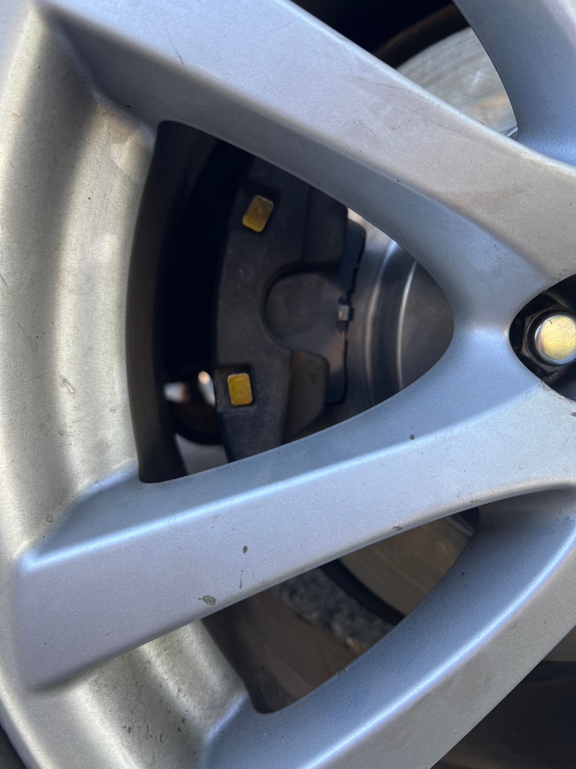

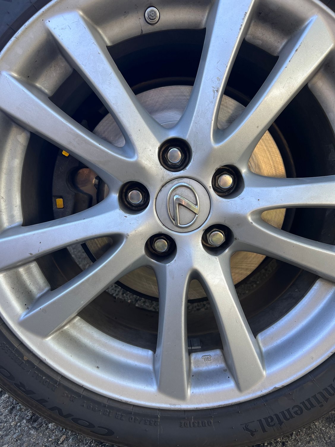

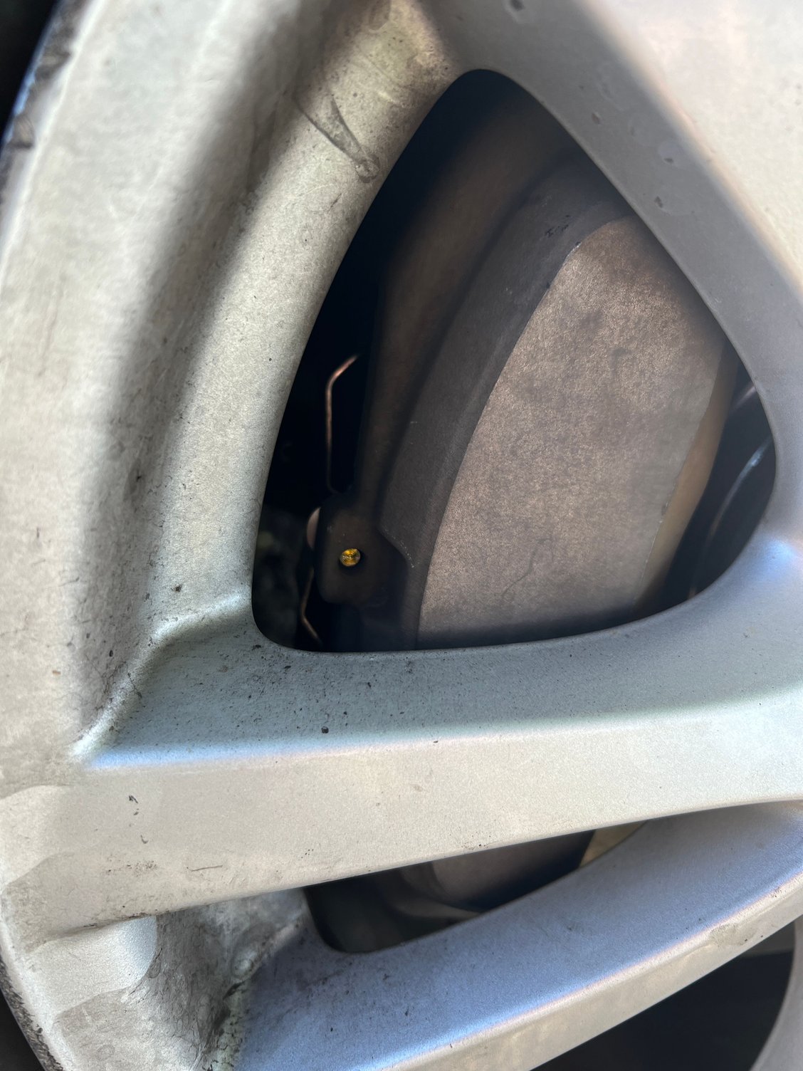

The car brakes better than when I first had it in 2018, it had unknown pads with advic rotors on it, then I had a akebono pad change at 130k. According to akebono they recommend 300-400 miles of moderate braking to bed in the brakes so will follow that. The previous pad change I just changed pads and did a bedding process of hard braking so will update if squealing occurs again. Otherwise it’s great now!
Old May 29, 2023 | 01:55 PM
ncatona's Avatar
ncatona
Joined: Jun 2018
Posts: 254
Likes: 45

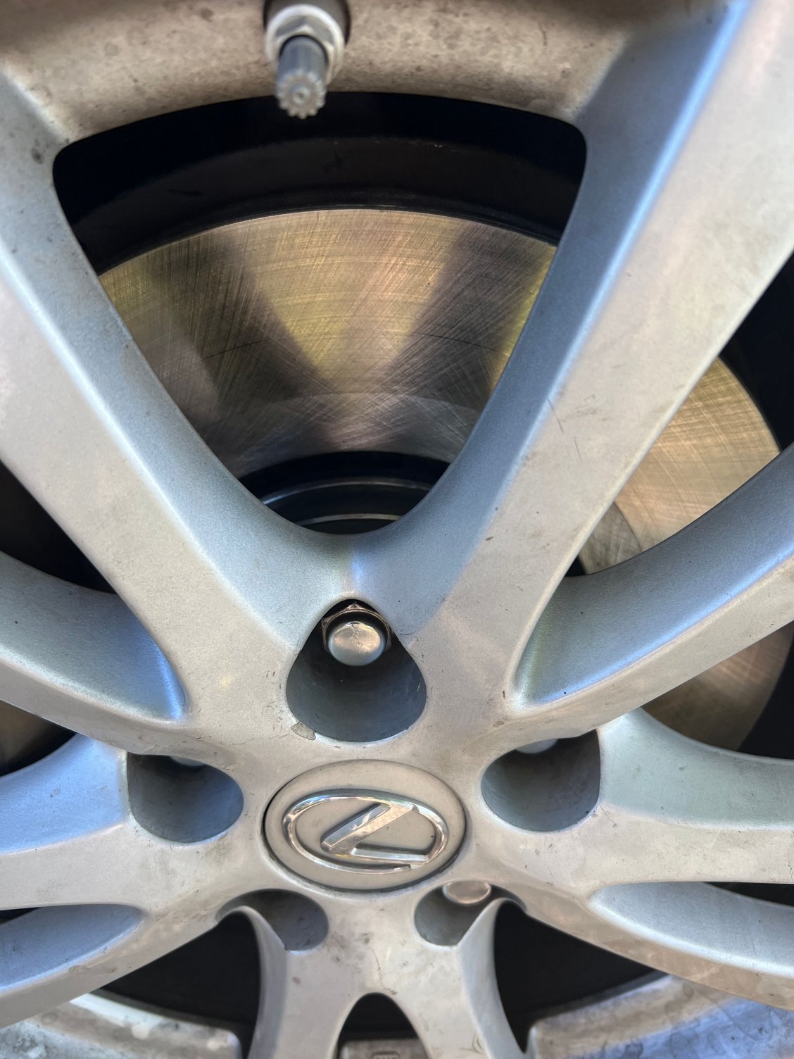

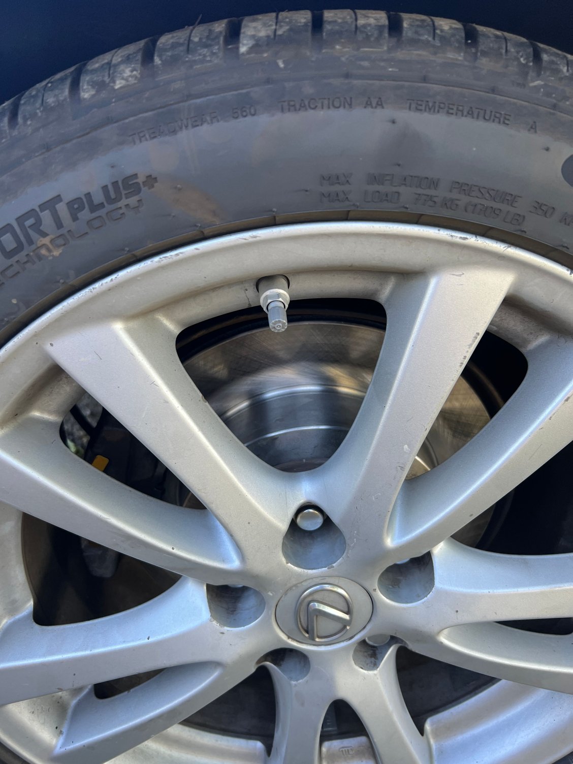

Last update for now… the old rotors had a noticeable lip on them so I’m sure that caused some brake squealing before. I have driven over 300 miles now without a bed in process and there is still no noise going forward or reverse!! Absolutely happy with the results, and the smoothness is noticeable with no hard lurch when coming to a stop now. Highly recommend going the full 9 yards for your brakes.
