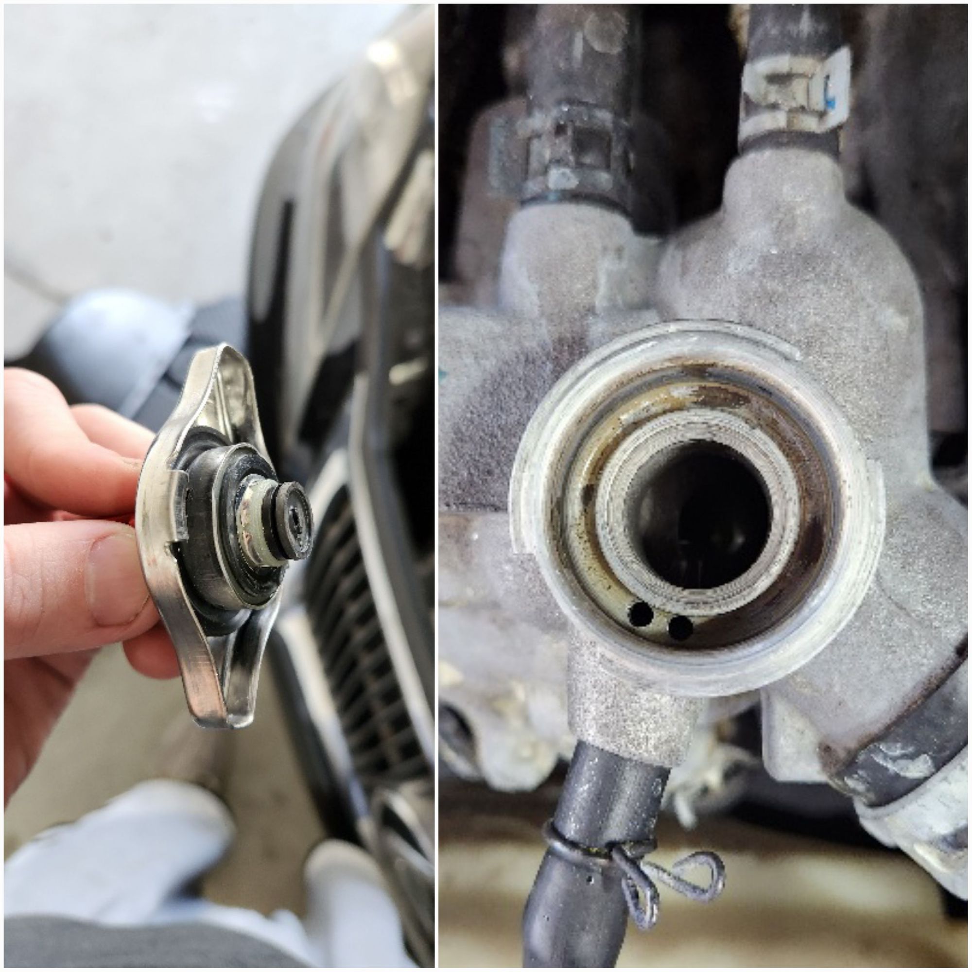

That cap is not the OEM style. Are you in the states?
Flip the cap, and post a picture.
As for you system if the radiator cap is more than 5 yrs l'd replace it. You also have some other things going on on the water neck. See photo below. In all it seems the reservoir cap could also be a culprit.
Wet spot on the clamp red arrow.

Yes I'm in Florida. It is not OEM. This is it here
Is the positioning of the reservoir cap okay? Mine didn't have the tab you were referring to so I couldn't follow the instructions on the other thread when you said to point the tab at the radiator.
Are you referring to the dry white spots on the hose?? That's from dried coolant. Those white spots are all over the place. On hoses, parts below like the oil filter cap and everything surrounding it, plastic covering of the radiator fans, etc.

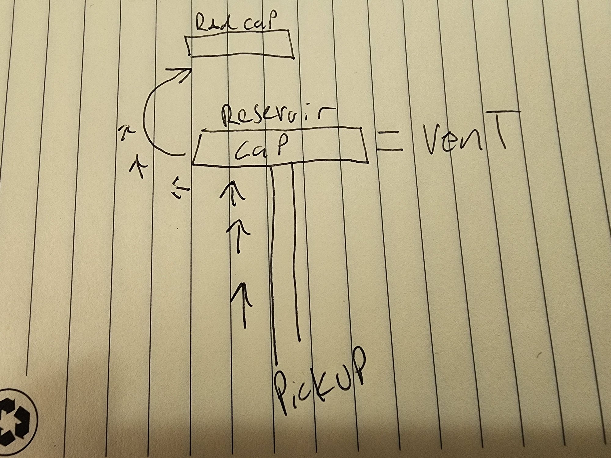

I'm asking the picture of the reservoir cap you have installed now. It's not what was originally installed on the car. Where did it come from? Also is the other side broken, or is it like that?
You need to set it up correctly if possible for now. If not you need to get the OEM one asap. Otherwise you'll never make progress on this overheating issue.
See picture below. You want the pick up side to be sealed to radiator cap neck. The reservoir cap should have one side that does this. If you flup the cap the vent will just have a hole.
Again flip the cap, and find this out. If it's possible then do it as the Picasso sketch below.
Once the engine cools down it will pull coolant from the reservoir each time. Hence the long tube on the reservoir cap. So it's always submerged in coolant. Now if the hoses are switched backwards. When the engine pulls coolant it will just be sucking in air if the hose from the water neck is tied to the vent on the reservoir cap.
There is a cold and hot line on the reservoir tank. Its best to always pay attention to it. If it's droping daily below the Low line you have a problem. If there's no problem with the cooling system the water line should stay put where you set it cold.

I'm not sure where it came from honestly. It's a 2012 and I bought it in 2014. I've never touched it myself.
https://photos.app.goo.gl/2uhfUidBL8Qcpa4DA

Recap: if it overheated so many times it pushes coolant out into the reservoir and the reservoir makes a cloud of steam spraying crap everywhere.
Remember me writing saying the cap has three seals. Any one those fail to seat and all bets are off for your system refilling itself from the reservoir during cool down.
Please ditch that cap an buy an OEM cap.
Also, the roughness inside the fill neck could IMO prevent your cap from sealing. IIRC mine is a nice machined surface. Perfect for the caps inner secondary seal to mate too. Yours looks very corroded and could be a source for this problem.
Basically if the inner secondary seal fails when hot your coolant leaves the block and dumps into the reservoir. When the reser oir overflows coolant sparays everywhere as the fans are likely on during over heating events.
Make sense?
Edit - it might be the grain of the picture making it look worse than it is inside the fill neck. Still, get an OEM cap.

I ordered an OEM radiator cap yesterday and it is coming today. I also am ordering an OEM reservoir and cap with hoses. But all the shipping i've checked (lexuspartsnow, parts.lexus.com etc) won't get to me until 3-5 days. I might try dealerships and see if they have it so I can get it today.
I just drove around this morning with a reservoir tank filled just below the full line. Car started to overheat so I drove home with it around 240 degrees. Coolant was sprayed again below the reservoir tank on radiator hoses, water pump, oil filter cap etc. But the reservoir tank was still full.
