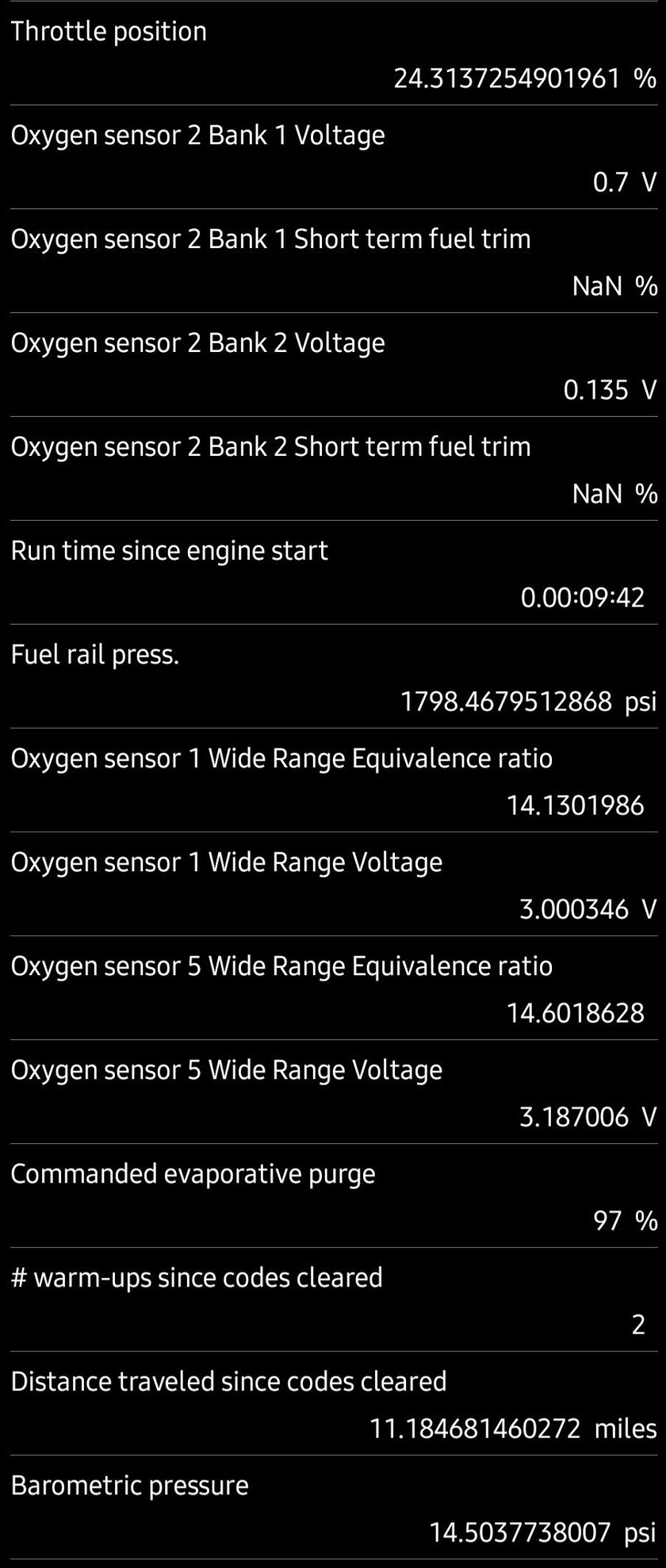

So the P0117 code just popped up again. I attached images of the freeze frame from my OBD2 and also a video of the engine bay. The car was turned off and the fans were still running as well.

Attached Thumbnails Where is ECT sensor located??-screenshot_20230414_154141.jpg   Where is ECT sensor located??-ggggg.jpg   Where is ECT sensor located??-ffff.jpg
https://streamable.com/8gywvy
Please tell in detail the whole story of what just happened there.
It was topped off, started, ran for how long??? And where is the steam coming from?
When was the water pump done and all other details going back to before this problem started.
PS - I'd highly recommend shutting it off at 225 235°F as something is way wrong and it's going to cost you an engine if nof managed properly.
