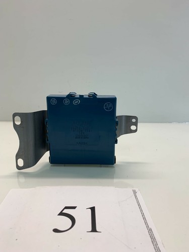

Hi, so my is350 won't turn off after starting the engine. It keeps running no matter how much you press the start/stop button. I have to cut the fuel to engine in order to shut it off. Also when I press lock/unlock button on key, nothing happens. I removed the Multiplex control module behind passenger side glove box and keys work!! but engine no longer starts. I was hoping if I replace the multiplex control module, everything will resolve? But it might need reprogramming?? Anyone replaced this part? -
06-13 LEXUS IS250 IS350 IS F POWER SUPPLY MULTIPLEX CONTROL MODULE OEM | eBay
Find many great new & used options and get the best deals for 06-13 LEXUS IS250 IS350 IS F POWER SUPPLY MULTIPLEX CONTROL MODULE OEM at the best online prices at eBay! Free shipping for many products!
www.ebay.com
Or is there other issue that causes this weird issues? Ty
