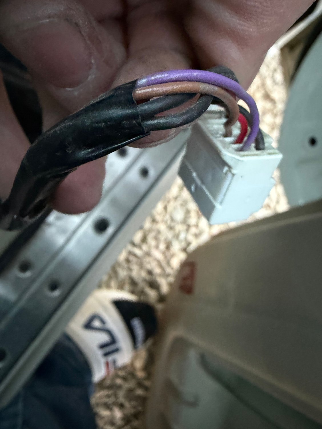

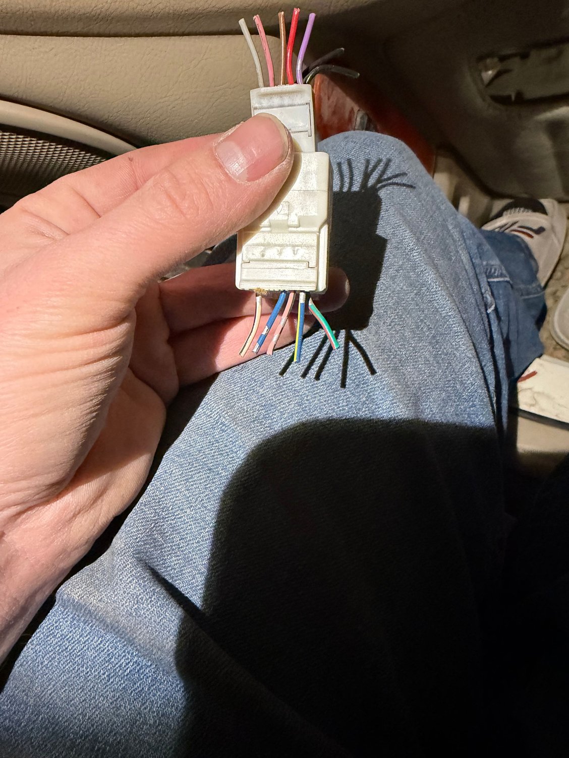

I installed an 02-06 is300 mirror onto my 01 is300. 1st and 2nd photo shows the plug off of my damaged 01 mirror, 3rd photo shows smaller plug off of the 02-06 mirror, as you can see it’s a different plug and doesn’t work. I cut both plugs off and wired it directly. You won’t wire up the pink or grey wire, I left them taped up. Here’s how I connected the wires from 02-06 mirror to 01 is300:
Black - Green/Red
Black - White/black
Purple - Blue/Yellow
Red - Pink
Brown - Blue
Pretty sure one of the blacks off of the 02-06 mirror is the positive and the other black is the negative.. I got lucky and wired it correctly the first time, I imagine if they get mixed up and you swap them you’ll blow a fuse and then just switch them.
