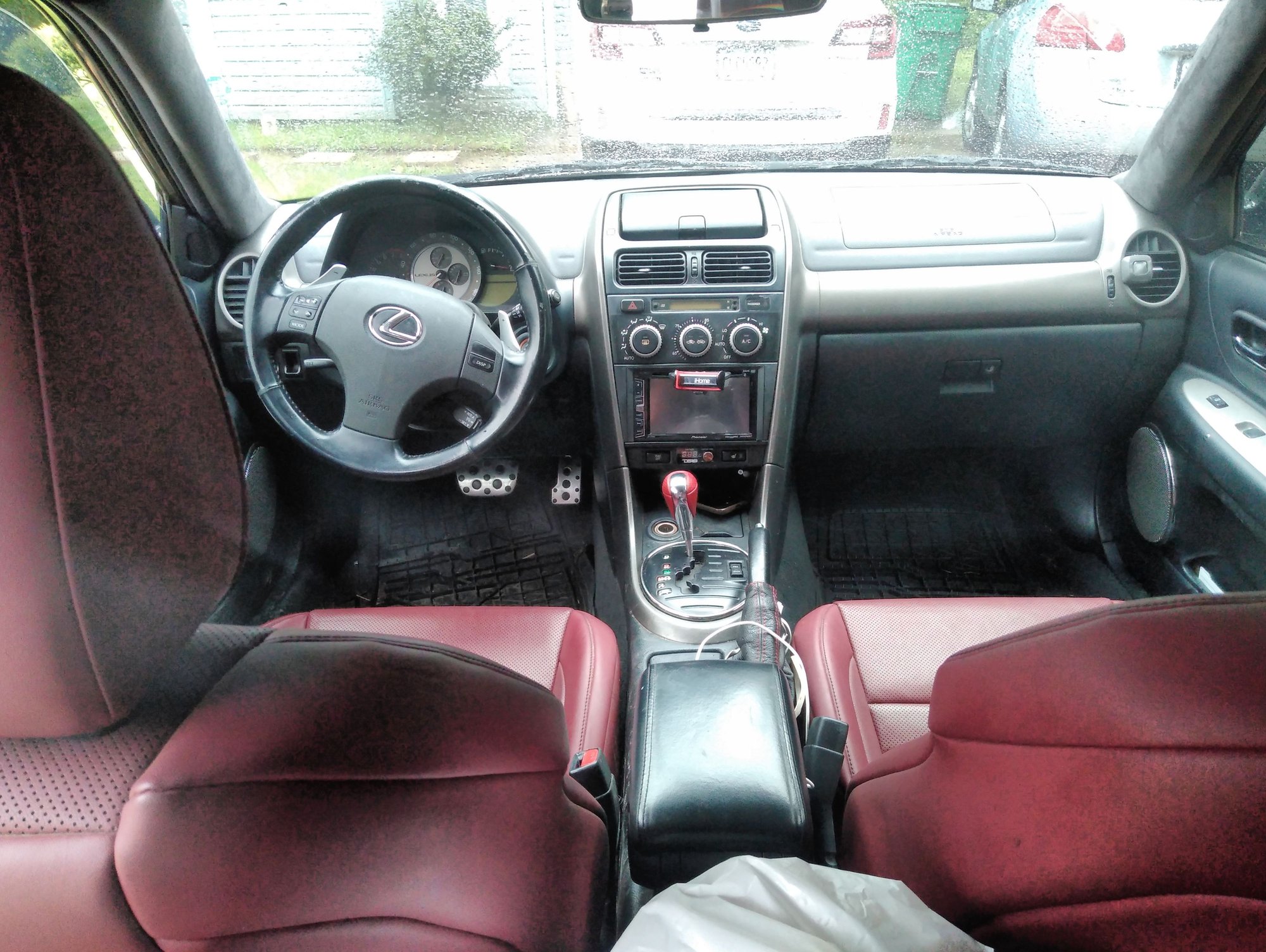

Which gen is300 are you referring to? I have a 1G 2001 is300 with 2014 ISF Red seats installed. Both Driver and passenger working, however, I had the heat feature disabled.

Default Here are the seats
Originally, I had tan interior and it was in an awful state. I had everything converted from a 2004 and 2002 is300 part out..
*Door cards
*Rear seats
*Center storage compartment above the vents
*Arm rest, which turned out to easier to install than I thought. That low arm rest was a terrible design.
The steering wheel came from an is250, and yes, the pedal-shifter does work. Just switch the airbag igniter to the is300 model. Everything else bolts right up.
A friend (An Electrician, of course ) and I installed the seats. This was done about 2 years ago. We went thru testing every wire. It took about 2 hrs for the total install. We butt connected all the wiring. The driver side was installed first, since it had a few extra features compared to the passenger seat. I decided not to connect the heated seat feature, due to the fact it dries up the leather. Once we figured out the driver side, the passenger was a breeze. Also, got the lower lumber air feature to work for the driver seat. The front side of the seat brackets lined up perfectly, however the bolt holes on the backside of the bracket closet to the doors had to be drilled and tapped. The head rest of the seats can go beyond the roof, meaning it presses the headrest into the ceiling of the car. Not done yet, have two more items that I want to add and remove 1 that I now regret doing.

We really didn't follow the diagram. We just kinda figured out which wire went to what. One by one, it really wasn't that hard. I will post pics for the wires underneath the seat. Maybe someone can post a wiring diagram? for both models. The seats were pretty hard to come across. But I will do what I can to help.
