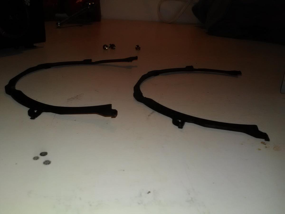

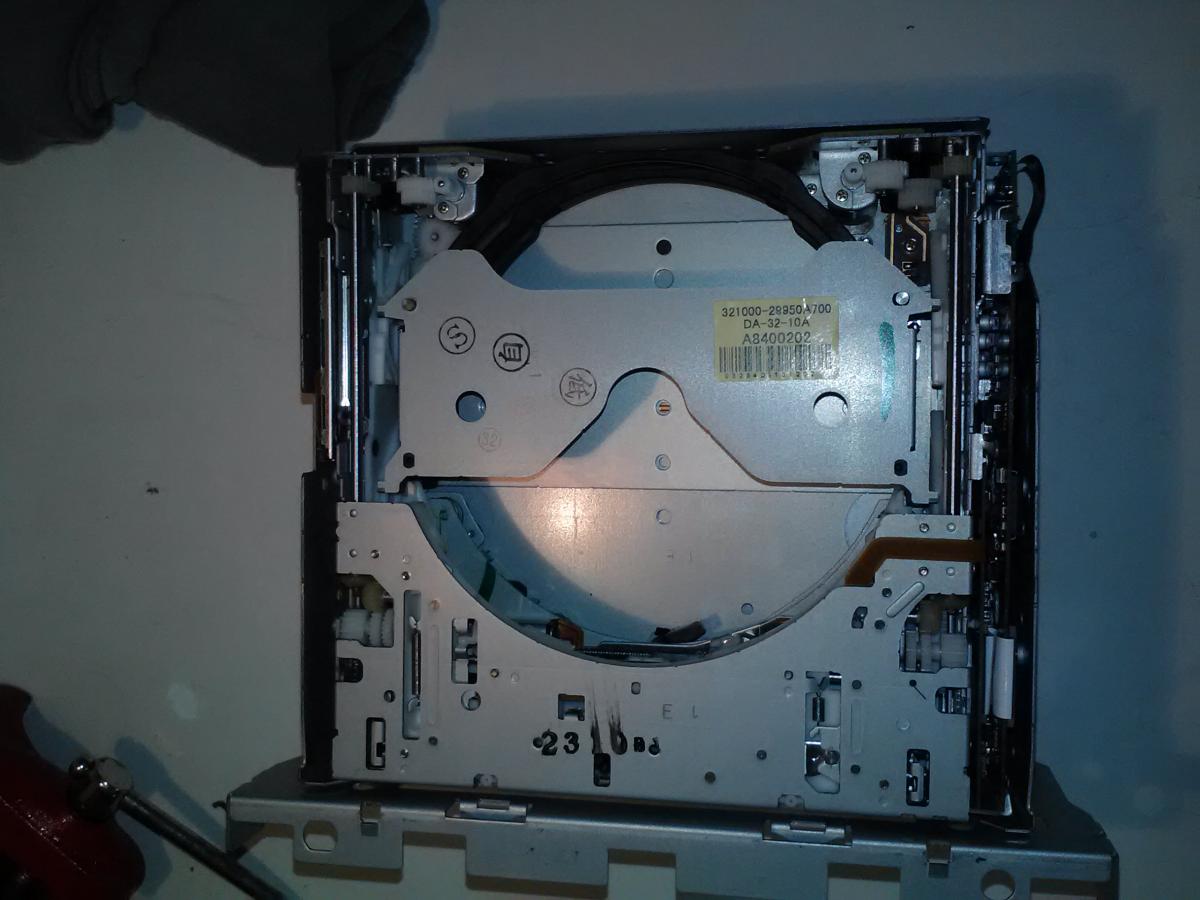

When I opened the unit there were 5 home made CD's in it (from a previous owner). One of the 6 "trays" which really look like plastic cir-clips was bent and cracked. While handling it, the end broke off. I can't tell whether I damaged it getting the CD's out or it was already damaged. Oh well, like I always say "If it's broke, make sure it's broke for good." : )
If nothing else, it's kinda fun to watch the mechanisms try to figure out what to do with the top off while it's plugged in to the dash. Maybe I should start shoppin' for a new radio...

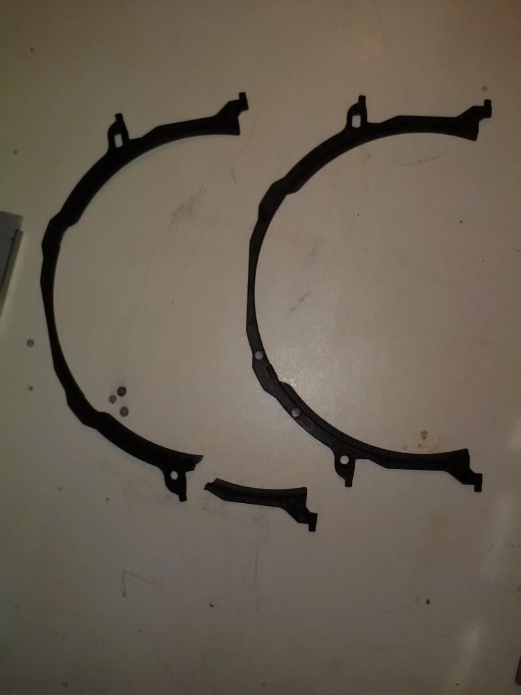

I know this is an old thread but it was nigh impossible to find any info on the part I need. I have the same head unit as OP and it jammed a long time ago. When I took it apart one of the stupid plastic CD trays was broken in half smack in the center. That's like the narrowest spot on this part and is impossible to glue or otherwise repair (after looking inside the HU it's no wonder Toyota has so many issues with these, it's amazing this thing worked at all, very busy and fragile system). I'm wondering whether anyone still have these trays sitting around that I could buy from you? I really don't want to spend the money on new head unit as I have to get Metra/harness/dash brackets which IMO just not worth the money.

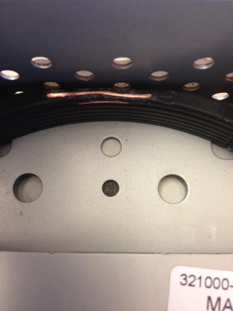

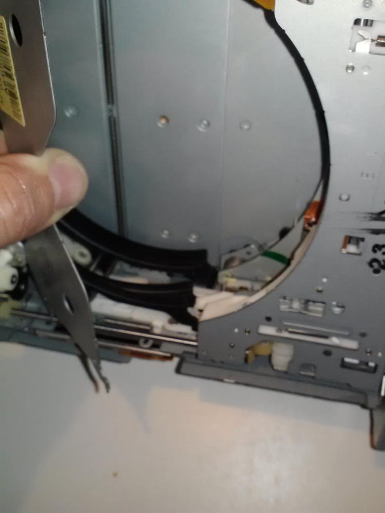

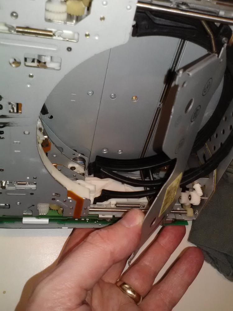

I'm not sure why you bothered posting anything when I *clearly* indicated it wasn't worth it for *me*. Otherwise I wouldn't have posted here and just swapped the unit. Unfortunately Toyota made it really difficult with all the proprietary crap. I like fixing stuff especially if it can be reused and suits my needs. It can be a fun, challenging and rewarding experience instead of simply sending more crap to a landfill like most people do.
So anyway, I actually fixed the broken cd tray by using a triangular file to carve shallow grooves along the flat area of the tray. I did it on all four sides and then used bare solid copper phone wire and crazy glue to make the braces (I used small pliers to push the wire in and glue better). I used the same file later on to smooth out the surface and ensure wire and glue didn't stick out. The end result albeit ghetto looking ended up being extremely rigid and is working. I put the repaired tray on the top instead of bottom where it would see less action because the top side is slightly bulging and wouldn't sit flat against other trays if there were on top. Bottom side turned out really nice. Outer side doesn't matter at all and inner sides does need to be flat for cd to stay in the tray. Sadly I didn't take any pictures until after assembling the unit back as I wasn't 100% sure it would be successful. It however worked out great and it's working now! This took maybe a couple of hours including waiting for glue to set.
Tools/materials used:
- Leatherman Squirt multi tool (pliers, file)
- Scotch tape (to old the cd tray on the desk while I glued or filed it)
- Solid copper phone wire (braces, only needed a couple of inches; I also used the wire to hold the tray springs while the metal bracket on top of the trays was removed, it holds the trays tightly together)
- Crazy glue
- Spare time and some creativity
