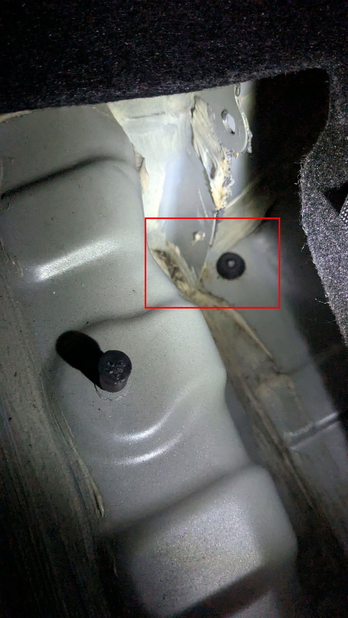

The right side of the trunk is regularly wet in the front corner (closest to front of car) after a moderate rain. The trunk vent isn't wet, so I can't see where the water is leaking in. Anyone have this experience or ides for areas to check?
BTW - the sunroof drains are clear and working and there is not apparent rust in the area where the water appears - maybe recently new leak?

Mine got a leak on the left side after an accident in the back. It only leaked when parked at a certain angle. I never could figure it out. So, I just removed the plug in the bottom and didn't worry about it. These cars are old, and the weatherproof caulking dries up over time and stops working to keep the water out.

Nothing obvious comes to mind? But I bet you can identify the culprit if you give it a good inspection. Is there any potential entry points in that corner? A power antenna? Or the gas door? If you get out the garden hose and have someone spray it while you get inside and watch for water, you should be able to find it quickly.
