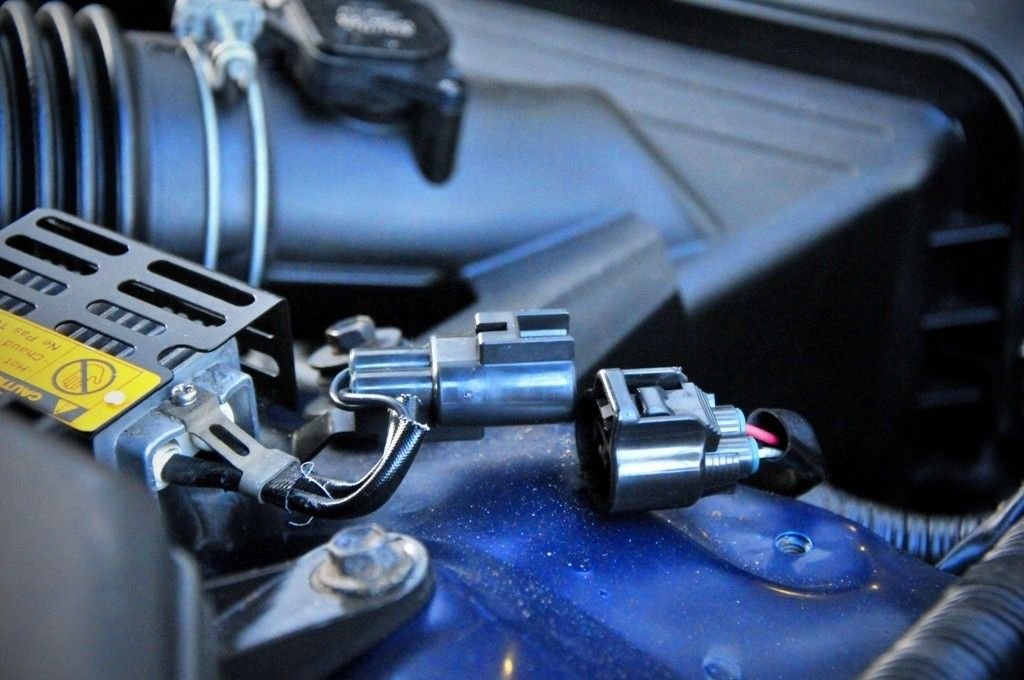

The high beams are also used for the DRL. Do your DRLs work? There is a resistor box under the hood. Maybe that went bad. You can check if you have power there.
It looks like this, it's at the left of the engine bay when you open the hood, mounted by the wheel well, with the yellow sticker on it:
Though, I think the high beam should still work anyway regardless of the resistor box. I unplugged mine to disable the high beam, and it still worked.
