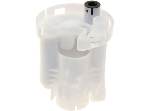

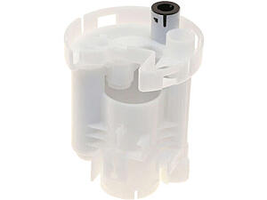

Thanks everyone for the input, my inbox was toooo full to keep up
Anyway, if anyone will have similar problem, check fuel filter, mine overworked soooo hard due to filter being clogged that it started to melt from the connector.
I thought i had fuel to cylinders because i could smell it, but it wasn't the case
The high idle was something soo stupid and overlooked, tps needed to be tighten........ yup, i know
car now runs, but still have overboost problems
