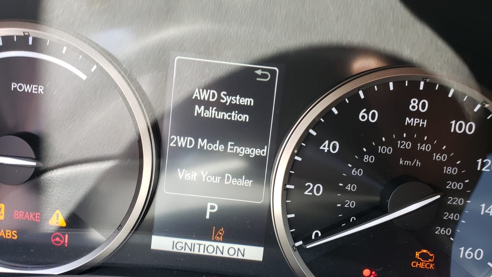

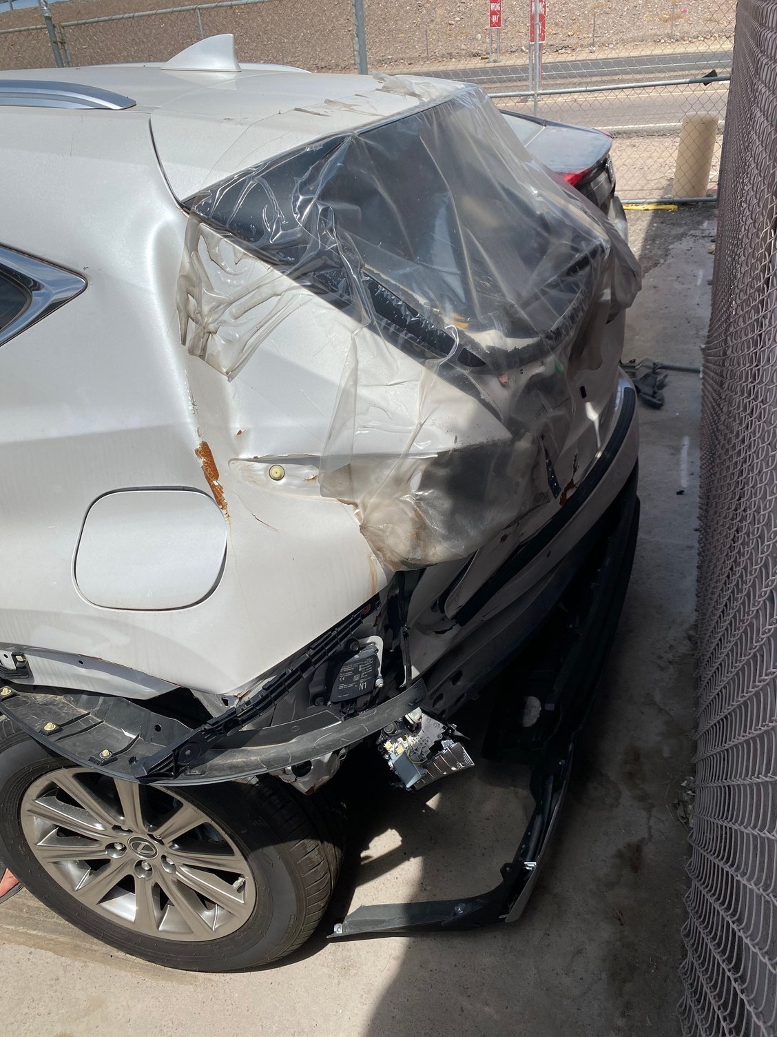

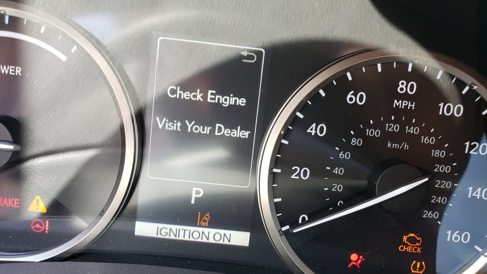

I recently bought a 2020 NX300h from a salvage auction. The car has minor frame damage in the rear, on the drivers side but there's little damage to any components apart from taillights and parking sensors. When I received it, and still now, 3 weeks later, it refuses to start the hybrid system. I connected a brand new 12v battery and the gauge cluster will power on, but nothing else will work. I can't kick it into acc mode either. In the screen there's a bunch of error messages, mostly hybrid system malfunction, braking system (bc the parking brake is stuck on) and airbag warnings (no airbags blew in the accident).
I have a suspicion it has to do with the safety system and it doesn't want to start when there are airbag and braking issues. My current plan is to repair the body and frame and panels and see which errors go away when the car is cosmetically back to normal.
I'd like to avoid taking it to a dealer since it'll all be out of pocket and I currently can't move it very easily either. I also don't have the proper scan tools to see the hybrid ecu codes but I might be able to get my hands on that.
Anyone got any tips or advice? It's greatly appreciated.
Attached are the warning messages and a pic of the damage

Disclaimer . . . this is a speculative hypothesis and not based on experience-based wisdom .
What is common to all of your posted error messages is they are all system diagnostics. In my estimation, there are only 2 possible causes that are common to all of the represented systems:
(1) 12V power.
I do not have any service info for the hybrid model, but I do not think the overall 12V power flow should differ that greatly from the gasoline models. I do not see any single fuse that would affect all of those systems yet permit the instrument panel warning display to function.
(2) CAN multiplex bus.
All of the systems referenced in your images, including hybrid propulsion, have a node on the CAN bus, which among other things, is used to communicate diagnostics. Furthermore, the rear parking sensors (blind spot monitor detectors) and rear view camera are also all individual CAN bus nodes. Damage to either of the CAN bus wires could possibly compromise the entire communications network and result on false error messages. I would start by replacing the obviously-damaged rear sensor and see what happens.

I should have added that I suspect you will find the parking sensor connector has been crushed and/or wires severed. You might have to purchase a replacement connector and splice it into the harness.

Excellent thank you so much for the help. I was planning to get the sensors and rear electronics sorted out before I panicked. Hopefully that'll clear away most of the diagnostics. Thank you again
