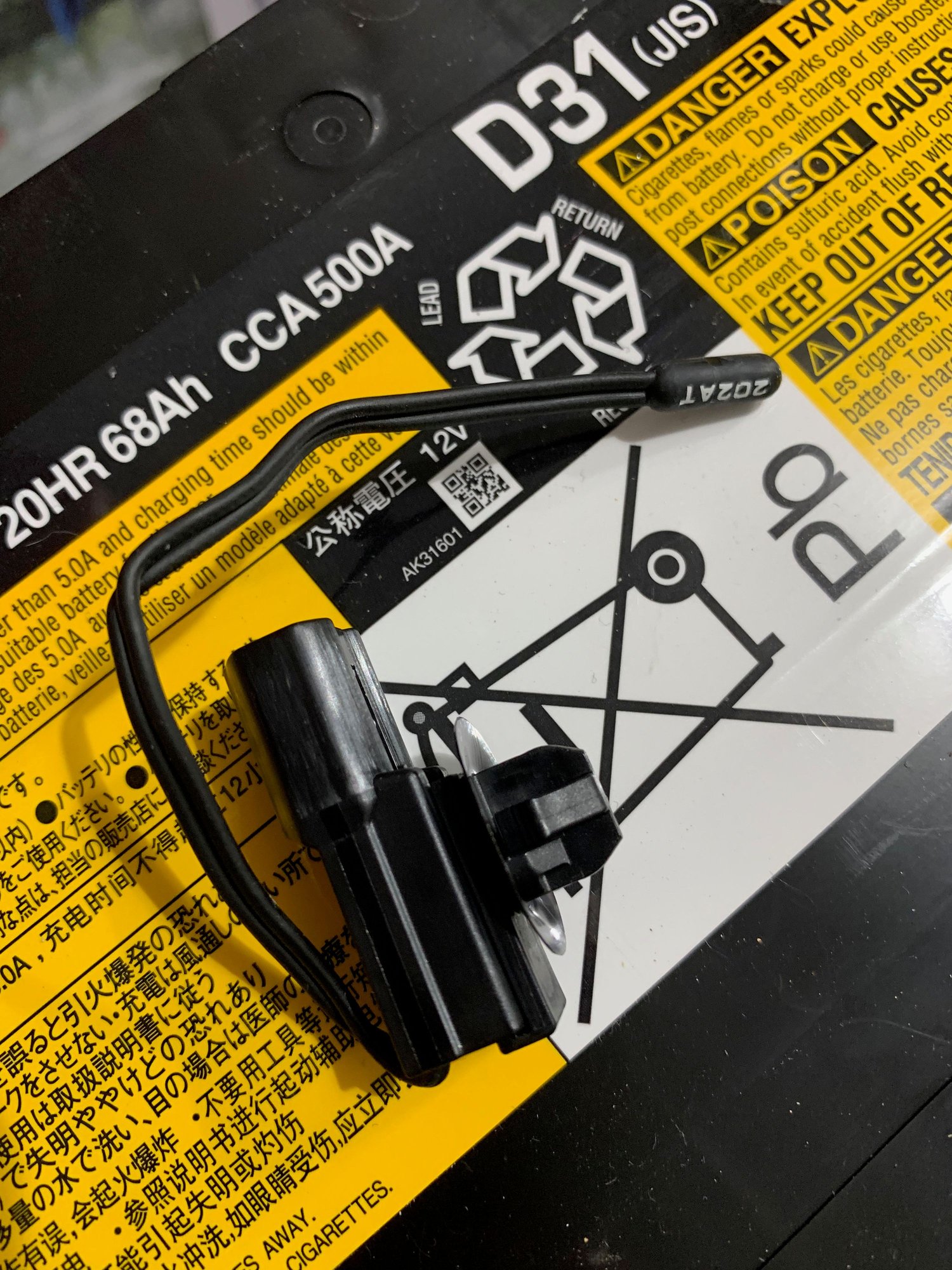

Default LS600hL Battery Temp Sensor Removal

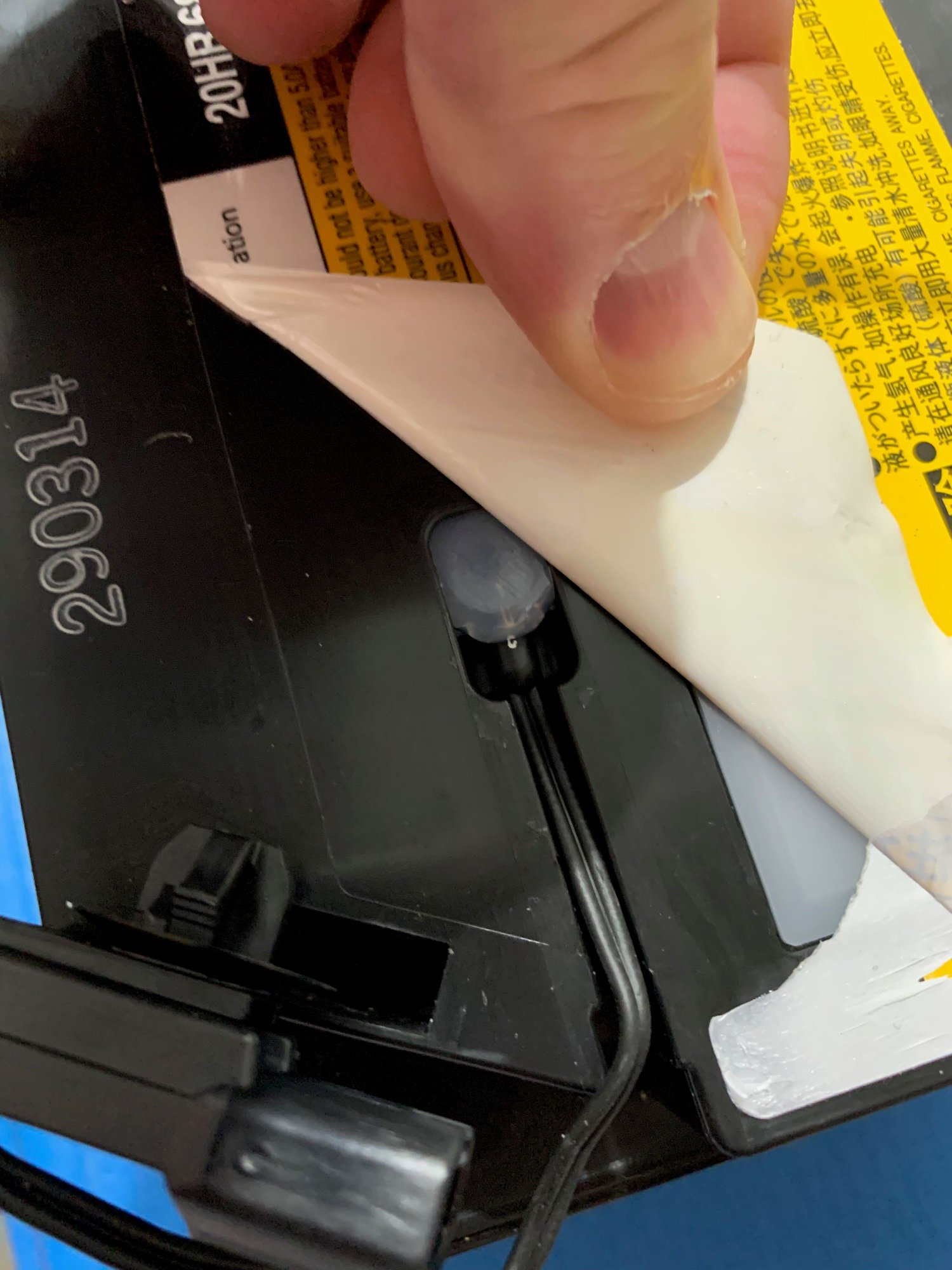

Plug with cable routed under label.
Hot Glued in place which can be pealed out carefully without damaging the sensor.

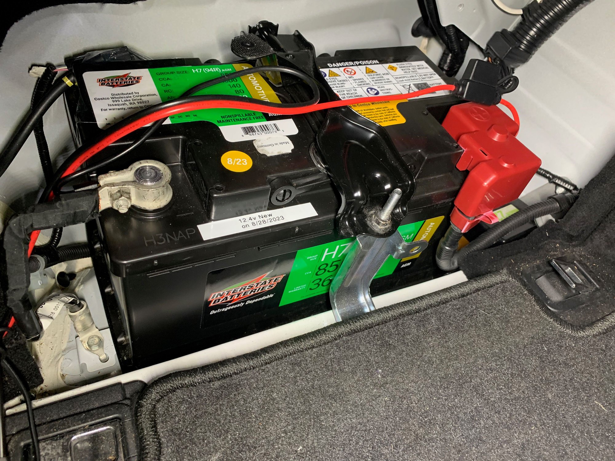

Hot glue to new battery. I used silicon and a strip if shipping tape which seems to be holding ok, placing it in crease at top back.

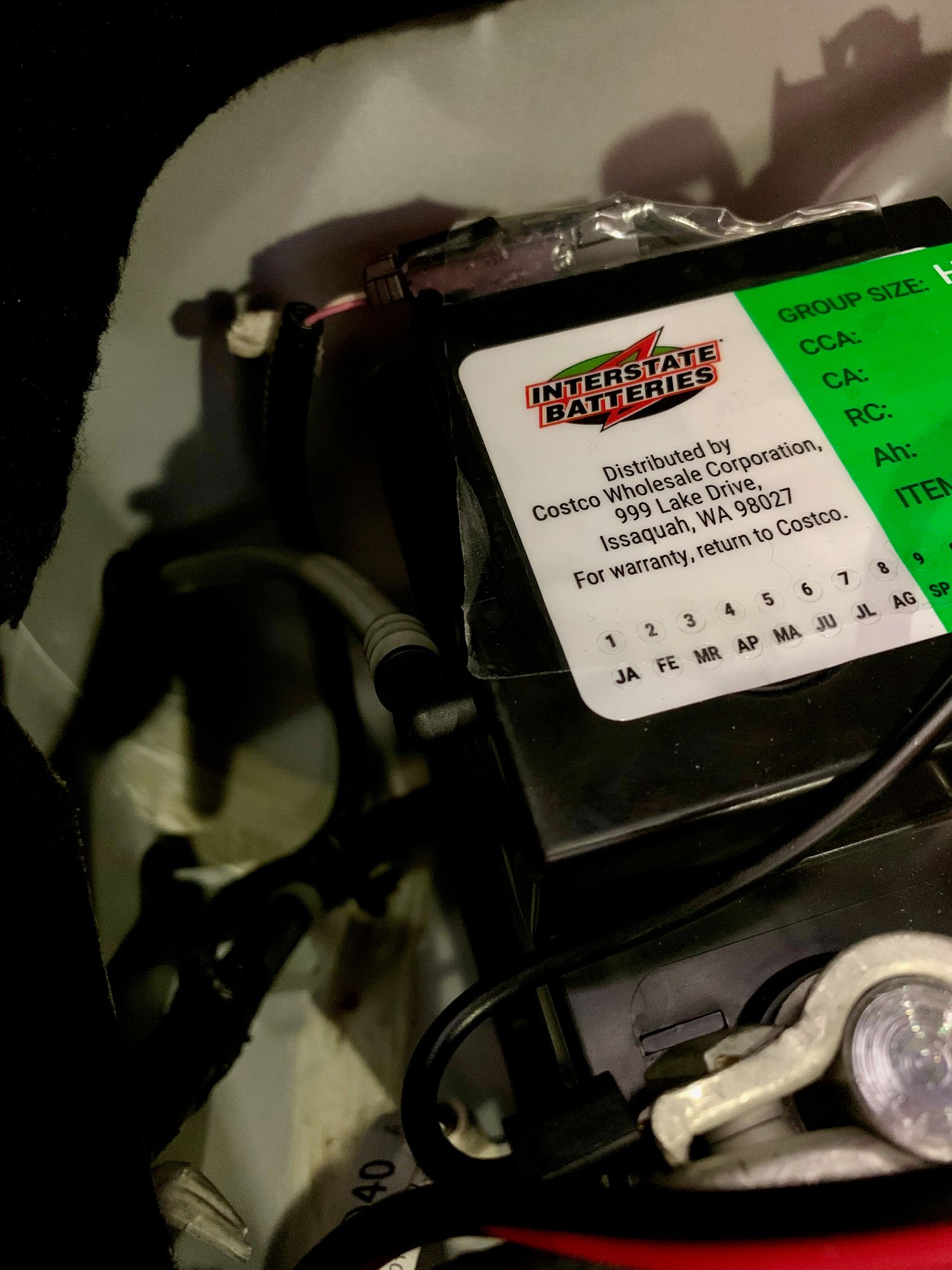

The Costco H7 AGM is an AGM Interstate that currently sells for $179 and includes a 3 year replacement warranty. As discussed earlyer it is a near perfect fit. I found that a couple 1/4" rubber bumpers (meant for under a toilet seat) under the top hold down bar helped firm up the mount to a perfect fit.
You will want a smaller vent elbow. I bought a Dorman "
924-253" vent hose for $13 on e-Bay. Get the Dorman 924-254 kit. For a perfect connection between battery and hose. That end appeared too large to stretch it over without splitting, so I moved the body groment over to the included hard plastic hose and found that with a bit of finagling, it could be used to vent to the outside from the battery while maintaining a tight seal through the opening. Hope this helps.
Not the best picture, but shows Dorman vent hose and temp sensor attached on Interstate battery (AGM, H7 model). Body grommet is tight and takes a little struggle to get back in place because of the hose angle and size but will work.

I forgot to mention the other small modification I made was to trimming the corner plastic on the red positive terminal cover, for the Interstate batteries case was too tight to fully seat down lacking that. Leaving it loose would also work fine though arguably be less perfect.
Also note the non-factory red and black wires atop the battery installed are for a cable to a quick connect maintenance charger plug. Perhaps I won't require that as often now that the battery is fresh. Hope this is helpful.
