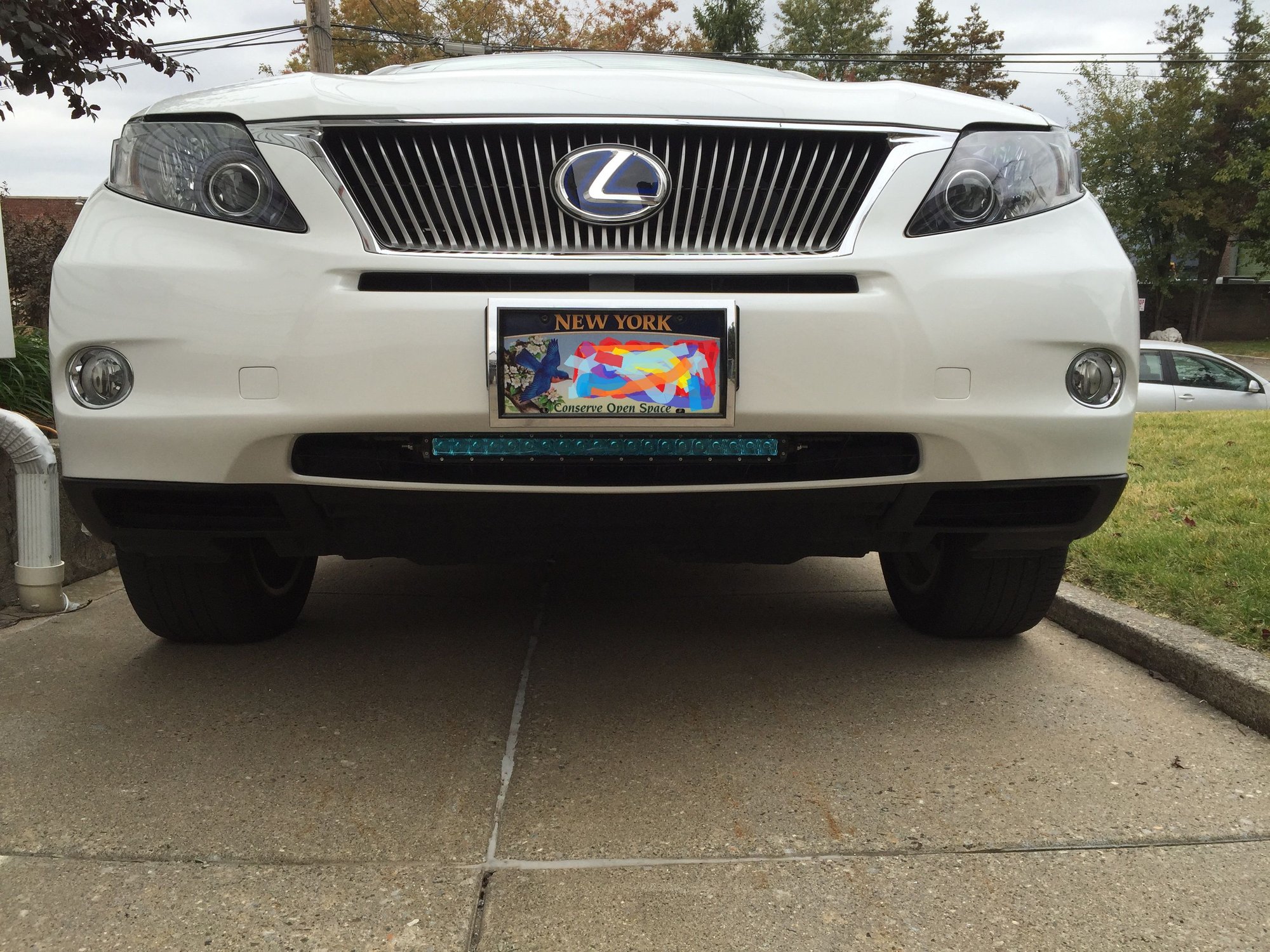

hello 2 months ago I installed an led light bar I tapped is to the fuse box to get power as I turned the lights on my rx motherboard got fried and the car went dead cost 2000 to fix at lexus ,I still want to install it again this time I was thinking of running an independent line from the battery straight to the light so I don't fry anything again any feedback is appreciated.

Which motherboard?
What is the max current draw for the bar and how do you intend to turn it on/off?
Based on your answer, we may need a relay.
Salim

Originally Posted by salimshah
Which motherboard?
Salim
have a relay the bar is 20 inch 5 watts by motherboard I mean the computer
I still can't understand how it would burn down the ? computer.
If you want to risk it again here is the proverbial rope:
Battery + terminal ---> fuse ---> relay secondary term --> relay secondary other contact ---> + of the light bar ---> ground of light bar --> chassis.
switched +12v line ---> primary side of relay --> primary other terminal --> chassis [be careful and dont short out the switched +12v ... specially if it comes from the motherboard
Salim
