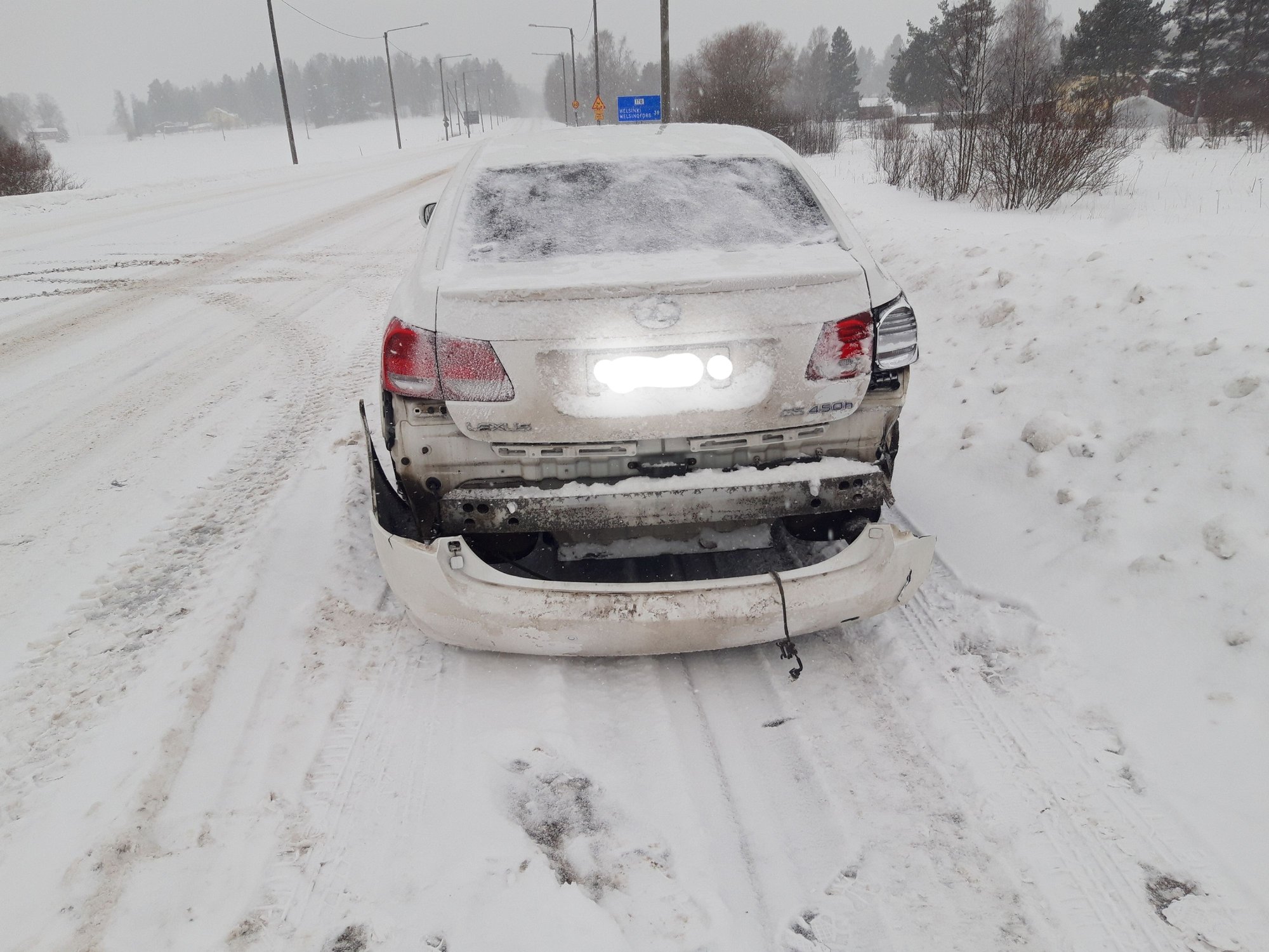

Till the end, one picture of what happens when someone ignores the stop sign. Nothing happened to me and the car is now in the repair shop.

Ouch. .. Just the rear right I hope?
