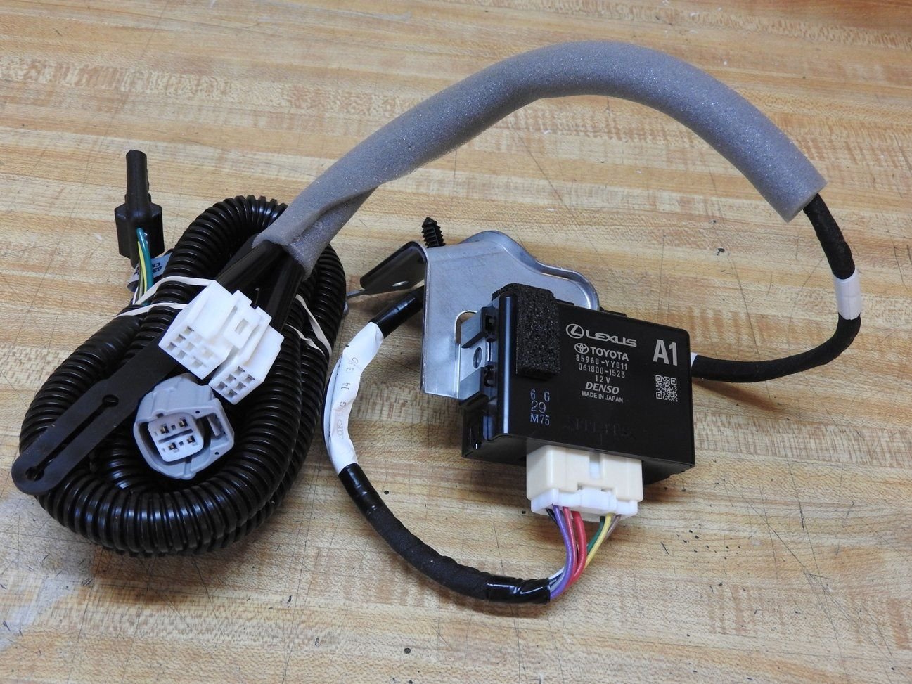

Thank you for the reply @StefanoS . Does you or anyone have a picture of the converter that clearly shows the connections. An installation (wiring) diagram would also be helpful.

Curt harness 56083 is the grey plug thingie on the left with the rubber band around it.
Lexus converter is PT725-48232 with white multi-terminal plug

If it's not too much trouble, can you post a picture from the opposite side? The black connector w/ green wire looks like it goes to the trailer hitch? Where does the other side of the harness attach? Is it detachable?
Thank you for doing this. Hopefully others will benefit...
Oh, nice job on the electrical connector. It looks factory installed.

The other end of the Curt harness is simply a generic flat 4-pin trailer plug.
The grey plug that you see connects to the harness behind the rear bumper on the right rear side, after you remove the grey protective cap. Crawl under your rear bumper and look up under there and you will see it.

Here's another Club Lexus thread that has pictures of the converter installation (about half-way down). It answered all of my questions.
