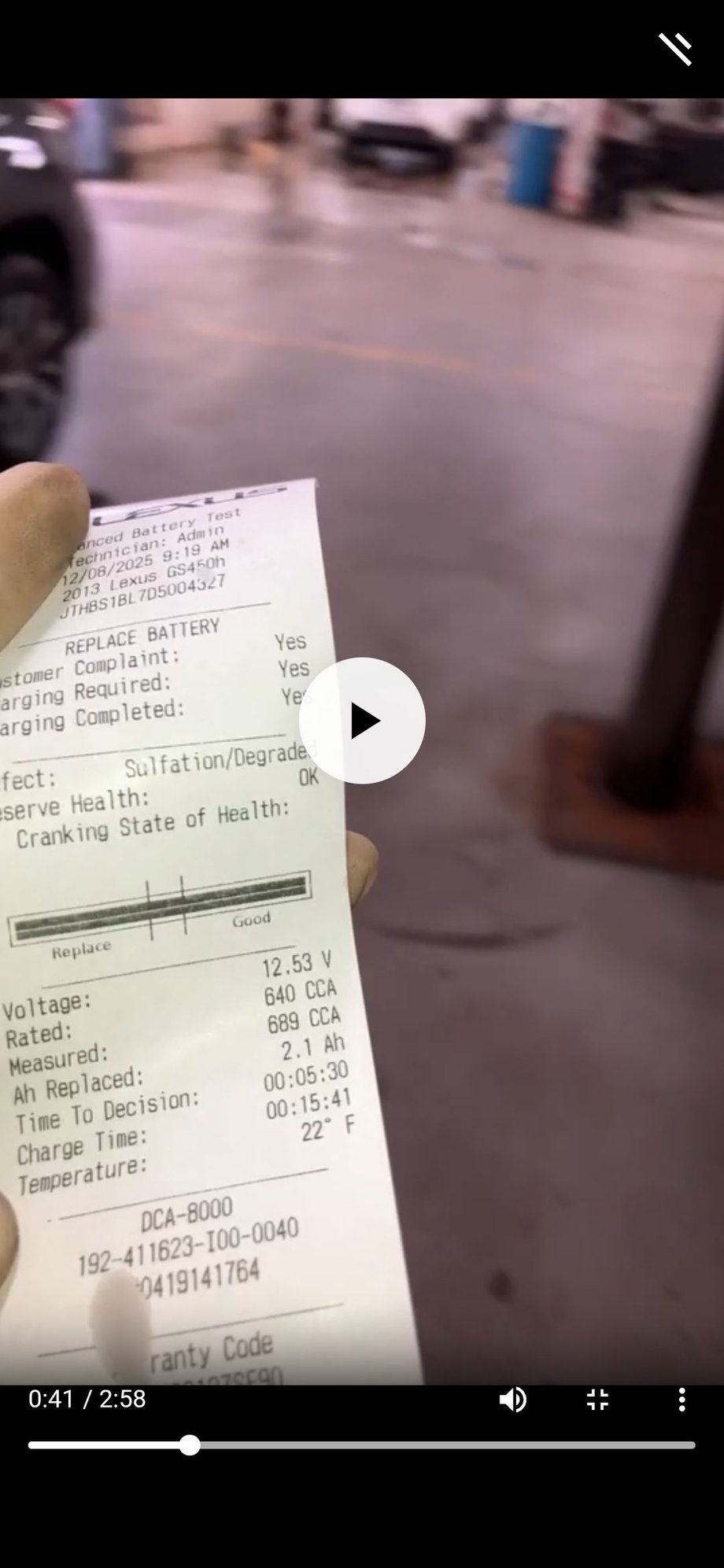

They only sent a video, so I captured this
It is only 1 year old battery and it is a AGM deep cycle.

For whatever reason (design/plate configuration, etc.) a sulfated battery is a weakened battery that cannot be trusted.
Battery sulfation degrades lead-acid batteries by forming hard lead sulfate crystals on the plates, reducing their surface area, increasing internal resistance, and crippling the battery's ability to hold charge and deliver power, leading to premature failure, slow cranking, and shorter life.
It's time for a proper 12 volt auxiliary battery designed for how the GS 450h uses the 12 volt for auxiliary to power (all lighting, audio, HVAC, Navigation, power seat, seat heating/cooling, power rear shade, etc.) - that also has a venting port....
