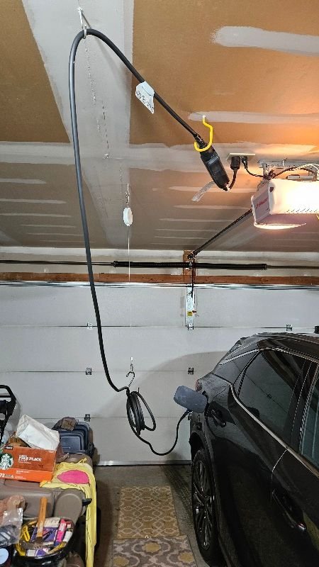

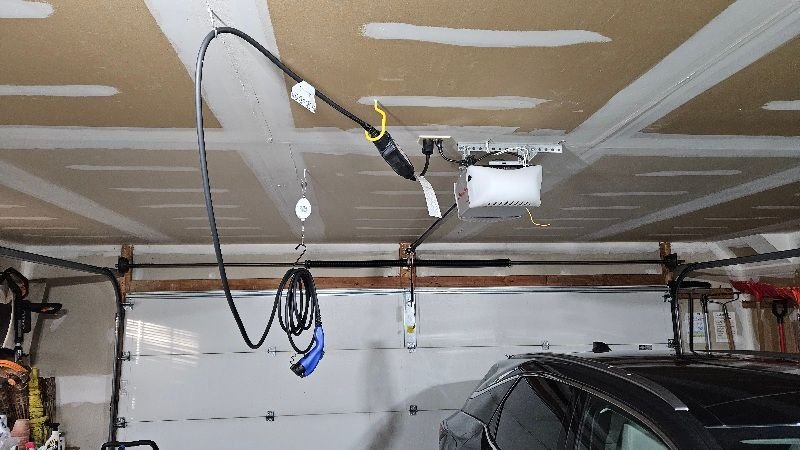

Just thought I would share my garage cable management solution with the forum members. I have had my new 2024 RX450h+ for six weeks and I love it. Regarding slow charging with the level 1 portable cable, I had no concerns with it since I park it in the garage and I have power outlets in the garage. The 10 hour charging for a full charge is fine because is sits there all night anyway. I don't really see the need for a level 2 charger. I plug it in every night.
I figured that the 120V outlet in the ceiling for the garage door opener would be the best source of power since it is right above the side of the car with the charging port. However, I did not want to have the cable dangling from above and coiled up on the floor day after day. The solution was a few screw hooks and a simple and cheap retractable hanging flower basket pulley and a large hook on the pulley. With this setup, the cable is out of the way when not in use (up near the ceiling) and also readily available to pull down to charge. Attached are photos to show the installation. Maybe others can use this concept, or share their own solutions. The pulley is a Black Elk Peak flower basket retractable pulley rated for 40 lbs.
Charging position
Charging position
Stowed position
Stowed position
