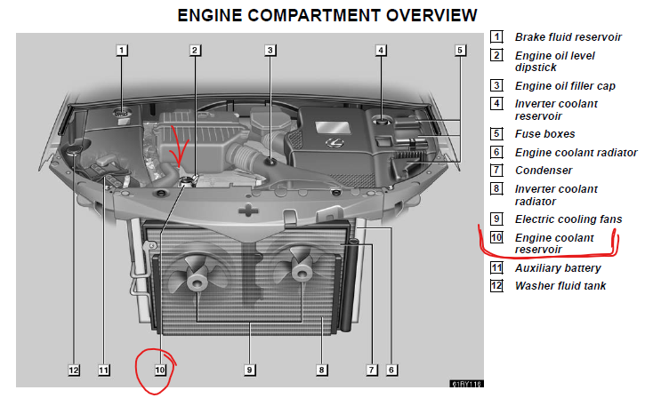

1. It shouldn't overheat on freeway unless something wrong with cooling system. Did you check the coolant level? It should be checked on radiator, not next to windshield close to driver.
