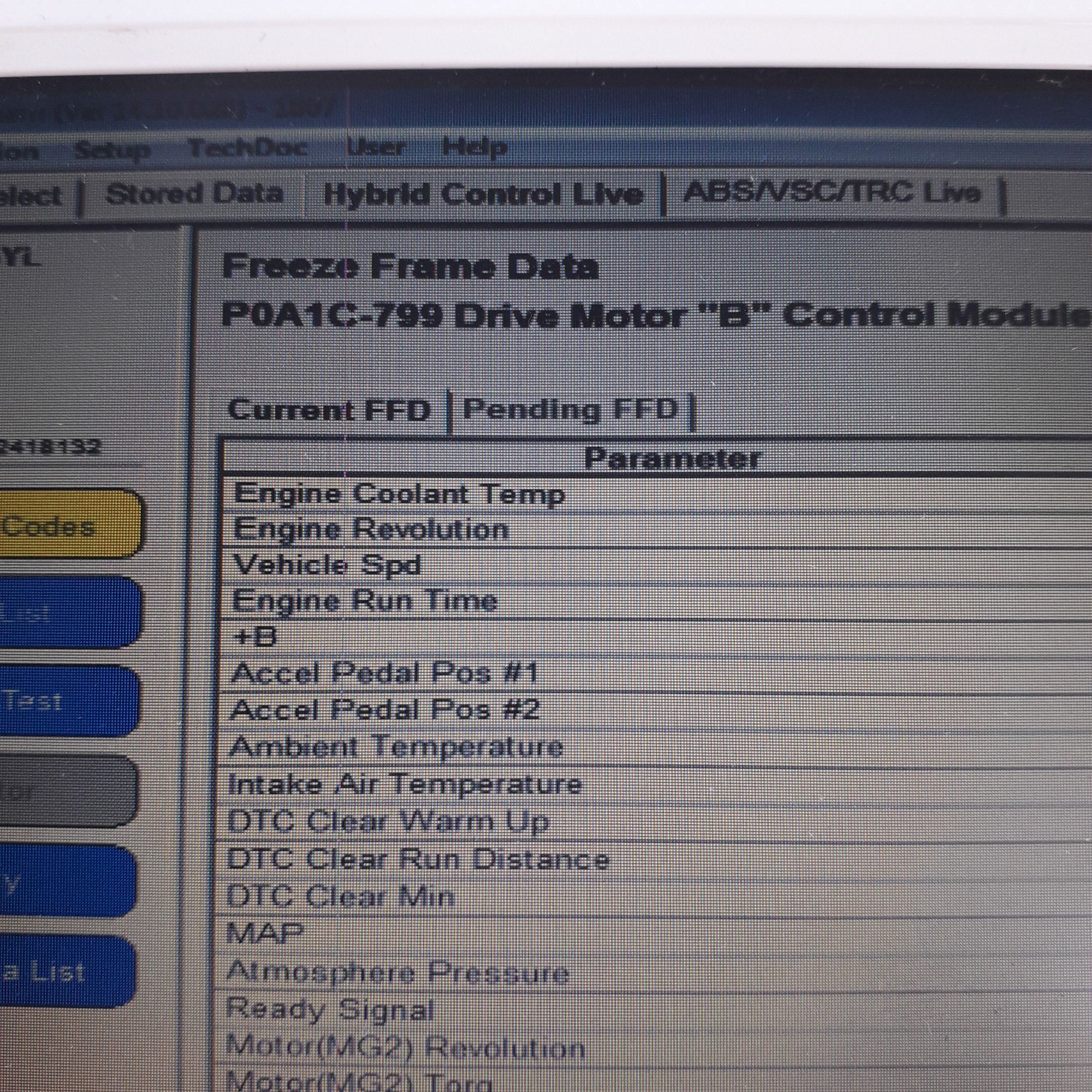

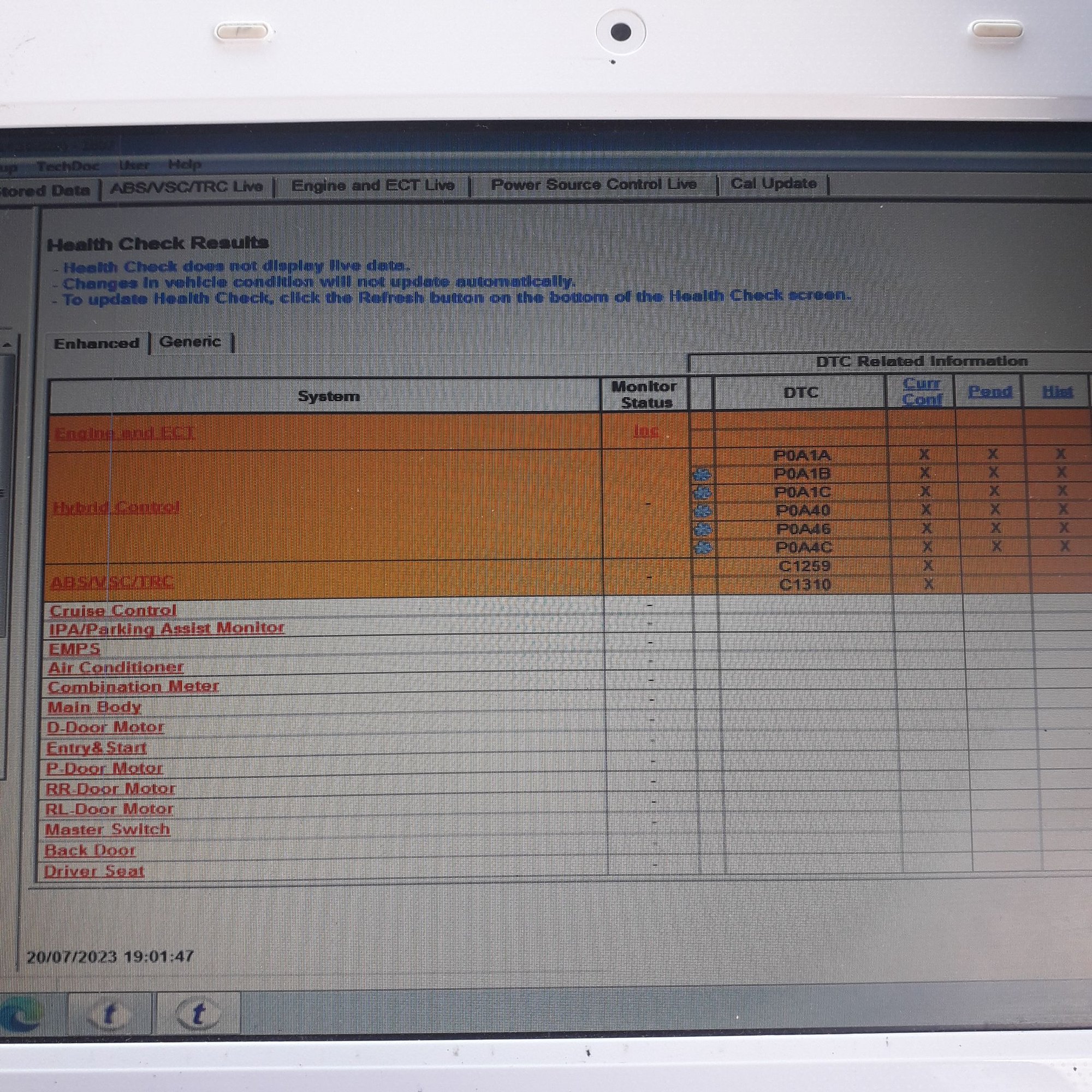

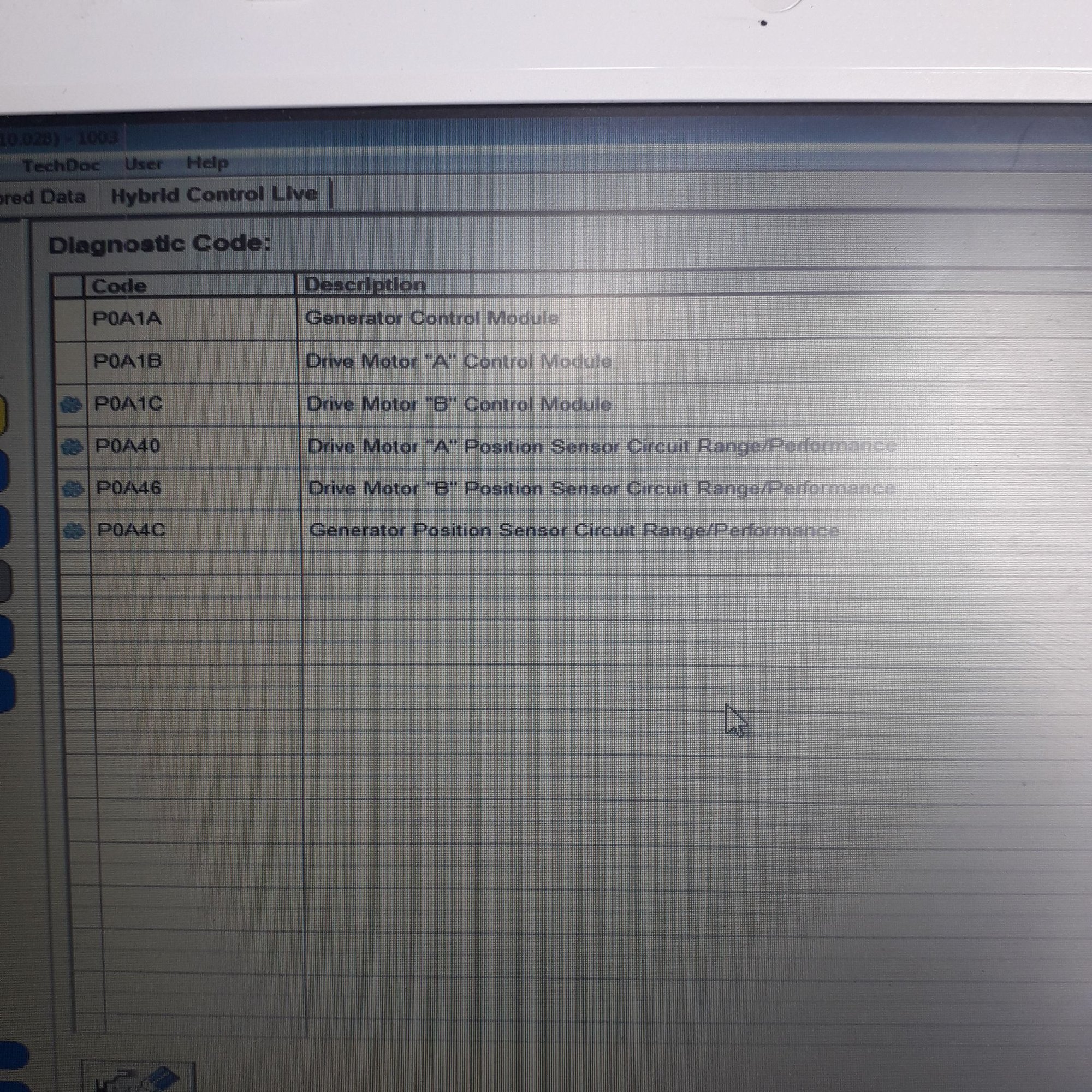

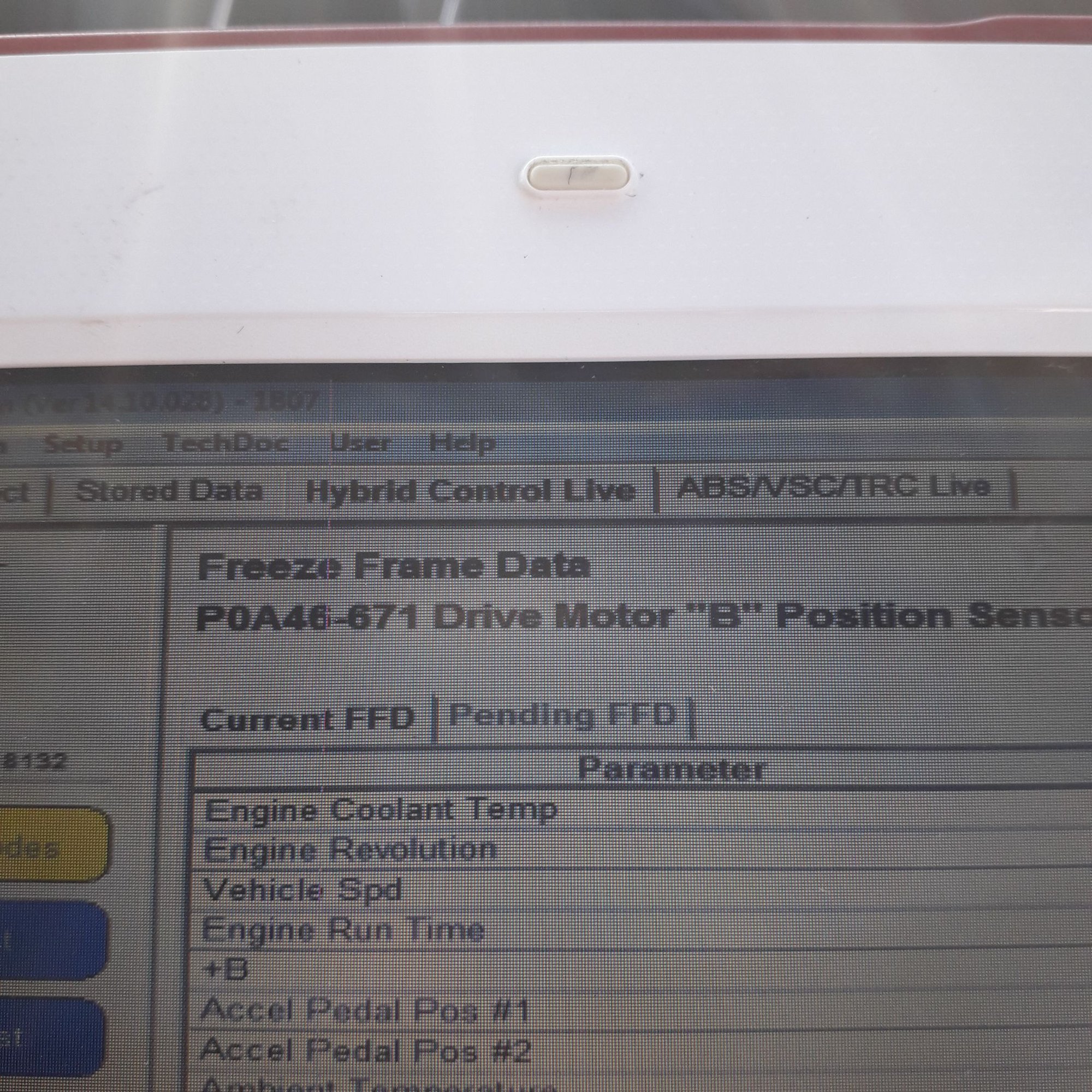

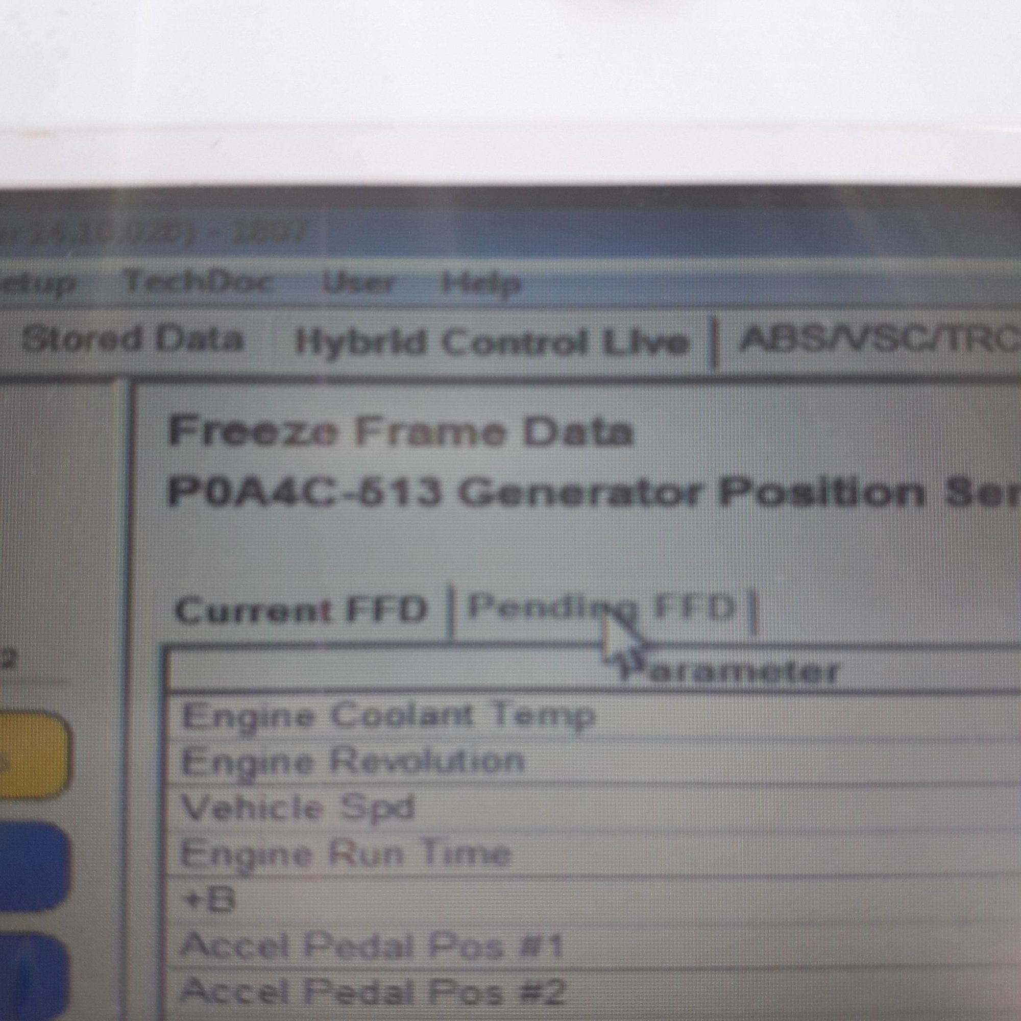

Hi All.
i have enjoed for a long time reading posts, i'm on .y third one now.
i've recently bought a dead rx450h, with the view of repairing it to keep it.
got techstream and other fault finding toys.
first set of codes were,
P0A1A no inf
P0A1B no inf
P0A1C 799
P0A40 500
P0A46 671
P0A4C 513
initially all pointed at the inverter,this was replaced with a working second hand unit. identical codes appeared (highly unlikelly assuming the inverter was faulty and a unit was sourced with identical internal faukts) this leads me to believe the replaced unit might have been ok.so more fault finding was done, following the repair menual. this lead me to the pcm (power control module) also replaced, no luck; last update the traction battery is arround 29% charge, low to start the ice.i am begining to think the battery condition might be an issue,at the beginning of my journey i did ooen the top of the battet
ry to inspect the junction box for water ingress damage, it looked ok and put back together!now feel that the issue is in other areas. reaching out for experience and or opinions. thanks in advance

Hi Ianex,
Thanks for sharing.
it looks like there is another page judging by the description.
do you have access to the inf codes that go along side the ISO diagnostics code?
the errors are the same at least what its shown of the picture.
will you be able to share the rest of the dtc description. i will capture what i have and share!
glad to collaborate to see if we have identical issue and can find the resolution!
one thing i have seen in the crankshaft angle oscillates, this suggests there is electrical noise ground, i have put an oscilloscope on the crankshaft signal, resolver signals both motor gen at front and the one at back........they all share similar electrical noise..........did your car just died on you?
Thanks for sharing.
