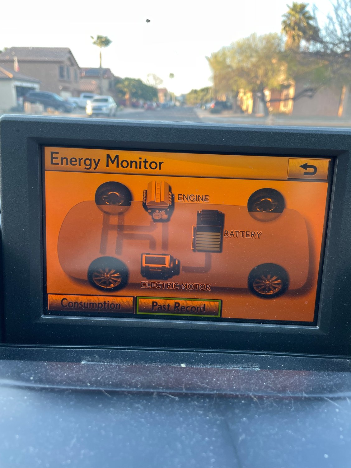

Hello there,
I just recently had the error come up on my 2010 Lexus HS 250H that said “Check Hybrid System”, as soon as that happened the check engine light came on, as well as the (!) warning. And some others. I will post some pictures below that show all the different warning signs that I am getting.
Anyhow, when this happened I went into my energy consumption screen and it showed that there was no arrows, and from what I read in the owners manual this means that there is no energy flow happening. But there is still “juice” in the battery according to the energy consumption screen. I will post a picture of this too.
So my question is, does anybody have any clues to what this means? Or any “easy fixes” or “cheap fixes” to get me back up and running. I know that a lot of the time the issue is the hybrid battery, but I had my hybrid battery replaced about 4 years ago (no longer under warranty) and I would like to not have to do that again. Especially because I would have to spend $2,000+ to get a new hybrid battery and the car is probably barely worth that now. LOL!
Could the issue possibly be a bad 12V battery? Or some sort of fuse blown? I have read as much as possible but haven’t been able to find to much about it unfortunately. ANY help would be greatly appreciated.
Thanks again!
Jeff
Here are the warning lights and check hybrid system message I got.
This is the energy consumption screen.

You may need to get a hybrid shop to inspect your car. There are independent ones, including a national franchise. I linked one in Phoenix below.
How many miles are on it?
First get your 12 volt battery tested, or just replace it if it is the original. They do usually last 8 to 10 years, but when they fail, the low voltage can trigger all kinds of apparently random warning lights. Your only source is a Lexus dealer or maybe a Toyota dealer, although a Batteries Plus may have something. You need the right battery as it sits in the trunk area, behind a cover behind the rear passenger seat. There is not much room. Call the closest couple of dealers and give them the part number below. It is around $300!
Vehicle Battery
Part Number: 2880028100
https://parts.lexus.com/p/lexus_2010...880028100.html
If that does not help, you should find an independent hybrid shop as they can test your battery and replace individual cells. Usually a battery failure is just a few bad cells. Or something else broke but you probably need professional diagnosis.
Or your cooling fan system is clogged with dust etc making the battery run hot. Keeping that ductwork clean keeps the battery cooler. There is a vent at the base of the driver side rear seat foot area. You can pull out the rear seat cushions, I did this a few years ago. There are a couple of bolts/screws, then you can take the ductwork apart and clean it out, or at least check for dust as we do not have a filter like they put in newer Lexus/Toyota hybrids after they figured out this was a problem!
There are also shops called - Tucson Hybrids, Hybrid City, AZ Hybrid Repair, Arizona Hybrid cars, Phoenix Hybrid Batteries, etc in Tucson & Phoenix. They will be a better option than the dealer who will overcharge and oversell what is needed.
https://toyomotors.com/hybrid-repair-phoenix-arizona/

Thank you so much for the reply. There is about 260,000 miles on it. We had a bunch of work done on the car about 4 years ago to try to keep it running for another 200,000.
I am really hoping that it is one of the cheaper alternatives. But I will have the 12V battery tested to see if it needs to be replaced.
Thanks so much for your reply. I will update once I get some answers.
