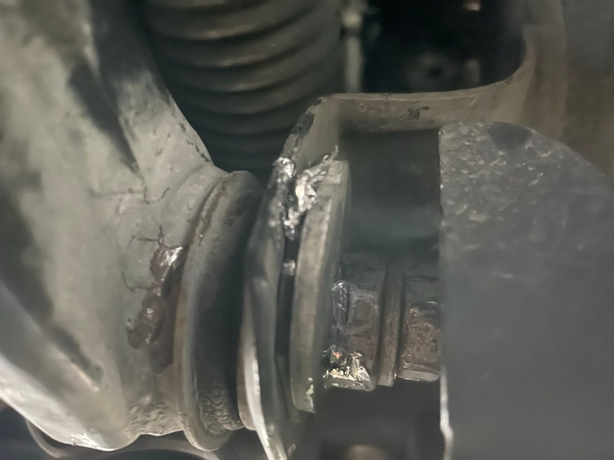

I recently bought new tires on my 2015 GX 460, car drove smooth and straight with new Michelin Defender tires. As a best practice, I had my car aligned and the alignment shop ended up causing damage to the lower control arm (LCA) bracket. The bracket was bent and the flange where the LCA eccentric bolts go into bracket (see attached) was stripped/flattened.
The alignment shop filed an insurance claim and I took to our local Park Place Lexus dealer to have it fixed. After multiple assessments, the cost to fix is in the $15-25k per the dealer. Majority of the cost is labor to remove entire engine, cab and other parts to replace the crossmember in which the LCA bracket is welded on.
Not sure what to do… Such a simple thing gone horribly wrong. Any body have a recommend frame shops that can weld on a new LCA bracket without having to remove half of the car in the Dallas, TX area? Please help!

I cannot fathom what the "technician" did ? ... used a prybar in an attempt to loosen the eccentric ? None of this makes any sense.
Get some more pictures while the metal is fresh and shiny ... once oxidation starts, they could claim the damage was existing.

The tire shop admitted fault and their insurance is covering the cost of repair. I had multiple years of tires, alignments, service history on the vehicle with them without issues. The location by my home closed last year due to covid and I had a 3-year alignment warranty and took it to a different location.
The tech at the different location was taking hours for the alignment. When asked was the cause of the delay, they said they had some issues. Come to find out, they spun the eccentric bolt without properly securing the nut on the other end because of clearance issues with the protective skid plate. You can’t even change the oil on the GX without removing the skid plate. As a result the flange that positions the eccentric bolt was completely flattened out. And to “fix” it they used a pry bar and other tools to try to bend back the flange resulting in bending the LCA bracket and destroying flange further (all without my knowledge or authorization).

The GX lower control arm setup is identical to the Toyota 4-Runner / Tacoma / FJ Cruiser. The eccentric is notorious for seizing up ... so those "in-the-know" slather antisieze compound on the eccentric bolt assembly before assembly to avert this future challenge. Unfortunately Toyota does not lubricate on original assembly. Any competent alignment shop understands this challenge and should soak with penetrant before attempting any adjustment. I do not see any sign of penetrant being applied in your pictures. Removing the skid plate takes less than 2-minutes ...
... so no excuse for incompetence in this case. The "technician" who did this needs to go back to their fast food job where they belong.

This may be a possible solution ... reinforcement that welds to the existing lower control arm bracket ... fits GX460 / FJ Cruiser / 4-Runner ... installing would be an actual improvement ... original tabs need to be ground off anyway to install these reinforcement plates ...
https://www.toyteclifts.com/59860-10...b-gussets.html
