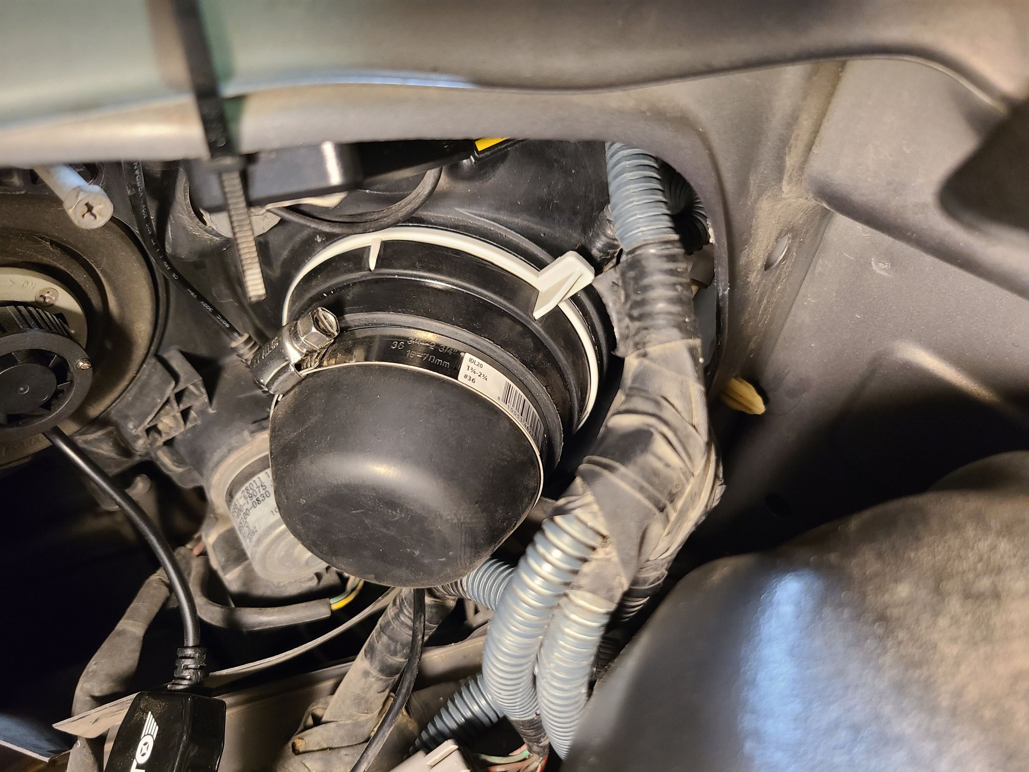

Quote: yes it can. there are hi output LEDs now that can run on the hid voltage, meaning no ballast wiring mods. Only thing is you need to add a rubber boot in place of the dust cap. i thought i did a writeup on this, maybe i didnt. i tried out 2 or 3 different bulbs and 2 different boots. works really well. better than both my ultinon bulbs and the oem bulbs. ill look for a thread here on this if not ill make a writeup
some good about this: less heat inside so less small cracking and less embrittlement. also less of certain radiation types so less damage to the inside.
ends up looking like this

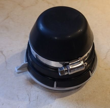

i couldnt find the write up on that conversion hid to led. but i will add some here until i have more time for a better explanation
parts are hose clamp, electrical conduit nut, pvc compression fitting and a boot. boot was from amazon and rest from hardware store.
cut a circle in the oem dust cover just smaller than the threads for the compression fitting, then thread in the compression fitting into the hole you cut. the pvc will cut threads into the dust cover. its better to start out with a smaller hole and try, then enlarge the hole if needed.
can also add some rtv once its assembled just to add a seal. the conduit nut fits over the threads to lock it all into place
cut the boot height to fit the aftermarket led, take into account that there needs to be a bit of extra room to not bind up the bulb and affect the light motors if you have them.
cut notches for the boot to fit over the dust cover ribs.
boot fits over compression fitting, other compression part not used
pretty sure the bulbs in the image are what i kept. i test oem and aftermarket bulbs and those at the time were the best overall.
no sealant needed on boot because the clamp seals that joint
