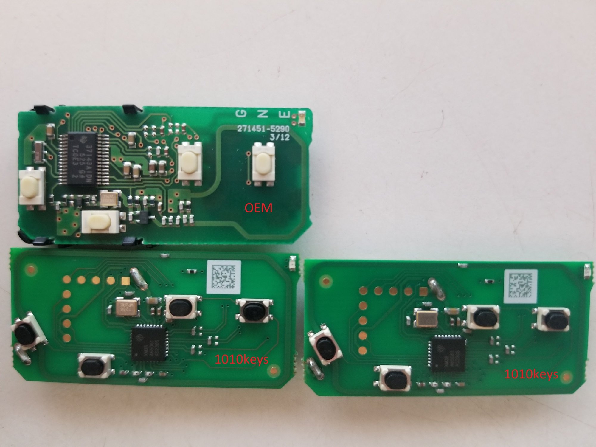

For the aftermarket FOBs, I bought (x2) REM Key Fobs with blades cut by 1010Keys on eBay. Link here. I sent pictures to 1010keys of both sides of my key blade, and he cut both of them for me. These FOBs look good, but the laser marking on the back is a bit different, and the boards inside appear different. See Pics.

    3. Touch and hold your new key in the area near the start button. (Note; you may need to move the key around a bit. Keep holding the key in this area for 30-60 seconds, as it may not immediately recognize. For the OEM key, you should hear a single beep from the car acknowledging it read the key. For the aftermarket keys I heard no beep, but got a program success in the next step after a couple tries. The hint is to keep holding the aftermarket key to your start/stop button until the XTOOL function times out... ~about 60 seconds.)
    4. You should get a "program success" message from the XTOOL D7. If you get a program fail indication, you may need to reattempt using the "OTHER KEY" or "XTOOL KEY" menus.
Hints: The spare OEM Key programmed easily and fast after touching it to the START/STOP Button. It was immediately recognized with a confirmation beep and Program Success message. The aftermarket keys initially did not look like it was going to work, but programmed successfully after holding them to the start/stop button for 60 seconds. I required 2 attempts for one of the aftermarket fobs. It appears you just need to re-try a bit with the aftermarket units.
In all, it took me about 30 minutes to program all (x3) new fobs, and they are working as expected. The aftermarket key blades click into the OEM fobs. The aftermarket Fobs come with a cut blade for about 1/2 of the price of just the transmitter from Lexus. (Admittedly at about 1/2 of the quality???) I am happy to have multiple spare keys programmed since I got this car used with only 1 key. The other functions of the XTOOL D7 seem good so far. I was able to get it to recognize 32 of the computers/systems in the GX460, and I was able to read TPMS data off of OBD2.
