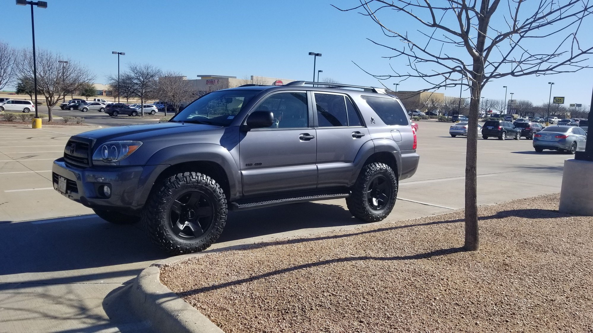

Howdy, I recently upgraded my 4th Gen 4Runner (2008 SR5 V8) to a 2021 GX 460. First order of business: improved tires. I have to give an incredibly massive thanks to @schwein for creating and organizing this thread. Using the photos and links in this thread, I was able to mitigate the risk of purchasing four new tires and not having them fit or producing excessive rub. Although I did not see any forum member citing a stock 2nd gen GX with 275/65/18 Nitto Ridge Grapplers, I was able to validate tire circumference being relatively close to the KO2 and went with it. They fit perfect; no rubbing at full lock (I did replace the lower, inner liner bolt).
I love my T4R, but WOW the GX is an excellent upgrade!
Haven't had the chance to get her washed; forgive the dirt and tire grease.

SURVIVOR619's Avatar
SURVIVOR619
5th Gear
Joined: Jun 2024
Posts: 5
Default Obligatory T4R Pic
Adding to the above
