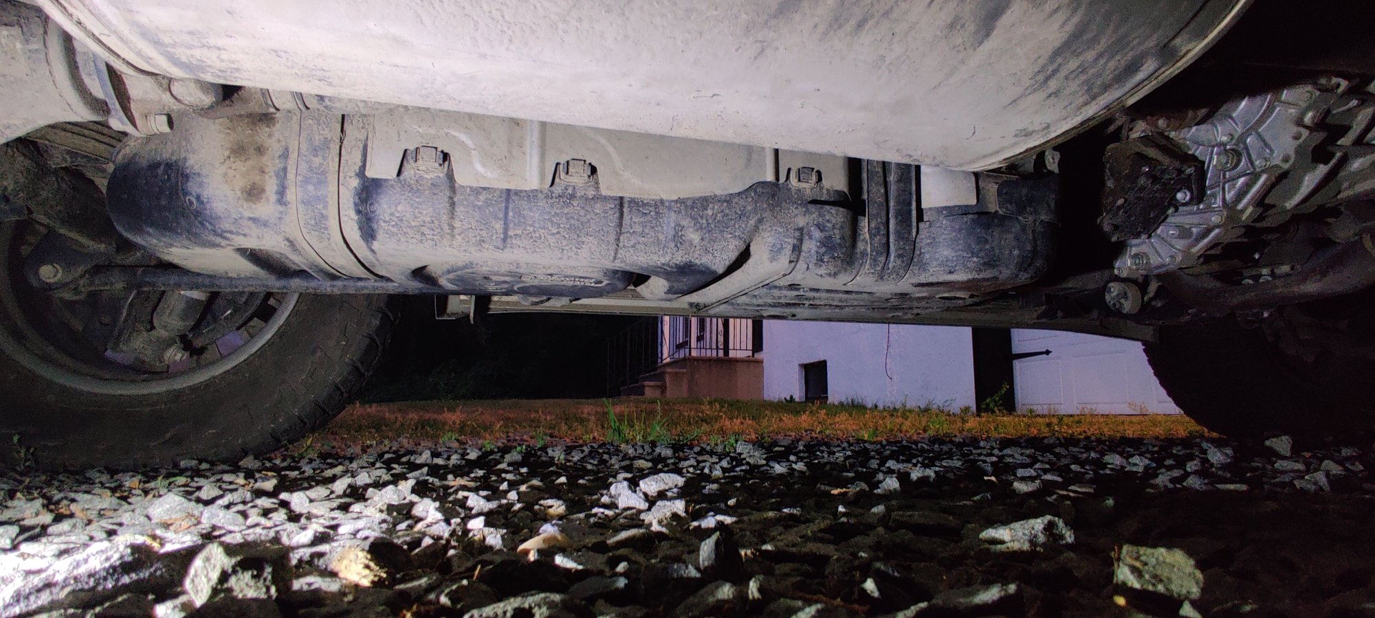

I was cleaning mud from under the vehicle with my pressure washer. Is there an OEM transmission skid plate? I don't see one but I thought the vehicle has one protecting the center.
I only see this.

No stock plate over that area. That is normal.

Trying to find a good underbody pic. I've seen one but can't remember where. Looks like former owner put on the full length 4R gas tank skid plate.
This is stock 10-20 gas tank skid minus the '20 Luxury w/off-road package.

There are two factory skids. The one your drop for the oil filter and second one has the small door in it to access oil drain on the pan. The transmission pan and transfer case are exposed.

Looks like you're missing the rear most skid. The rear most factory skid should have a plastic kicker attached to it that covers the front part of the tranny... gas tank skid looks OEM. Check my ownership thread for the difference

I'm seeing stock skids on the front there with nothing missing. Only anomaly I see is that gas tank skid which for US models ...full length didn't come stock.

Nothing looks missing from front oem skid package... if you have the full length gas tank skid (cant tell) that's a good thing imo.

nuclearn8... you are right.. it looked full length to me but it is just the partial. For some reason it looked full length to me
