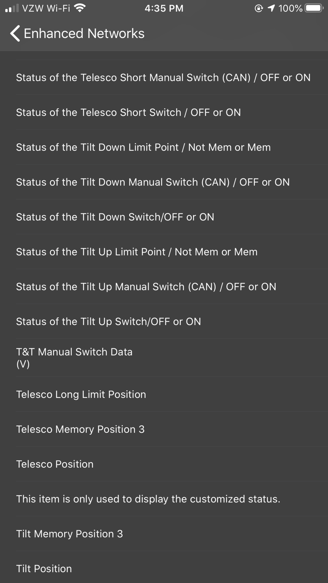

If it isn't the motor/gear itself here is a troubleshoot grid from FSM. I need to see if OBD Fusion/Link pulls this ECU for codes. It might... you could diagnose with TS as well.

Apr 27, 2020 | 04:40 PM
If you don't have TS... OBD Fusion/Link can see the ECU and while it does find these PIDs they may not all be available.
