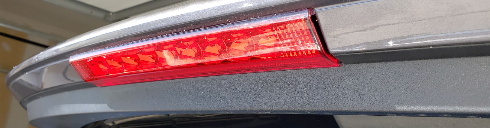

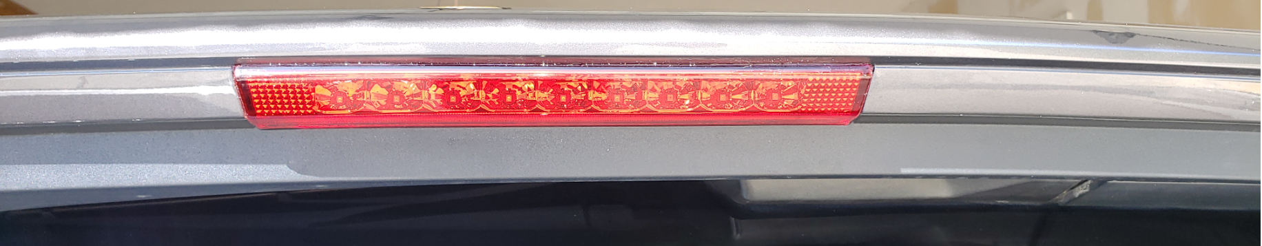

Update -
Thanks @Acrad for the instruction but after spending 30 mins messing around trying to take the rear end apart I gave up. I worried that I might cause more harms than good so I stopped. With the new brakes rotors and pads I replaced recently I need to flush the brake fluids anyway so I let the dealer replace the light for me for $130 (with $44 part I bought on ebay) + $150 for the brake flush.
Left view
Right view
Full on
