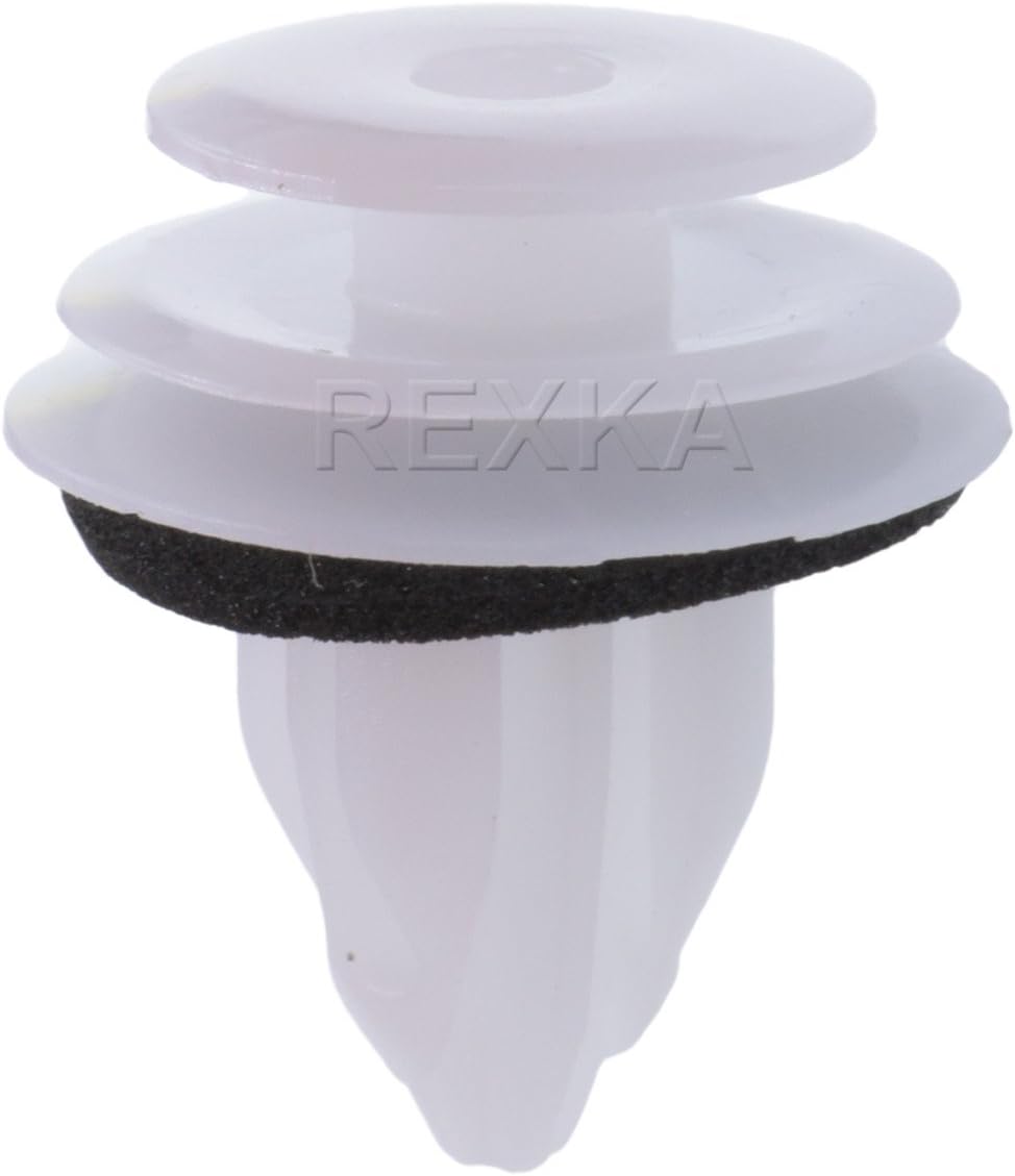

The trim for the top of the door has to come out first. Those are just held in by clips.
The access covers on the lower part of the door has to come out. Remove the tool kit, its just extra weight. On the other access panel, there is a bolt that holds the panel in.
There are a bunch of clips that hold the door. There might be another screw, I totally forgot to be honest, but just start from one side and work your way to the other.

If you have one of those plastic trim removers (flat piece of plastic to wedge behind the trim) it can be helpful, otherwise find a corner (away from the bolt locations) where you can get a decent grip and start to pry your fingers behind it. Pull away gently and firmly. Eventually the first one will pop free, and it's pretty easy from there. If you break one or two of the clips - no big deal. The dealer will have them for cheap.

• The trim pieces on the side of the popup window are removed inward and not back toward you. I snapped off one of the brackets inside of this mid piece but it seemed to pop back into a place mid trim. It doesn't seem to be harmed
• Those center trim pieces around window have some plastic retainers in the door that the part snaps into. I'd personally recommend pulling those out with some needle nose pliers and putting on the trim when you put those parts back on. Why? I ended up pushing one into the door frame. I got to take the rear panel off twice...fortunately it had just fallen to the bottom of the door.

taking off the trim from the rear door is very easy, you start with the top center piece, pulling straight towards you. then the side pieces pulling them towards the rear glass. then the bottom black trim, theres in a screw hidden under the handle used to pull the door to you from the interior, and a bolt in the compartment next to the tool kit. then you just pull towards you.

part numbers for the rear door trim pieces
https://partsouq.com/en/catalog/genu...&uid=339797&q=
i bought these from amazon just in case i broke some, great quality. cant even tell the difference from oem.
90467-A0005 90467-A0005
67771-58010 67771-58010
(probably broke one of these flimsy bastards, really wished they used the same ones as above. theyre a lot stronger and sturdy)
