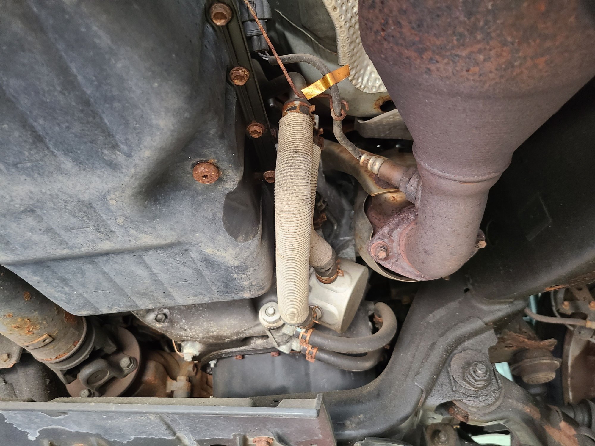

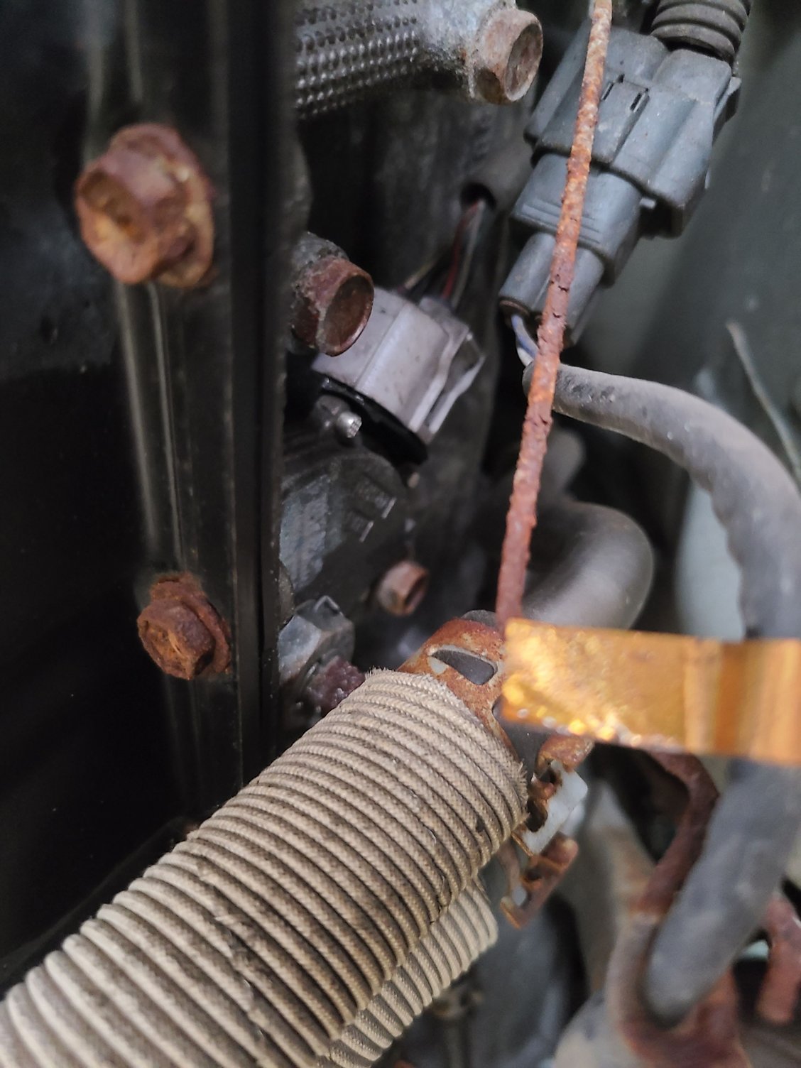

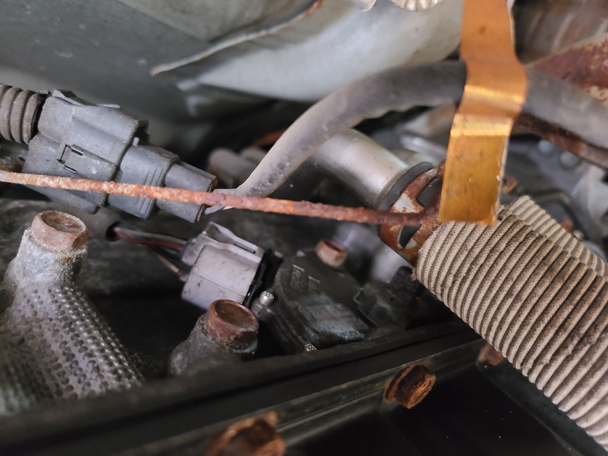

Replacing the Park Neutral Switch makes rowing the shifter feel like a brand new transmission.
I got the newer part number.
It's small, light and weighs like nothing.
It's located on the passenger side/right hand side of the transmission
Old and new. Forewarning. It's not easier to take remove completely and cleanly. It's very time consuming.
The aluminum piece breaks/seizes and is very difficult to remove cleanly.
Extra grease please.
Just gotta really grease it to prolong it even further.

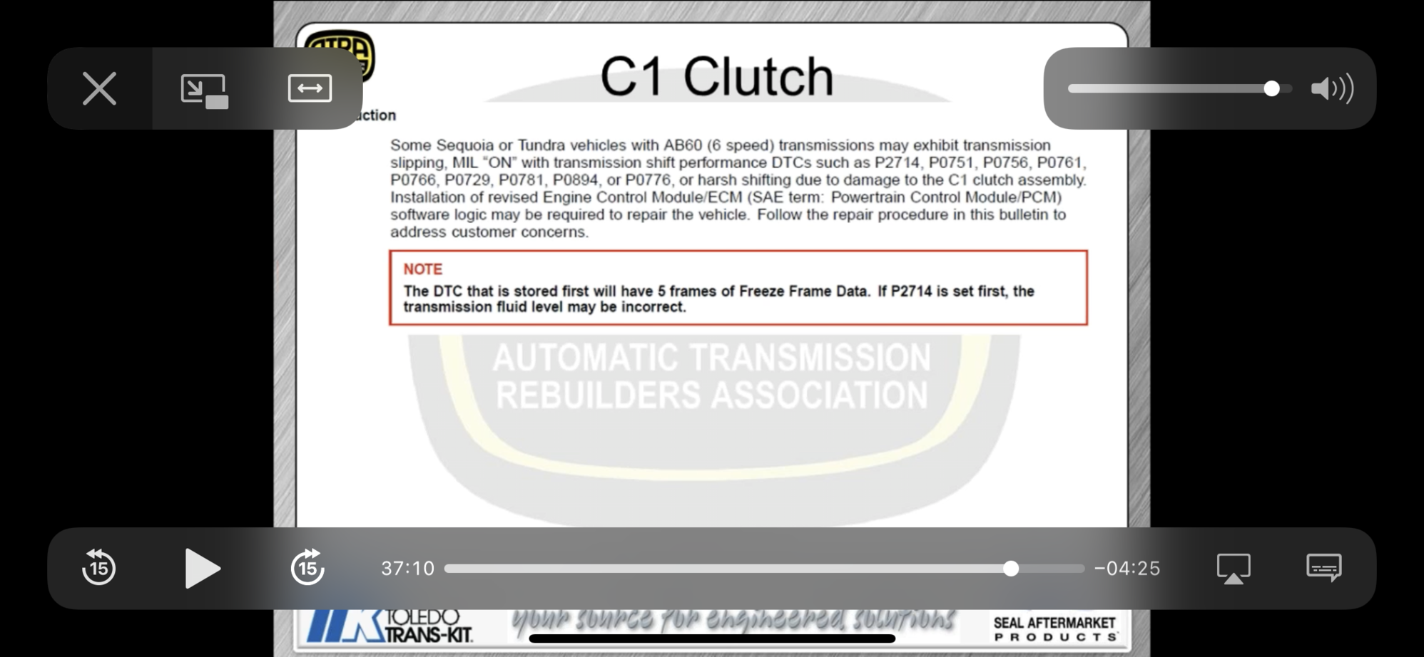

FWIW, I was doing some random browsing this evening and stumbled across a video lecture from a few years ago about the A750, 760, and 761 transmissions. It is very detailed and mostly over my head, but while the presenter was covering common issues, the following caught my eye about error code P2714. I took a screenshot so you can see where in the video this is and listen to the gentleman speak on it. I know he speaks of Sequoia and Tundra during this moment, but as he states multiple times throughout the video, many of these issues span across all the vehicles that use these transmissions. End of day though, all that may be required is an updated calibration (ie no real damage). I don’t know what it takes to update the calibration, so don’t ask me! Video link below. I hope this proves helpful to someone.

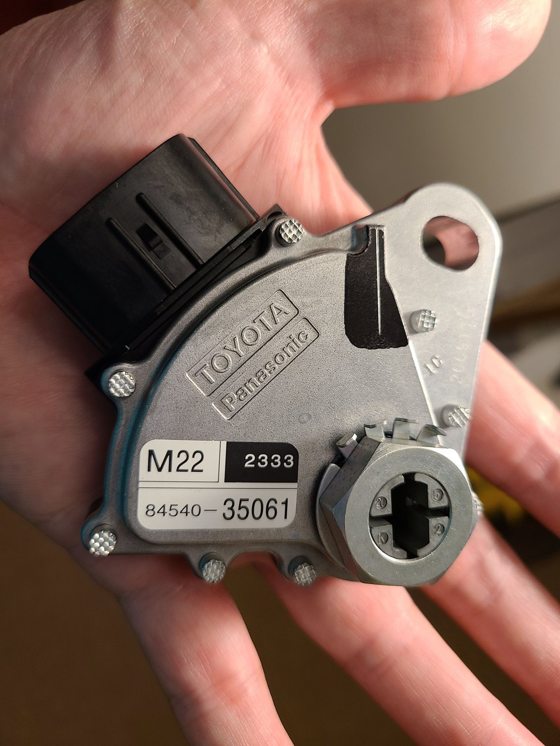

I had the same issue and shifting through the gears would be very stiff-Common problem. It is the neutral/park switch and it’s located on the exterior of the transmission. Part is reasonable like $100 but removing the old assembly is difficult in that it will likely be corroded. The part is has grease stuffed inside and eventually dries out and blocks the signal contacts indicating the correct gear status, which eventually pulls a code. Search the site for this problem and it will guide you through install.

Is the manual these directions come from available? If so, where/how? I have code P0705 [Transmission Range Sensor Circuit (PRNDL)], but in addition the shifter lever doesn't feel right, like there is some hangup with the cable or linkage.
Originally Posted by Acrad
Sounds like park/neutral switch at around $100
PN: 8454035060
I think it just bolts onto the outside of the transmission
