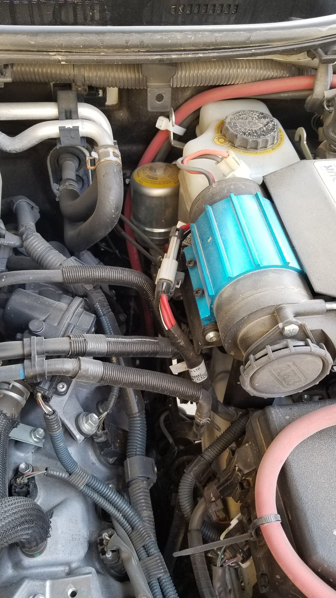

Here are some photos of where I ran the Positive and Negative cables into.
I have several photos that are posted from being panned out so you know what you're looking at and then zooming in a little more on each shot.
Note: I still need to goop the rest of that seal up with a bunch of silicone just to ensure it stays water tight. Not so much for submersion, but for all the muck (moisture and grime) that gets kicked up driving.
This is from my rear bumper looking forward. If you look carefully just to the right of the left coil sprint, you can see the black and red cables:
This is zoomed in a little more
This last photo shows exactly where the body panel plug is located and how I hacked out the center for the two cables.
I used very heavy duty cable ties (zip ties) and ran the cables right next to my left rock slider, above all the mounts and into the engine bay. Running into the engine bay, I kept it as close to the master cylinder and my ARB air compressor as possible to avoid as much heat as possible from the exhaust manifold and engine.
The following pic's are of my engine bay and how I have the cabling run in there:
Again a panned out photo for reference:
And a zoomed in pic:

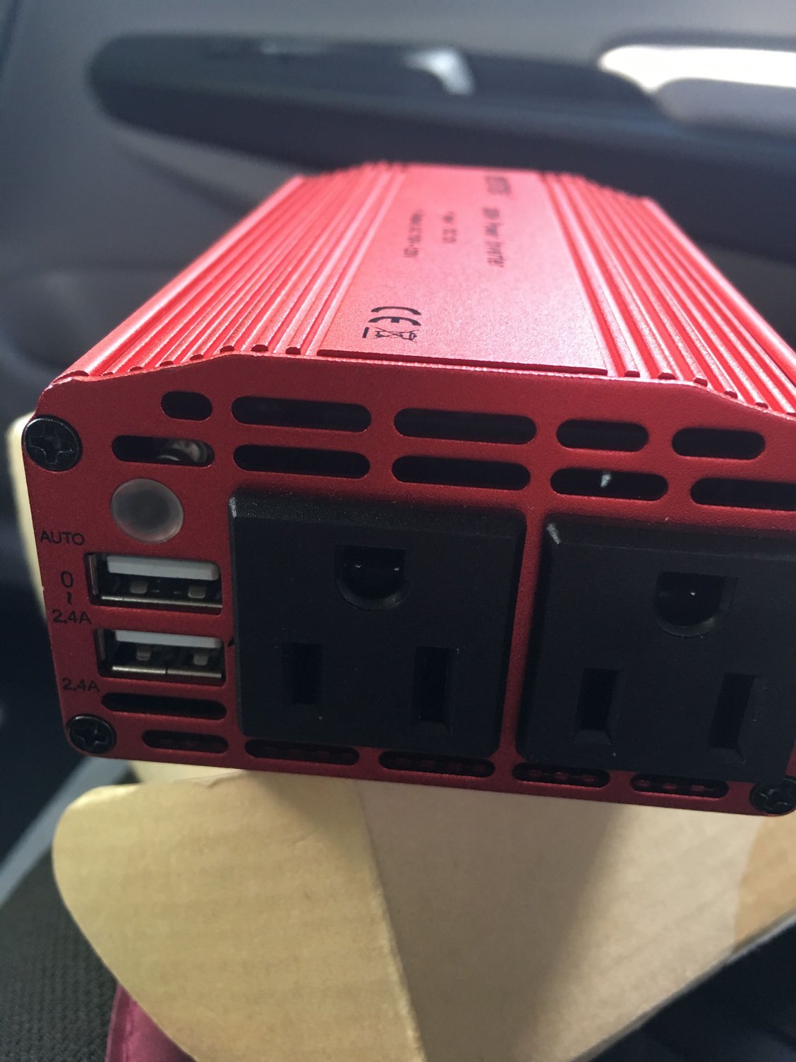

There are three things missing from the GX that other areas have.
The 400 W power outlet
The cool box
The fourth camera.
It might just be too cumbersome to add the factory inverter. I found this online and it seems much better and more affordable than the factory inverter.
Bestek inverter
I use it in my personal car and it plugs into the cigarette lighter. It’s about $25-$30.
This is a much better solution than trying to install the factory inverter and switch. You have two USB outlets and two full-size plugs. The sad thing is that we only have one cigarette lighter plug located at the center console.
The cool box
The fourth camera.
400w at ~12 volts is 30+ amps. You need to make sure the fuse and the wiring can handle it.

In short, I ran the 1/0 AWG from the rear forward. From the rear open cargo area with the rear seats down, I started the wire through the cubby where the factory bottle jack is kept (left rear). I then fed it under the rear seats and out through a port under the rear of the vehicle that has a rubber plug that is about 2" diameter.
*Note: I just added a photo to show from the bottom up where the wires come out of from inside. I forgot to add that photo when I was doing the original write up.
After pulling all the wire through that port, I snaked it up and over to my left rock slider. I fed it over the top of the (perpendicular to the slider) mounts that the slider attaches to the frame. This will keep it from ever sagging or ever being pinched in a off roading event. I then pulled up through the left side the engine bay, as close to the ARB compressor as possible to avoid any exhaust heat on the wires. And from there to the batteries!
That's about it.
Does that help?
