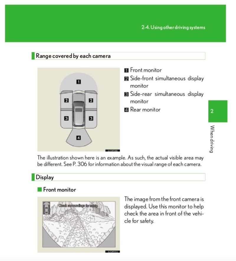

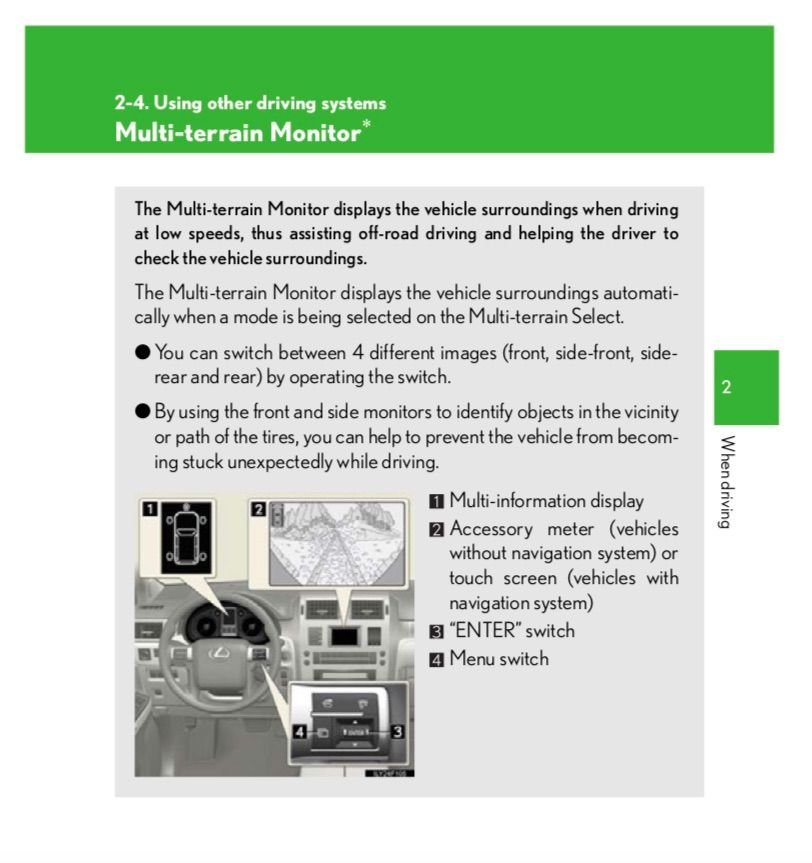

i have all these options and turned them on but never got the camera to function anything special i need to do
Did you enable the camera per manual? Here is some of the example, if you don't have the original manual, here is the link to download one: https://drivers.lexus.com/t3Portal/d...f/OM60G24U.pdf
Old Jul 1, 2018 | 04:04 PM
  #122
naser075's Avatar
naser075
Joined: Jul 2017
Posts: 80
From: quebec
love u man just got it to work thanks sooooo much
