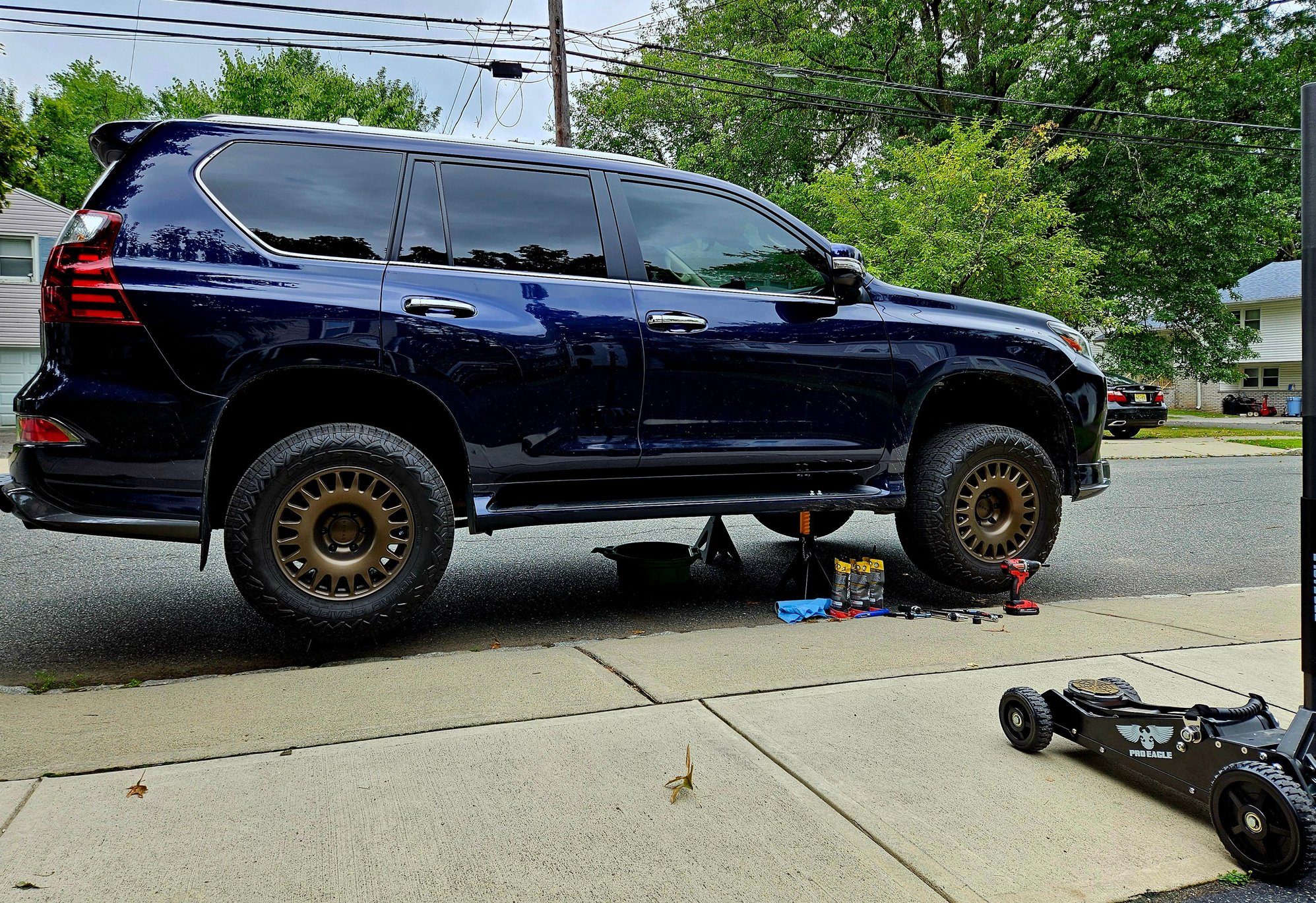

After reading through a thousand threads I decided to run Amsoil 75w90 in all three... diffs and transfer case. Even switched to 5w30 in the engine instead of that 0w20 spring water. It's been a long, hot summer of both highway miles and stop and go city traffic and I don't think I've noticed even a .xx reduction in fuel economy. I still might go Ravenol 75W for my next transfer case oil change because, well, the fear is out there....but I feel like everything's just fine with what I'm running.
