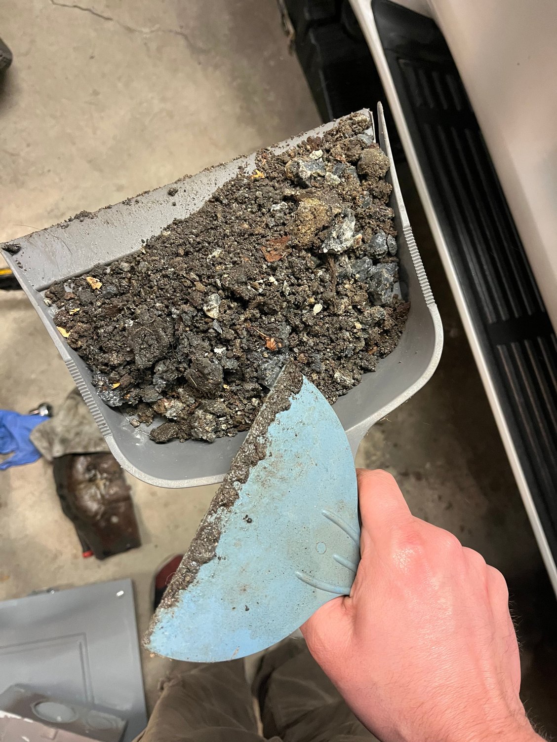

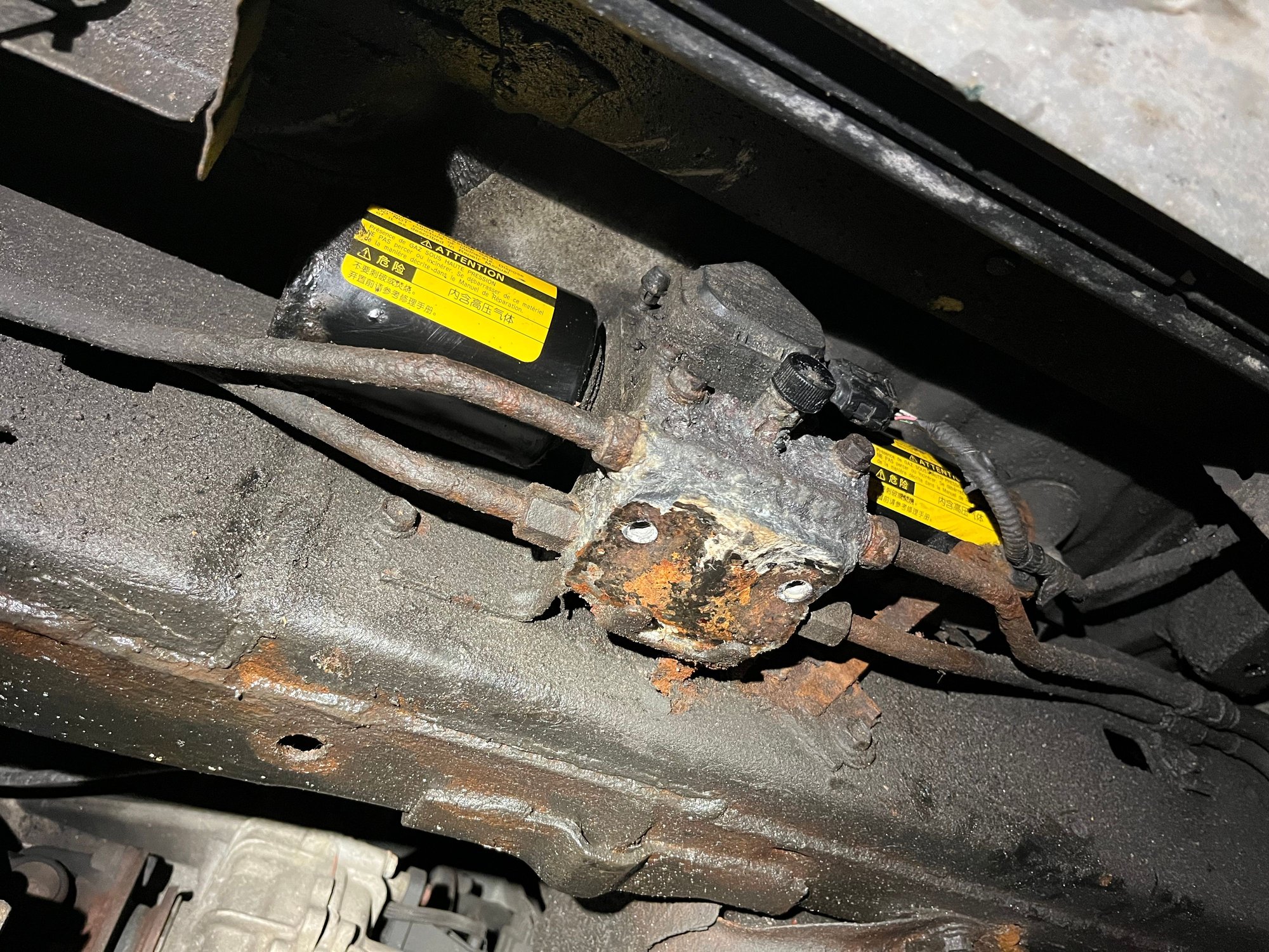

My 2010 GX has about 121k miles. I got it around 2019 with 65k miles. The vehicle has spent its whole life in western Pennsylvania. I was driving to work today and noticed that the KDSS light was on. I parked at work and when leaving at the end of the day the light was off for about 5 minutes after restarting then came back on. I did some research regarding issues and never knew that the accumulator cover was something to clean out. When I got home, I found the cover, removed the 2 12mm bolts and that thing was full of dirt and debris. I cleared away the gunk from the accumulator and also noticed dark gray fluid. Once I got it mostly cleaned off, i could see that the body of the accumulator was heavily corroded. I didnt pull codes but figuring this is my issue. I did not spend a lot of time cleaning up the 4 lines that go into the accumulator and not sure if they can be salvaged.
I looked through the main KDSS Info/Issues post and found the part number for the accumulator. I am not sure though what the part numbers for the lines are and how difficult those are to replace. I have a buddy that is a Toyota mechanic and Im sure he could refill and pressurize the system for me.

The one photo is how much gunk was stuck on top of that cover.

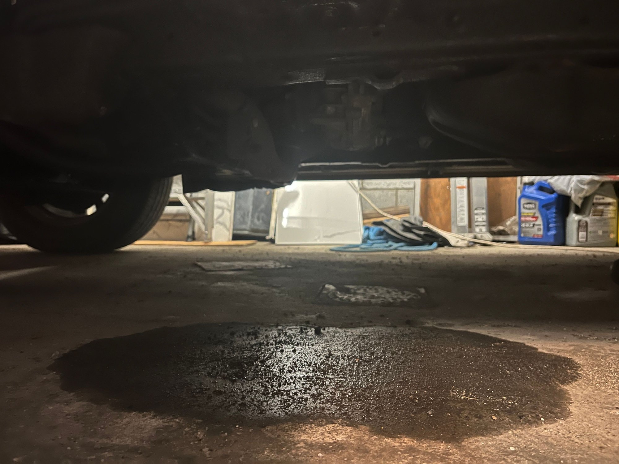

Confirmed this morning that fluid is leaking out of the accumulator. The metal body was eaten away. I have a puddle on the floor under the accumulator and the cover is wet. The pic I posted was after I scraped all the corrosion off, so that is why it didn’t look horrible. I’m going to have to try and clean up the 4 lines/connectors and see if I’m able to salvage those. Still not fully sure as to my best/most economical option.

once it repaired, buy a $8 can of fluid film, remove the shield twice a year, clean it and spray it with fluid film to prevent it from happening again. Cheapest insurance possible against a failure that costs thousands... I'll never understand why Lexus/Toyota placed the KDSS accumulator along the frame rail of all places. boggles my mind for a brand so focused on reliability and durability.
