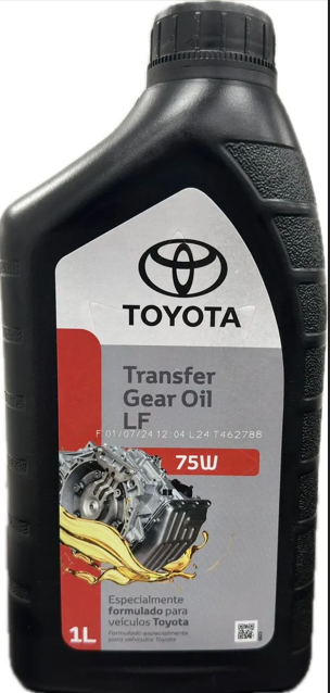

Originally Posted by Scott571GX
I believe I saw someplace (BITOG maybe?) that the Toyota Transfer Case Oil is no longer packaged in the old style can... it's now sold in a plastic bottle like practically ever other lubricant. That's why the part number has changed.
Interesting, I see a supersession part number 08885-81080 replacing the 08885-01806 which looks like this:

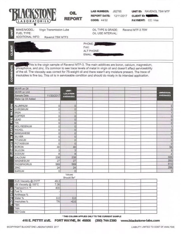

Originally Posted by BenCSVT
Red Line MT-LV is extremely close to the Toyota 75W Transfer Gear Oil, even the ester % is probably almost identical based on the virgin TAN numbers.
The Ravenol add pack is a little "light" compared to the Red Line & Toyota 75W oils.
After looking at this, and my sample below at 30K, and comparing to another sample found with 55K I am going to go ahead and change the fluid for the liquid gold. the T/C was underfilled by about 200ML. My numbers compare to one with 55K.
I think I will do a UOA on my current fill of Red Line MT-LV once I hit 30K miles on it.
It seems like these transfer cases through a ton of iron.
