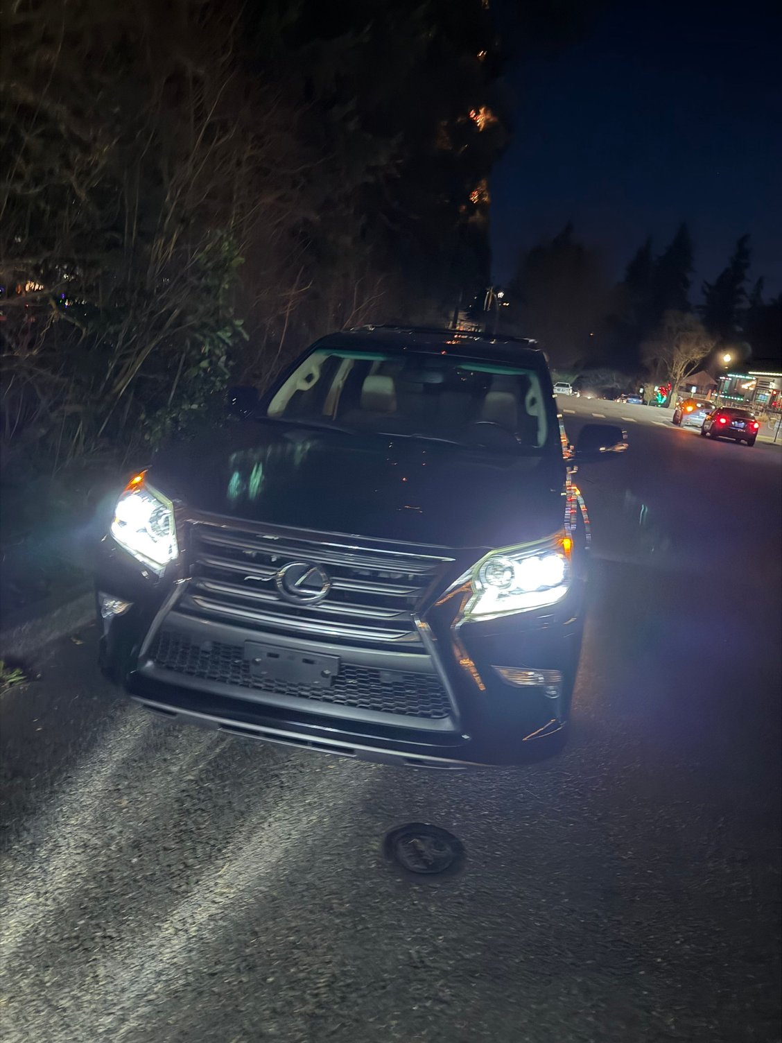

Just bought a 2015 GX460 premium with 55k miles on it. It’s spent its whole life in Oregon, so no rust. Previous owner took it to Lexus of Portland every 5-7k miles. I’ve attached the carfax. Super stoked on it, it’s awesome!! Open to suggestions on whether I should add a can of liqui-moly engine flush and do a fresh oil change. Last one was only 1k miles ago, but I want to be able to feel confident and thought it might be a good idea for me to have a “fresh slate” with the engine. Open to ideas!
thanks in advance,
grant
