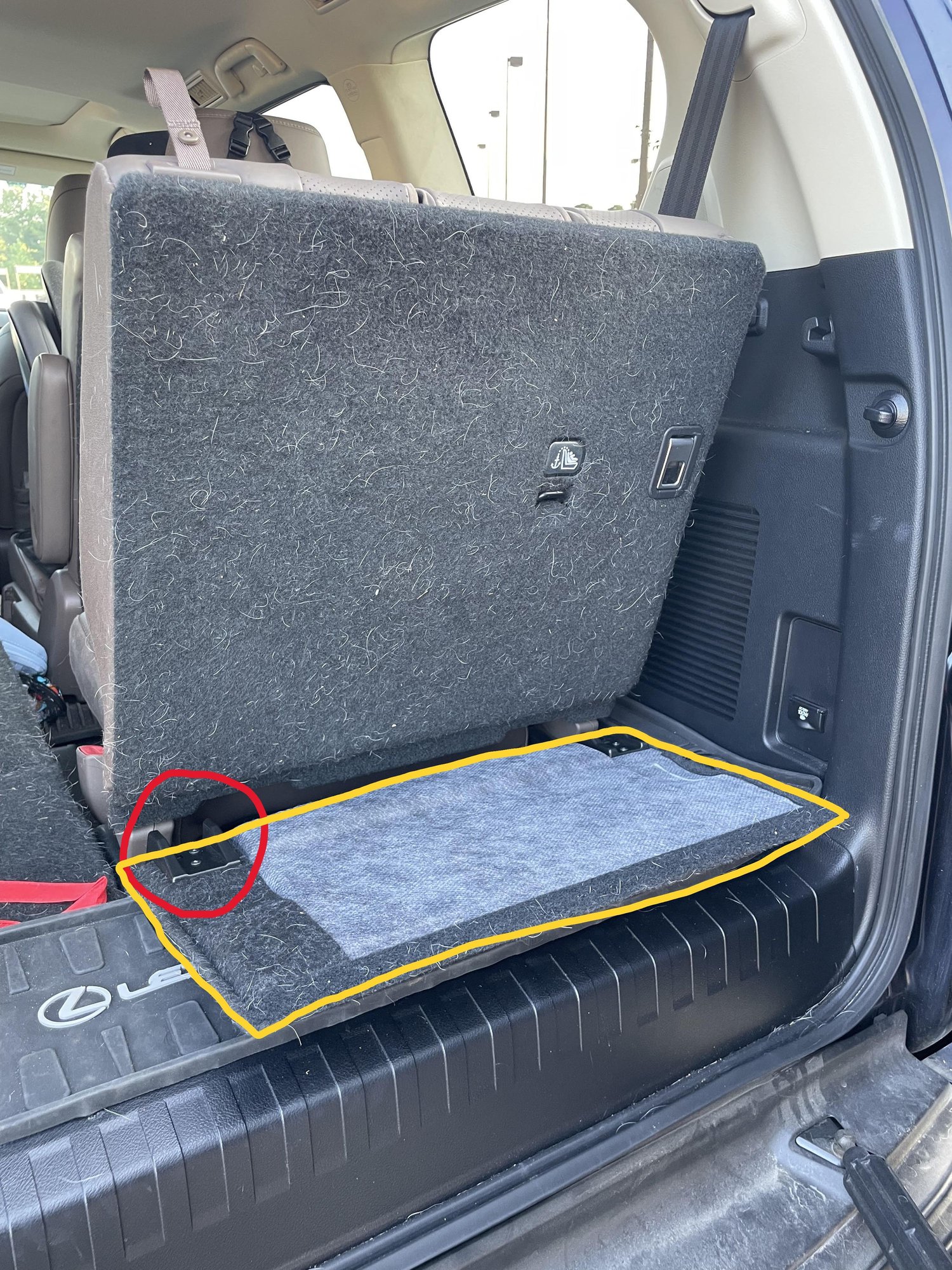

So I can't find this anywhere after looking through the parts diagrams and even contacting Bell Lexus. Thought someone might be able to help. There's a lower trim piece on the back of the 3rd row seats that folds down to cover the seat when they are laid down and maintains tension on the back of the seat with a spring mechanism when they are up. Basically forms part of the cargo floor when the seats are down. It has a little plastic hook that attaches to the spring to keep it taut on the seat. My wife took her vehicle to get detailed and they pulled on that thing and snapped the plastic hook. Trying to find a replacement and it isn't on the seat diagrams or the trim diagrams that I can find. Anyone dealt with this and know where I can find a replacement?
The black plastic circled in red is where the hook has snapped that attaches to the spring. I suspect I will have to buy the piece highlighted in yellow because the plastic has little rivets to connect it that I don't think I can pull. And yes, I know I need a cover for our dog issue. Working on that!

No, I don't think that's it. That piece looks much larger and there's no way this thing costs $500. The plastic hook is a terrible design. Might just have to drill through it and put a metal bar that attaches to the spring. It isn't visible, so I don't see much of a downside.

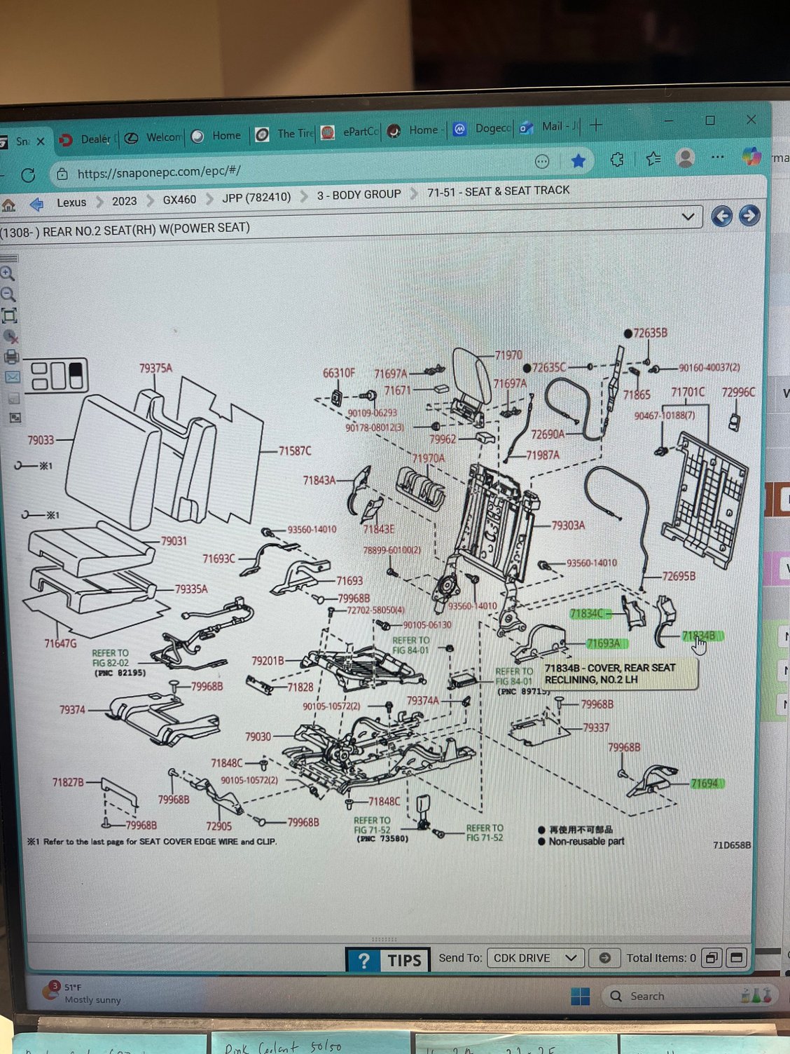

Look at this diagram the ones I have highlighted?? Lmk which one I’ll get you a part number and price
