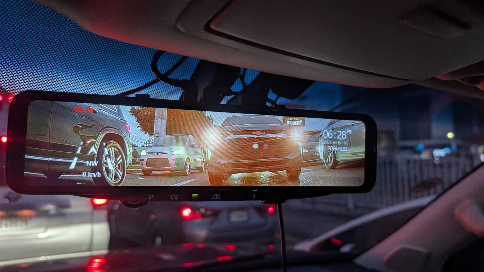

On my last vehicle I had a rear camera for my rear view mirror and I really liked it. Great visibility. I'm thinking about installing something similar on the GX.

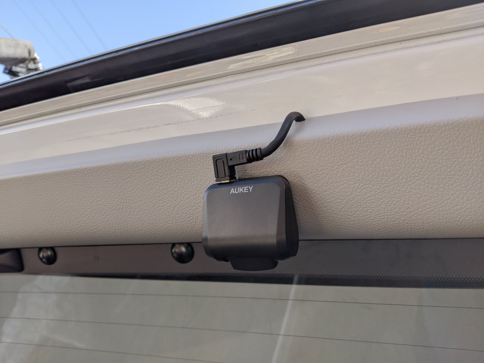

I also mounted it to the rear door inside.

One tip. I put my rear camera lens dead center in the rear of the truck....... If I did it again tomorrow, I would put it like 2 inches more toward the driver side. The rear wiper wipes that area better. I have a decent full view but just the edge of my video can have unwiped glass in it due to this centered placement and that little arc of window the wiper doesnt touch.

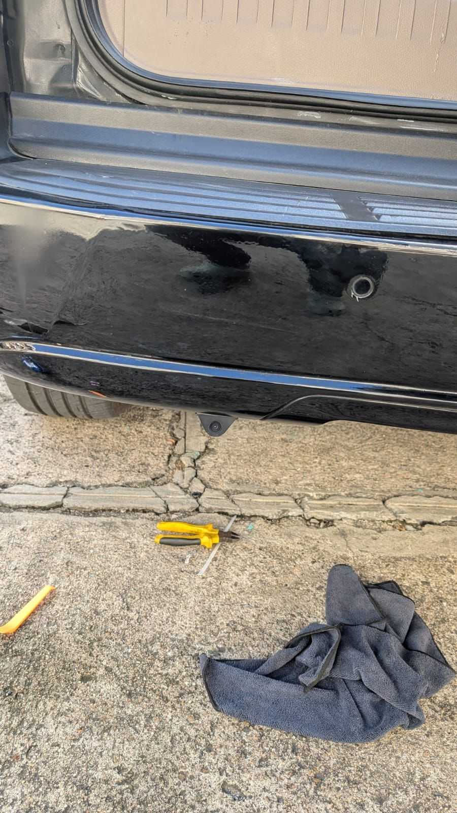

I have a Pormido D50 with 3 cameras, Front, Rear and Room. I installed the rear under the bumper, the camera is very sturdy construction, i put a 3M VHB and put a flex tape over it as a safety net and so far so good, no problems at all, tested under rain, camera lens is always clean and no problems at all.

I am looking at the PORMIDO PRD81T for a few reasons, but the main reason is that it is 11 inches and will fit when both visors are down.
