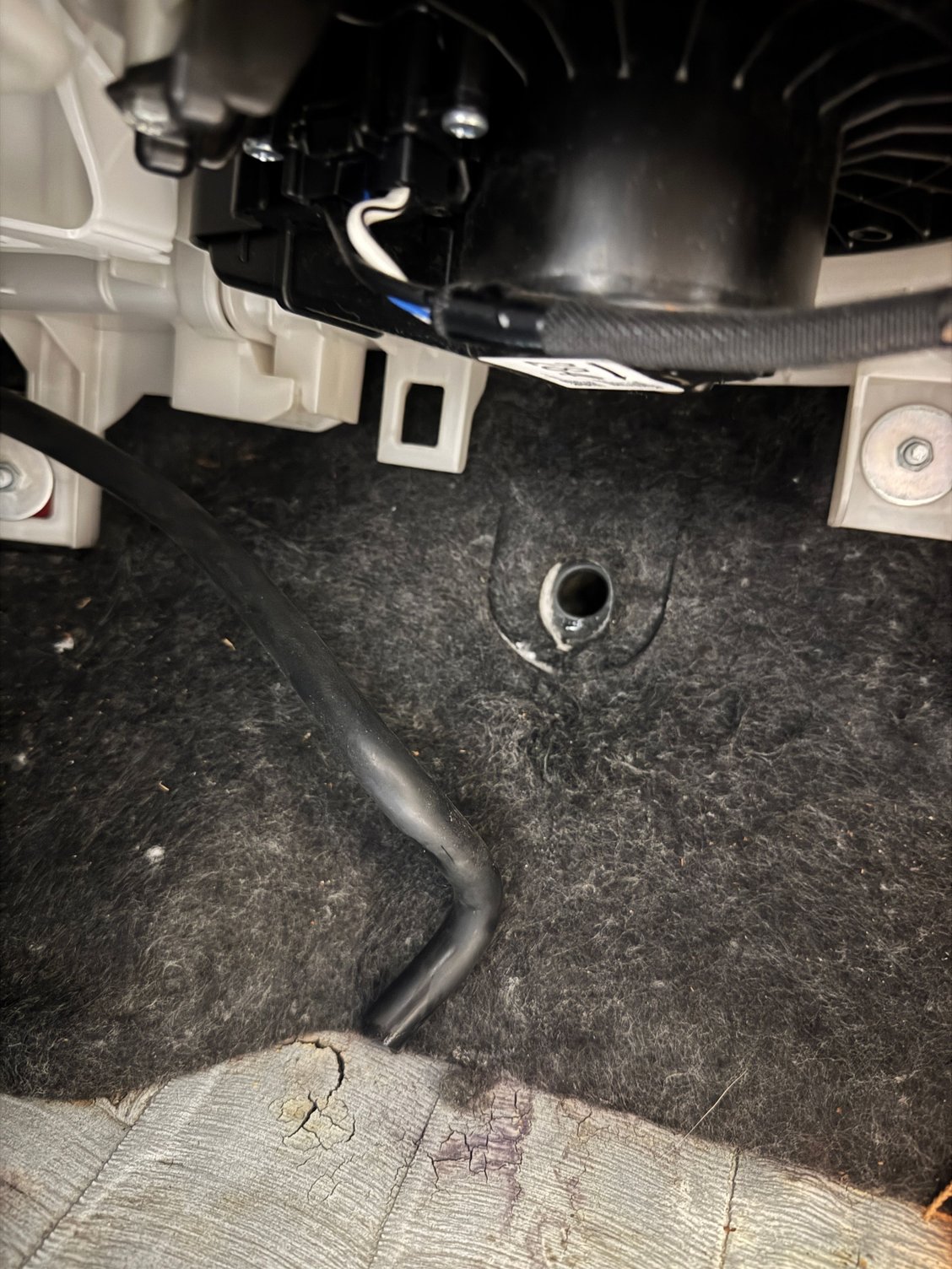

The AC drain hose appears to be the source of the leak. It was sitting in the firewall hole loosely and I could stick my finger through. While the hose itself is free and clear of obstructions, it appears my leak is outside rain water splashing in from the firewall. Hard to picture, but there are water stains coming from below the hose.
I ordered what appears to be the correct grommet 888993A010. As mine appears broken (see pictures).

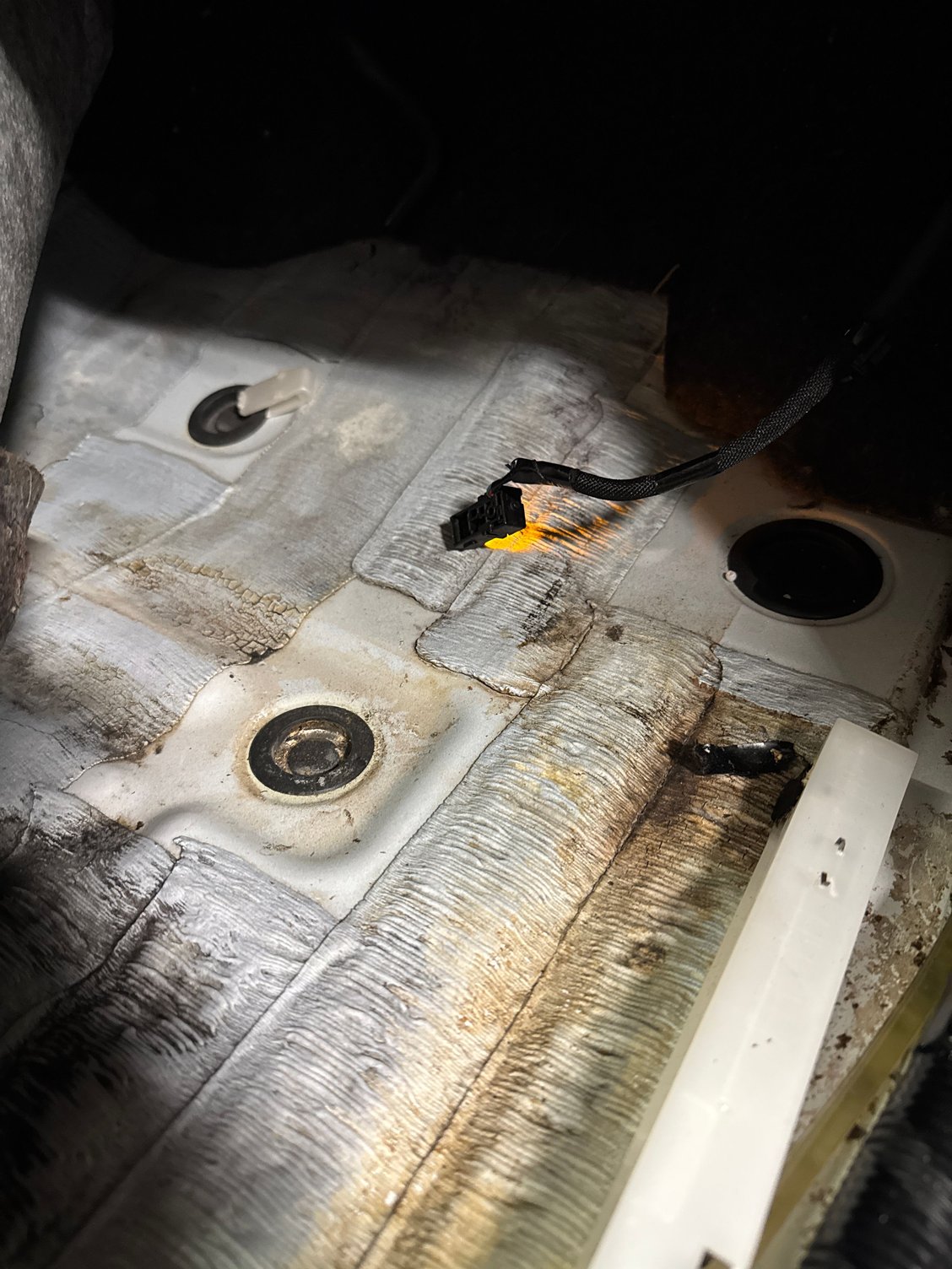

I removed AC hose to show there isn’t really a seal in here. It just fits loosely in the hole. Trail of water stains under felt, hard to photo.
Mildew on floor pans

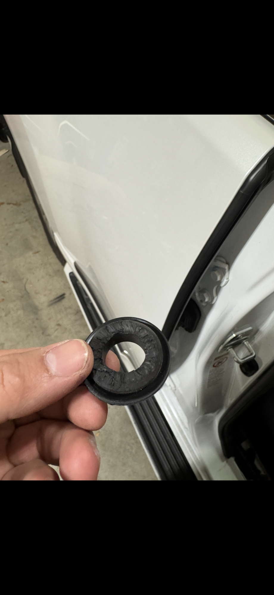

This was the grommet for the AC drain tube, does it look broken?

Looks like the grommet is damaged, so just replace it. AC hose should not be excessively loose.

Picture speaks for itself left new grommet right old

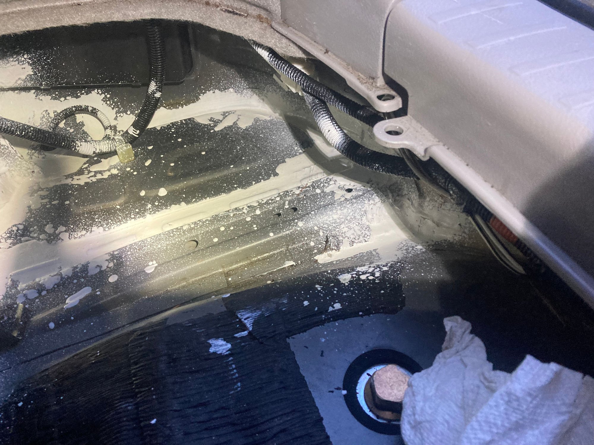

Water coming in the trunk area eventuall runs forward into the passenger foot wells. Straight shot from elevated trunk deck. Misled us a long while on the source of the leak. Check rear seams and drains. there are two drains that connect into hoses, one on each side just in front of the vent flap box (black plastic box either side).
ALso leaks come from the body seams in the rear. Ours leaked both sides from there.
Open up the back and see if it’s wet underneath.
White in this pic is liquid sealant and reinforced seams with, leaks came from hoses and body seams above.

Just to conclude this thread, the source of the water was the grommet. We drove the GX through a couple rainstorms on a road trip this weekend and everything stayed dry.
