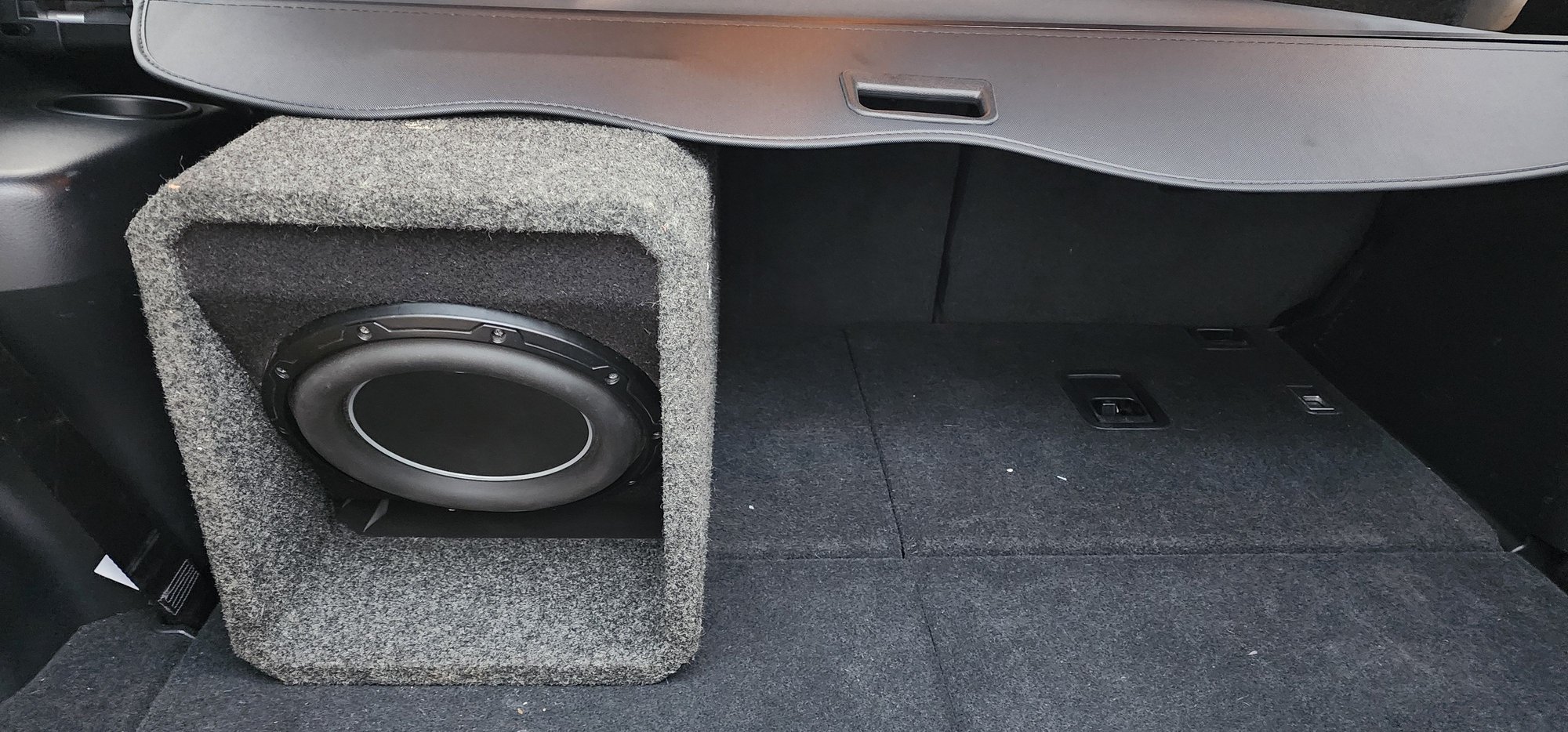

Ok everything is done now...
installer was super surprised on how powerful the amp was. Amp and line out converter are under driver seat.
I know the sub is upside down... I needed it on the left side incase my daughter wanted to sit in the back.and the outputs run on the left side.i have enough slack to move it to the right side if ever need. This set up hits hard and clean. I ran nothing but kicker subs in my ls430s before. They hit harder but dont sound as nice as jl audio

Originally Posted by droeck
I have this same sub / box in my '22 GX, and it hits hard for a 10". I've got mine running off a JL XD600. Good luck with the install....post pics when you're done.
pics of your set up?
