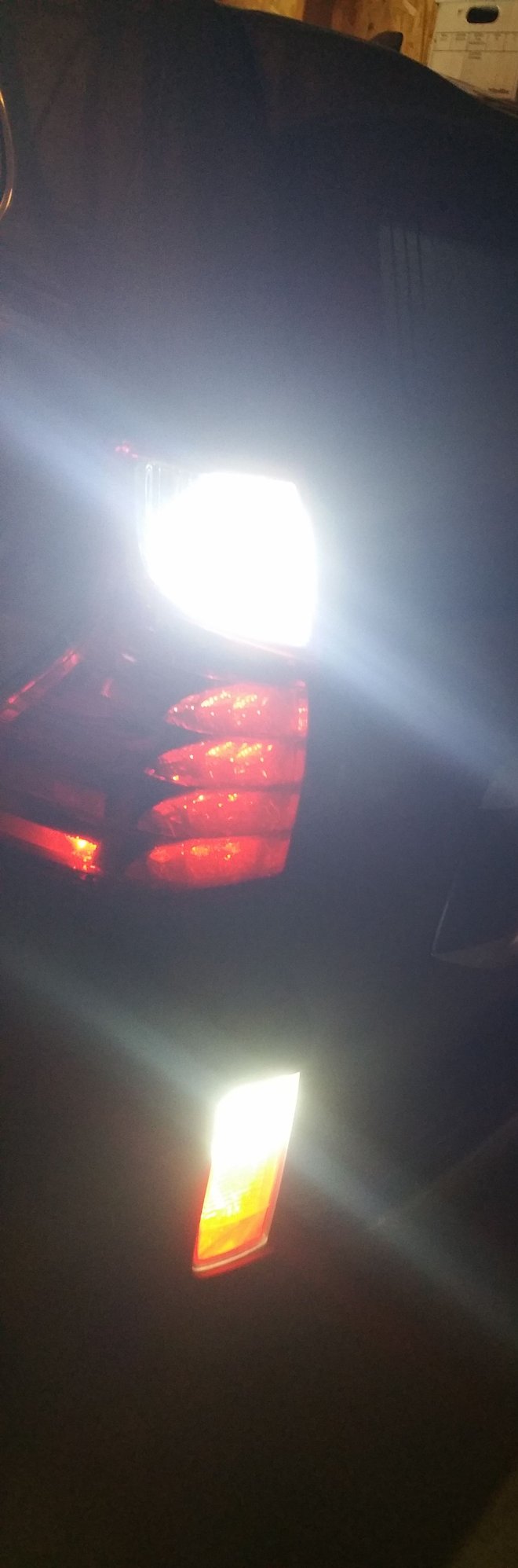

if you want brighter and also want to use the stock locations you can change the oem rev bulbs and then run a wire up to the turn signals, install a swicthback there.
will have a lot more light.

ends up looking like this
OK don't laugh... But what's a switchback and how would I install said switchback?
https://www.tacomaworld.com/threads/...#post-16158765
Decent info in this Tacoma thread.
