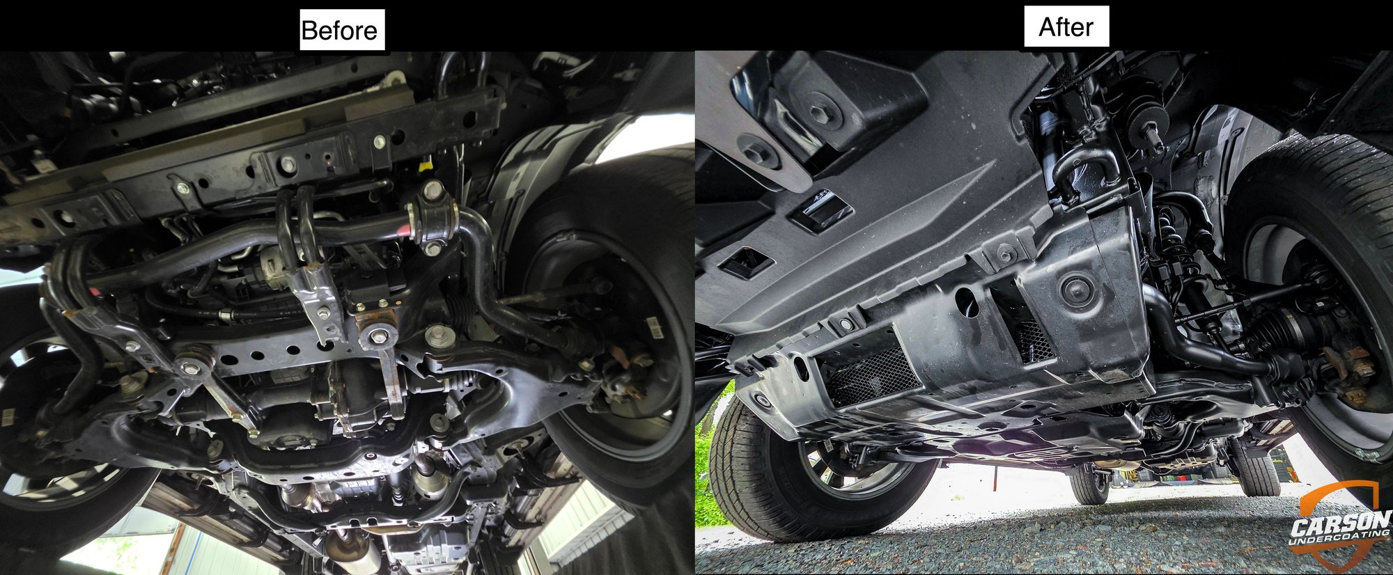

I went the FF + Cosmoline route on my new to me '23 Lux. Purchased in MD at Sheehy Lexus as a CPO with 14k miles. Had it done at Carson Undercoating which if you're in the St. Paul/Minneapolis area I highly recommend them. Dropped it off on a Sunday night and picked up Wednesday morning. Only one small FF drip all summer on the garage floor.
